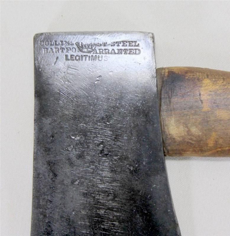

...I will say this, if those type of crowns indicate a counterfeit, both Abercrombie & Fitch and the David T Abercrombie Co. were either duped or involved in the shady dealings as the majority of the axes I have examined from both of those companies have these markings..
I'm referring to this type of crown (that I suspect is fake), with separate 3-sided triangular points, and a single line 'brim':
This A&F example (below, from another thread) doesn't seem to show the type of crown that I believe is a fake. Do you have any photos of A&F axes that do show the type of crown with separate, triangular points (as shown above)?
