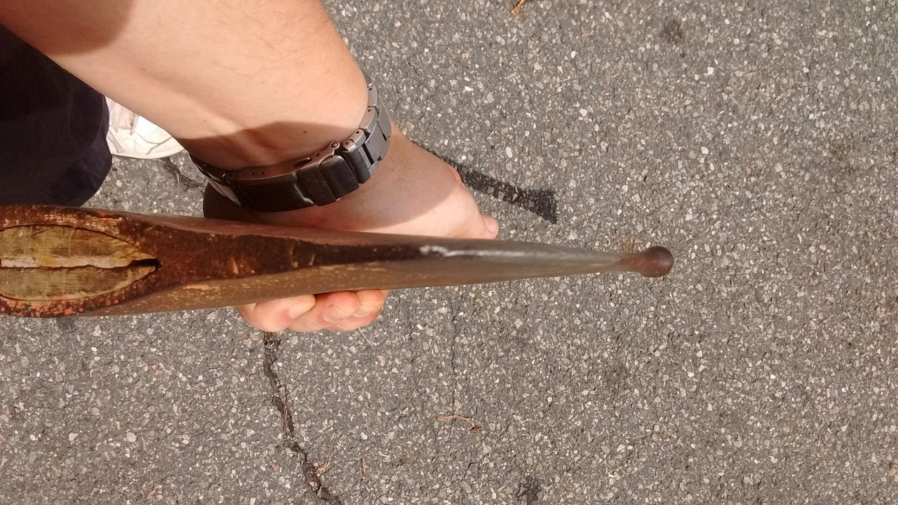

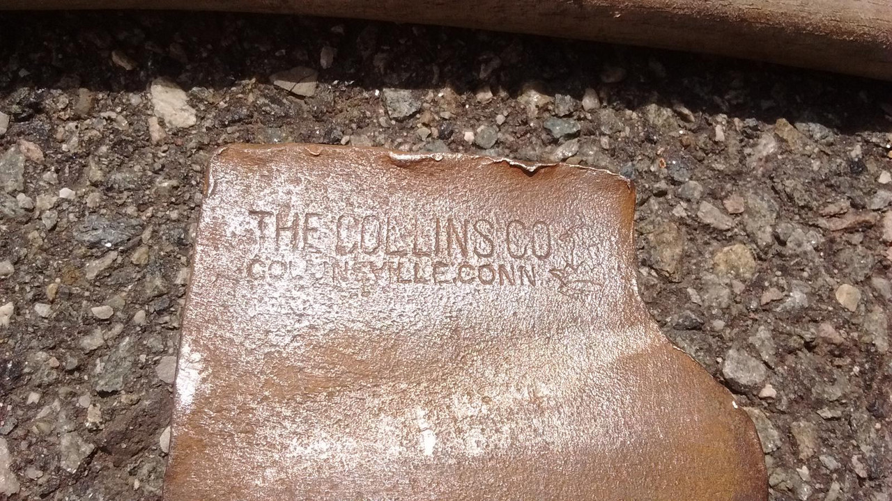

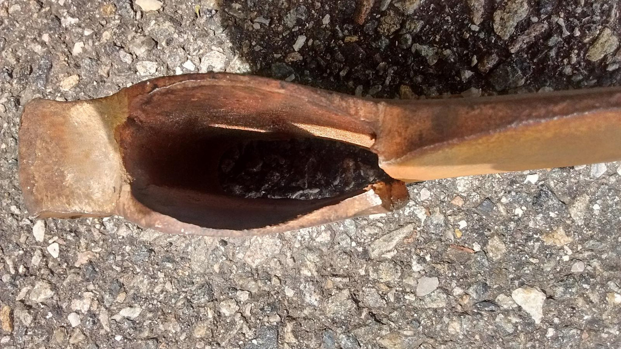

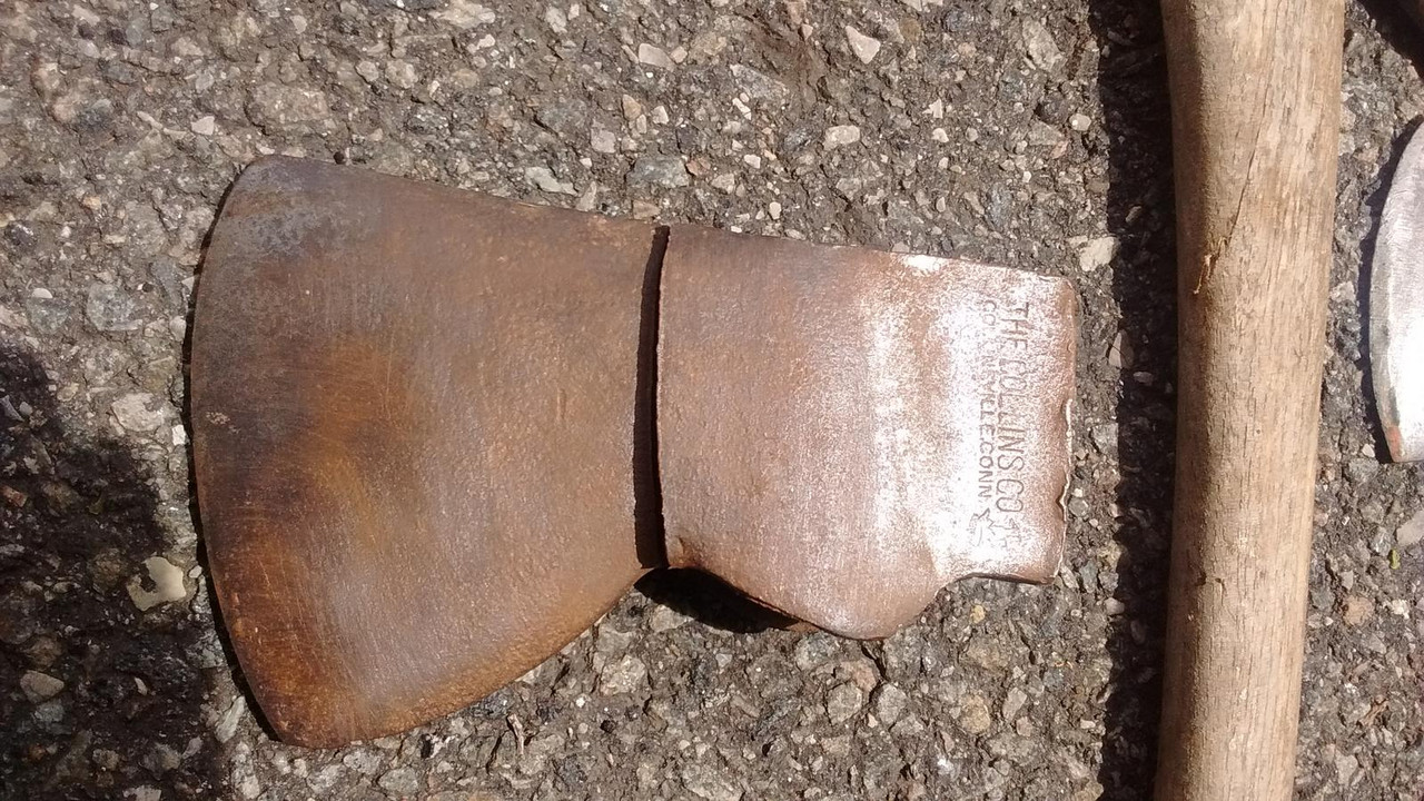

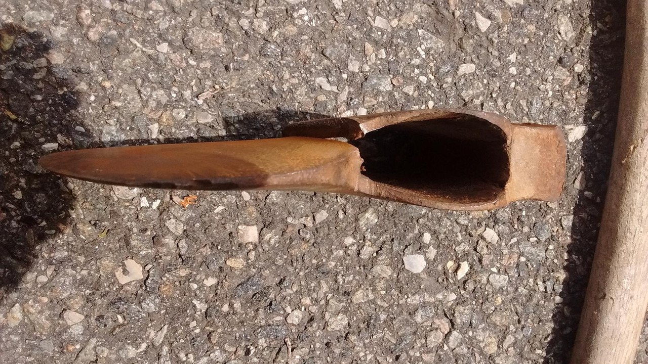

One hour ago I was sure I had 2 Illegitimuses: one that I acquired half a year ago and cracked Rockaway that followed me home last Saturday.

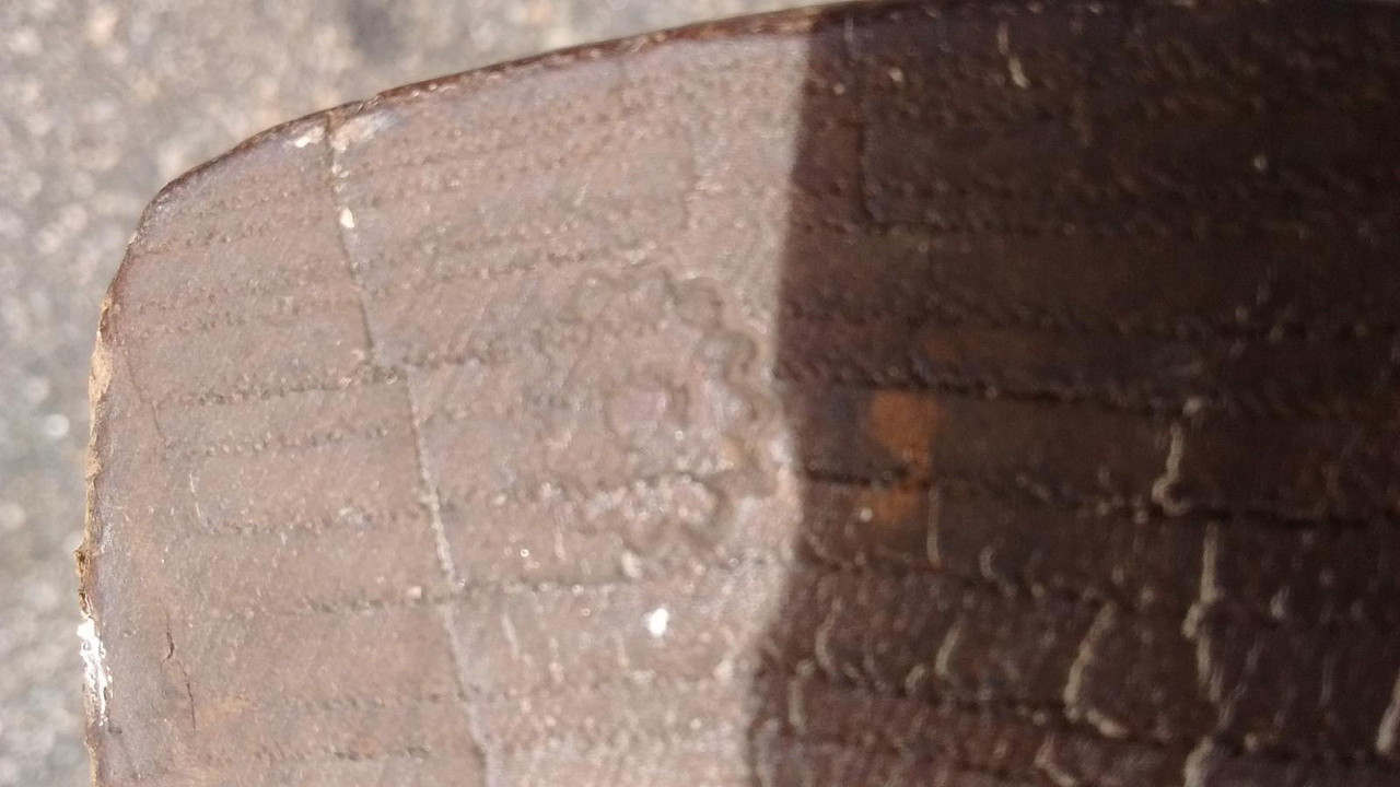

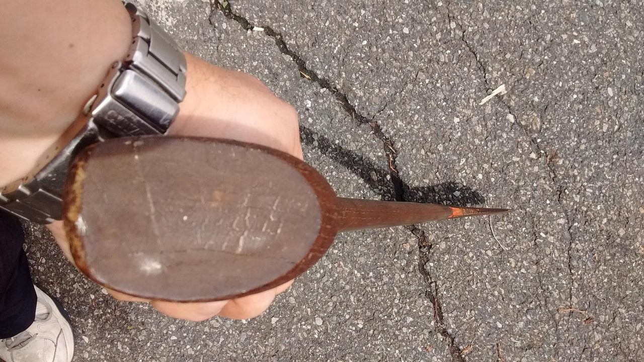

That axe has amazing handle for a illegitimus(some overstrike damage). It just feels right in my hand. In place of regular wood wedge there is metal plate( I believe the brass pin goes thru that metal wedge). Bottom of the handle is marked "c" inside corrugated circle.
I assumed that cracked head meant poor quality so it must be fake one.... a little bit of cleaning and....
I have never seen a vintage American axe that was hung so high above the shoulder at the factory. At the very least that is a replacement handle. But the "USA" stamped across the corner looks flat out hokey. But maybe it's legit and they did that for the export market or something.
The cracked Rockaway looks genuine. It just got left out in the weather with a rotten handle. The rotten wood wicked water which then froze, splitting the heck out of that eye.

The second one. Because of the layer of rust I could only decipher Legitimus mark. Current hot topic is Collins fakes so I was nicely surprised that it was actually a real thing. And yes, the uniform crack from top to bottom of the eye looks like frozen water was the culprit. I hope one day I will be able to weld it and hang it on the wall with McKinnon
