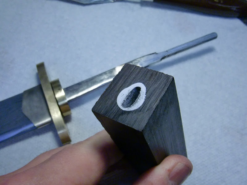

If I don't explain what I'm doing in the pics as they're posted, it forces guys (if they care) to figure out what I'm doing and why. I think it increases the possibility that somebody might question something and force ME to rethink it, or at least make me better understand why I do something the way I do. :)
Nathan, I think the release agent would work really well. Like you said, I happened to have the paste wax. I actually have the Acraglas release agent somewhere, but can't find it.
Dixie- I'm not exactly sure what you're asking. :o Maybe if I throw out a few things I'll get lucky and answer ya ;) It should help answer Big Chris too. I think. LOL :)
The reason for the extra mechanical bits here.... the pins and the screws, are to ensure that all of the pieces can be assembled, worked, shaped, sanded, filed, fluted, disassembled+reassembled 300 times in between, and in this case (damascus fittings)... etched and hand polished before final assembly.
I really can't think of anything to add about why I bed the handle beyond the things that I wrote earlier.
Although I can't pull the handle off after the initial "bedding glue-up," once you clean the wax off the tang, the handle block can be shoved on and pulled off by hand.
On final assembly, I do put more epoxy in the hole. Not very much, because there isn't much room. Remember, during the bedding part of this, I leave a little bit of room at the top end of the cavity, so there's some room there. Also, right before the final assembly, I file some grooves in the end of the tang to give some room/surface area for the epoxy. Like in this photo.
There will also be some epoxy that gets forced into the tang pin hole, especially since I drill the hole in the tang a few sizes bigger than the size of the actual pin. But during final glue-up I put a dummy pin through the handle, and don't want the epoxy to adhere to it. So I put wax on the dummy pin.
On a final note to this post--- If you skip ahead to 1 minute and watch for about 10 seconds... I think you will see why I like a bedded handle. But don't bother watching any of the rest. But that handle is very similar in design to the one on this bowie.

Nick, I wasn't really asking anything except for the info on the pin. It was really more of a revelation to me! I realized their is an easier and probably a much more efficient way of doing this than I have been doing in the past. :eek:
In the past I would have 95% finished everything and then done a glue up. The result is that other 5% is one PITA because if the handle moves even slightly, then I have problems I have to solve with everything in its final position. The glue clean-up was always tedious and if that handle did shift then I had to refit in place! You see I too always fit and assemble parts many times to make sure it all goes together correctly but without bedding the handle. Well lets just say sometimes it moves and once the epoxy sets, well you are left to deal with the mess. I guess I never thought of bedding the handle to eliminate that problem, DUH! You know sometimes its the simple things that when you are learning it yourself you miss!!!!
Doing it your way everything is fitted including the handle where their is no way it can shift! So I figure doing glue up at that point is about 99% complete. Mostly just a minor cleanup or a spit/shine so to speak! So like I said I really am not asking anything. The light bulb just switched on and I realized I have been doing this the hard way. Thanks for the insight into how you are doing it. Your method is going to make this a much more easy process for myself!:thumbup::cool:

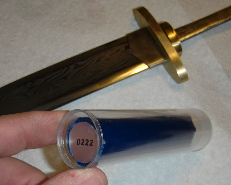

I've read on a different forum about using an epoxy putty to do a tight fit. Dave Stephens posted this a couple of years ago:
I used to burn the handle onto my the hidden tang knives I made, but had several handles crack or warp from the heat.
I recently started using this technique instead of the drill, file, file some more, file yet some more, needle file, needle file, etc.
Step 1: Drill a hole whose diameter is slightly larger than the widest part of the tang.
Step 2: Fill the whole with a two part epoxy putty. You can usually buy this at Lowes or Home Depot. It comes in small tubes like this:
You break off a chunk and knead it together. It hardens in about 20 minutes. We use this stuff to repair boats in the commercial fishery. It even hardens underwater.
Step 3: Coat the tang with petroleum jelly, and slide the tang into the putty filled hole. Then remove it.
Voila. Perfect fit.
I like this stuff a lot more than using regular epoxy because you can form it and remove the tang before it sets.
Hope you guys find this useful.
Cheers!
--Dave

Nick, have you ever had problems with getting the tang back out after you create the mold or problems with the wax staying in the handle hole?
From what I could tell you drilled the handle pin after the embedding, are you still using the torch method and the bucket to allow shaping of the shoulders and the drilling of the pin?
Hey Don thanks for the post. I was curious how well that stuff holds up in the longrun as a bedding agent. I have used those putty things for repairs at work occasionally but never on anything that was meant to last a longer time. Good idea though as its pretty easy to work with.
Thanks a bunch Nick. I am working on a hidden tang knife right now (my first real effort with proper tools), and these bedding tips will make all the difference in the world. I learn something new from you guys every day, sometimes more than once a day.
I was wondering about that too. The idea itself is very cool though.
Thanks fellas :)
Don, that's a neat idea, I hadn't considered the epoxy putty before. Sounds like a solid option. I can't do the big drilled hole though, this knife would require over a 1" hole. ;)
I did get scared with the first knife that I bedded the handle... I thought I would be able to pull it off by hand but when I couldn't, I kind'a freaked out. But driving them back off like in that photo has not been a problem.
I drilled the pin hole after everything was fit-up, but before I started shaping the handle.
