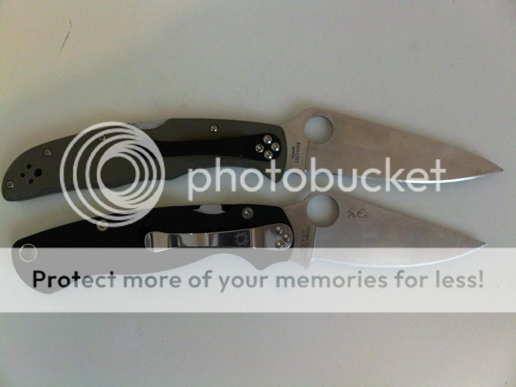

I would look into the para with cts 20cp blade; not ridiculously priced. I cut 2 ply hemp twine most of the day, some burlap and plastic pots. Nothing I have used in a production knife out lasts cts 20cp.the blade Is just a tad smaller then the endura, i believe . I never had in issue with it being too small
Took the first picture from google images as I currently don't own a endura. The other pics are my para cts 20cp.
