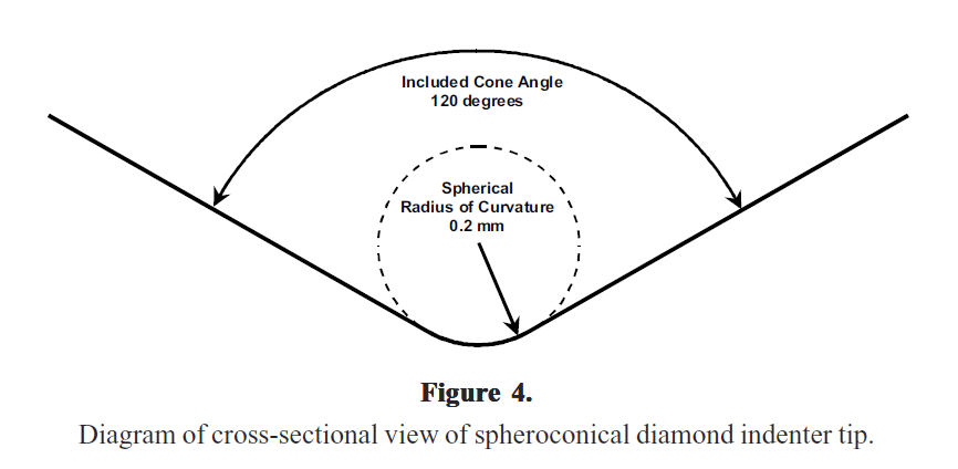

(1) HRC is basically how deep an indentation is made by an indenter which is pressed into the metal by a specific force. (See the links for details: http://www.gordonengland.co.uk/hardness/rockwell.htm and http://www.nist.gov/manuscript-publication-search.cfm?pub_id=853006 )
The indenter is sphero-conical in shape; it is a 120 degree (inclusive) cone with a spherical tip. The spherical tip has a radius of 0.2mm. Here is a diagram from the NIST document:
The indenter is pressed into the metal with a force of 150 kilograms (kgf).
Each point of the HRC scale represents the indenter sinking in an additional 0.002mm (2 microns).
Because they wanted bigger numbers to represent harder materials, they arbitrarily subtract from 100:
HRC = 100 - h/(0.002mm)
where h is the depth of the (permanent) indentation. Here, h is measured in millimeters. (Okay, this is an over-simplification because I'm ignoring the preliminary minor load. See http://www.gordonengland.co.uk/hardness/rockwell.htm for details.)
So an HRC of 100 means that there was no permanent indentation made (ie: h=0mm). (In practice, HRC is only used up to about 80, because beyond that it's hard to measure.)

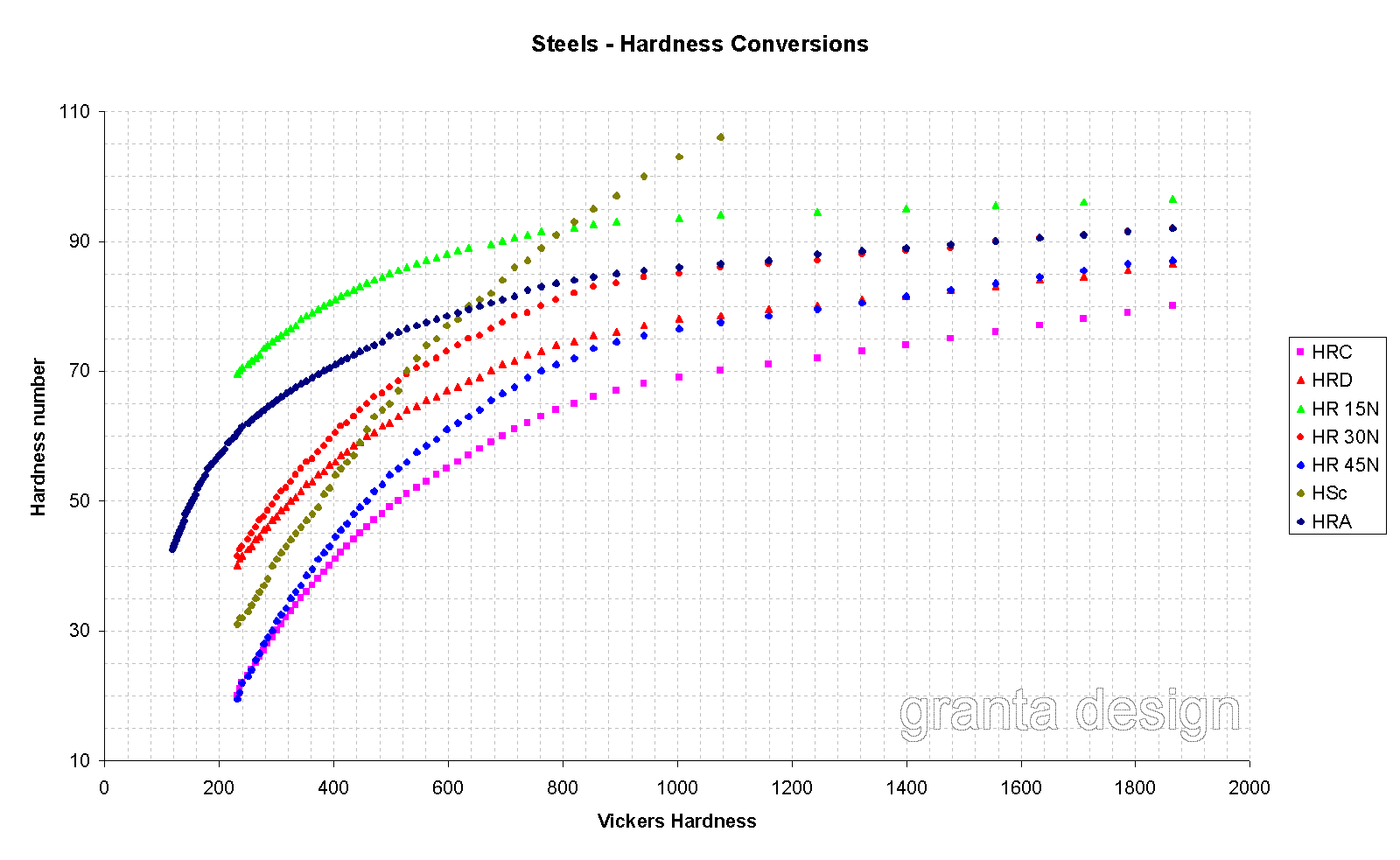

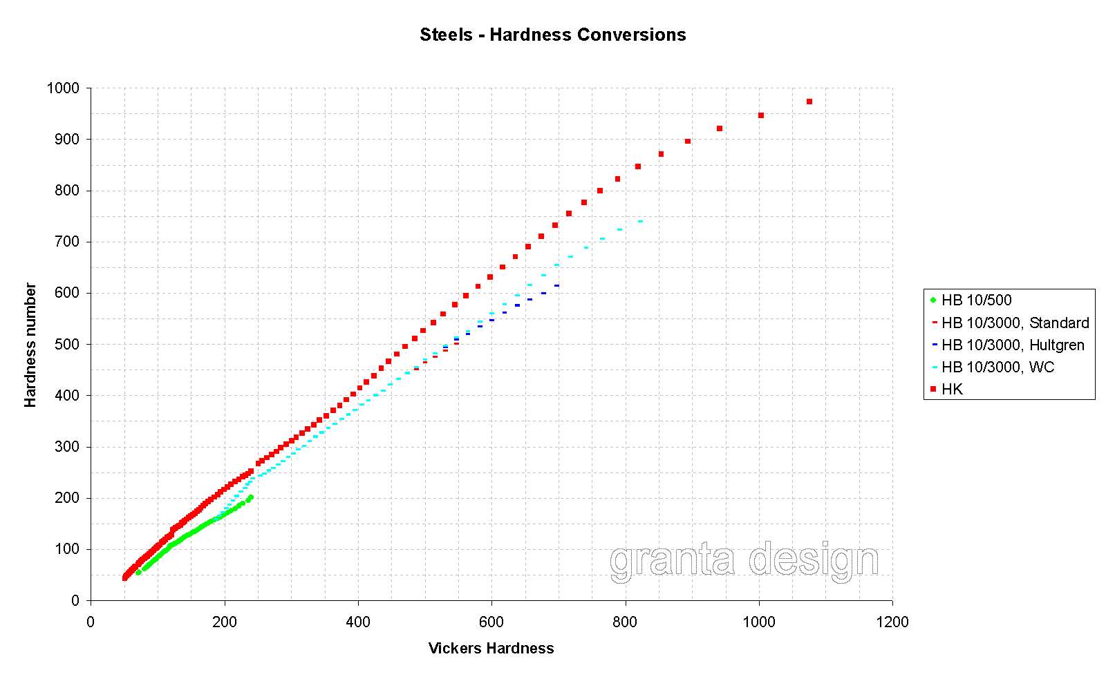

A little more on "non-linearity" of Rockwell C Hardness:
I don't know if we should consider Vicker's Hardness linear or not, but I very much like this graph of hardness scales from http://www.grantadesign.com/resources/materials/hardnesscharts.htm. It's a graph of Rockwell Hardness versus Vicker's Hardness.
HR...= Rockwell Hardness (many types)
HRC = Rockwell C Hardness
HSc = Shore Hardness
So if nothing else, Rockwell Hardness is not linear in Vicker's Hardness, and for higher and higher hardness, each point of the HRC scale is a bigger and bigger jump in Vicker's Hardness.
