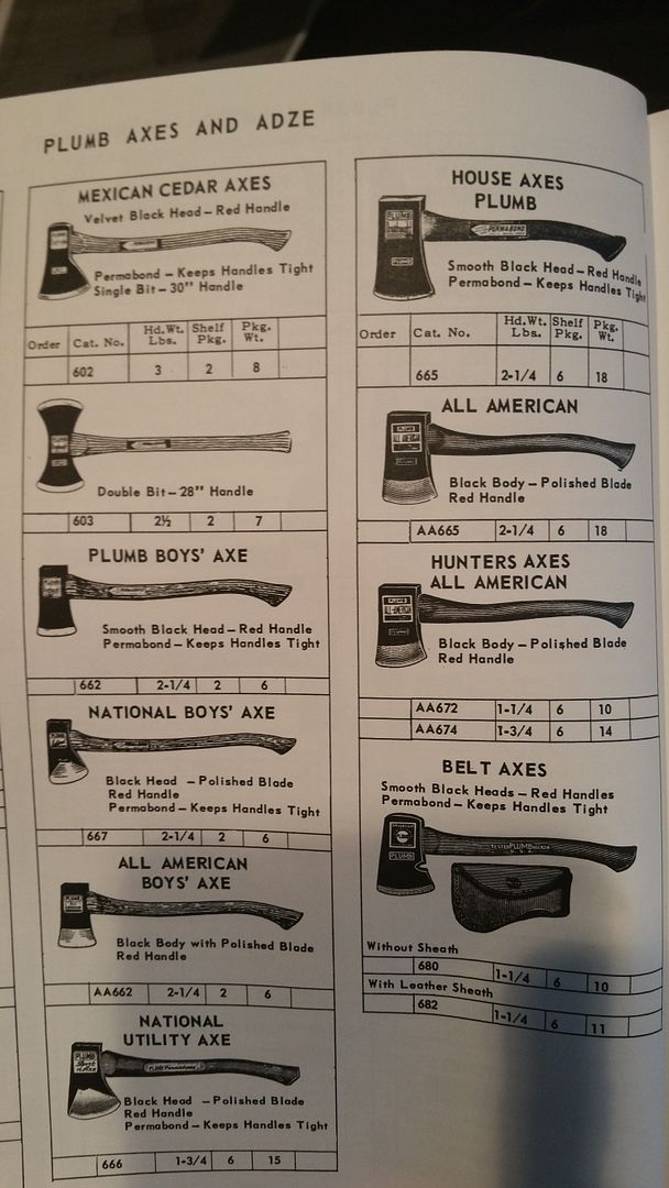

So, this is what I have for this topic -
From a 1954 Plumb catalog I just got, it shows the Plumb All American label I show above in the one pic - thus showing this label was in use as early as 1954, if not earlier -
This then shows the axe I gave the picture of can very well indeed be pre 1980, as I have claimed it to be, based off of what my dad told me.

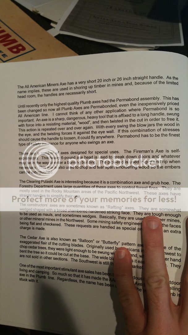

Also, in this catalog is has a excerpt from a Plumb meeting in 1974, which is a great read. This is from the Early American Industries Association -
In the Plumb meeting notes, it does state that Permabond was only used on the high end line of Plumb axes until 1974, then all axes went to Permabond technology, including the All American line, which is listed in the catalogs as not showing Permabond technology listed - from this same catalog 1954( you can see where it states Permabond or not)
The excerpt from the meeting -
This then justifies my claim that not ALL Plumb axes were utilizing Permabond technology post 1955. To claim they did just doesn't make sense based off of what I have seen out there, in my collections, others, on ebay, etc. Overall Permabond numbers in axes are very low compared to the total out there.

The 1954 catalog is part of this entire reprint that I just got. The 1954 catalog comprises of 40 pages, is in the back of this booklet, and makes no mention of Permabond being an option.
The front of the booklet has the advertisements for Permabond with axes and sledges, shows the axe with the All American label, etc. However the sledge advertisement is the same on that is pictured in the 1965 catalog posted online. So......the advertisements have to be post 1954 seeing the actual catalog makes no mention of Permabond, and this would match up with the 1955 timeline as well.
So, this mess being said, the All American label would still be way pre 1980, just not sure how early.

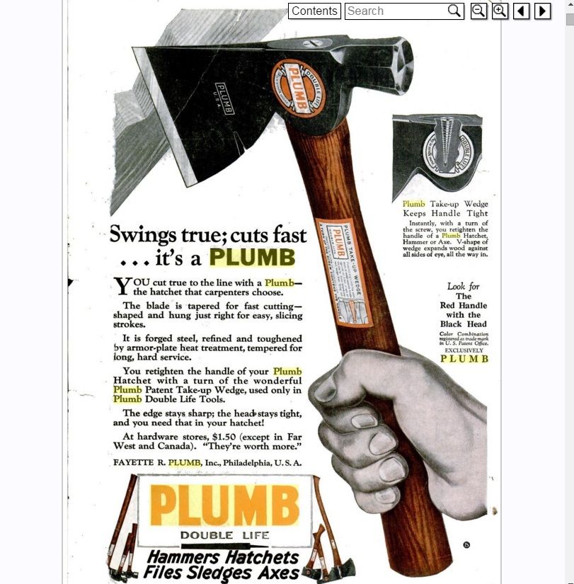

Plumb take-up wedge Mentioned 1922
1922 Boy’s Life Ad
https://books.google.com/books?id=0...#v=onepage&q=plumb axes take-up wedge&f=false

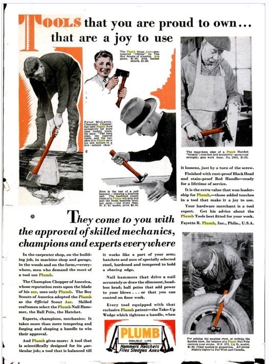

1926 Popular Science Ad
1928 Popular Science Ad
1929 Popular Science Ad

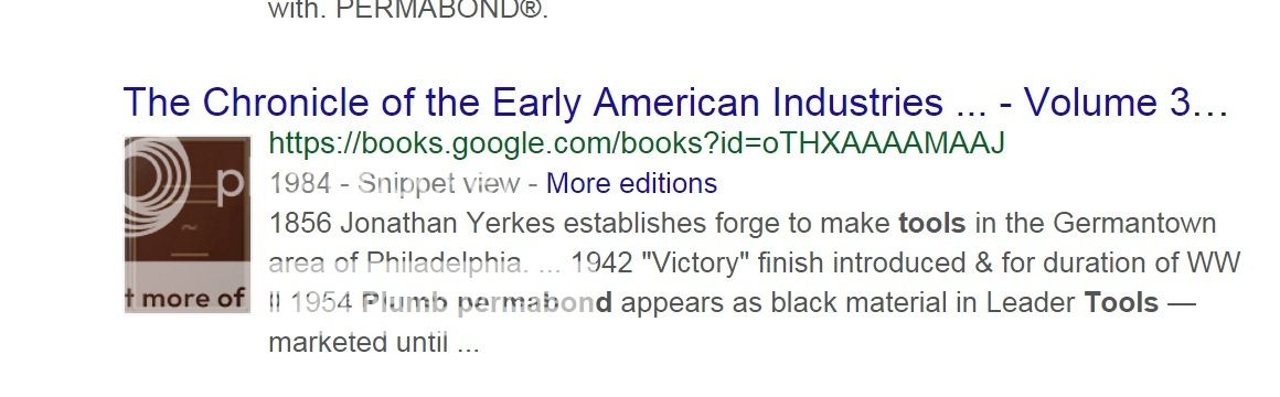

1984 reference to original black Permabond, Victory, Chronicle of Early American Industries – snippet

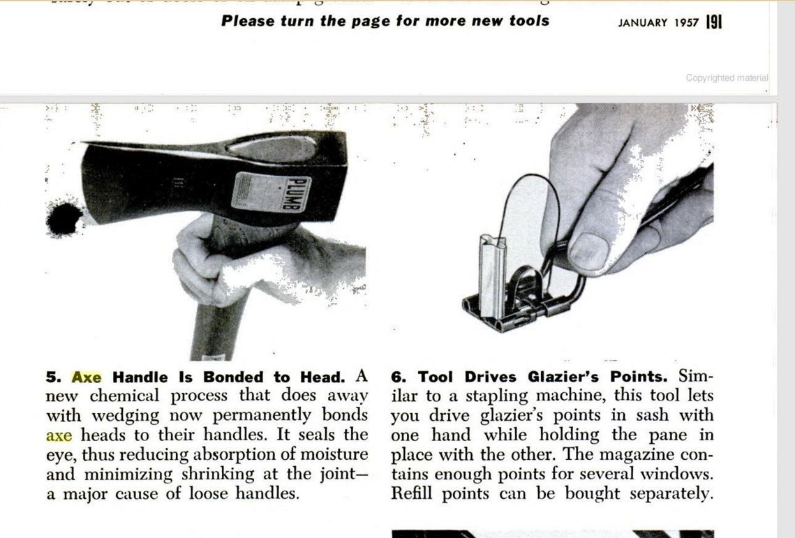

1955 Popular Mechanics Ad (First Permabond reference I could find) – see the 1983 mention from Cooper Tools below.
(Thanks for the catch Steve Tall)
https://books.google.com/books?id=2...LAhUY7mMKHaC8DTIQ6AEIMDAA#v=onepage&q&f=false

...1984 reference to original black Permabond, Victory, Chronicle of Early American Industries – snippet
I have that article on DVD (and I mentioned it earlier in this thread) from The Chronicle (The Chronicle of The Early American Industries Association, Vol. 37, No. 4, December 1984, pages 70-71, "Yerkes & Plumb" by Dan Comerford) about the history of Plumb, as told (or written) to the author by Fayette R. Plumb II (the grandson of the original F.R. Plumb).
Here's what FRPII said about Permabond:
"1954 -- Plumb Permabond appears as black material in Leader Tools -- marketed until 1955 -- L81 only."
"1955 -- Permabond in all tools of top grade. Fiberglass handle F55 and F55R appear -- solid fiberglass handle."
