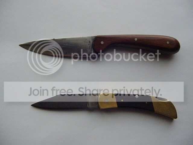

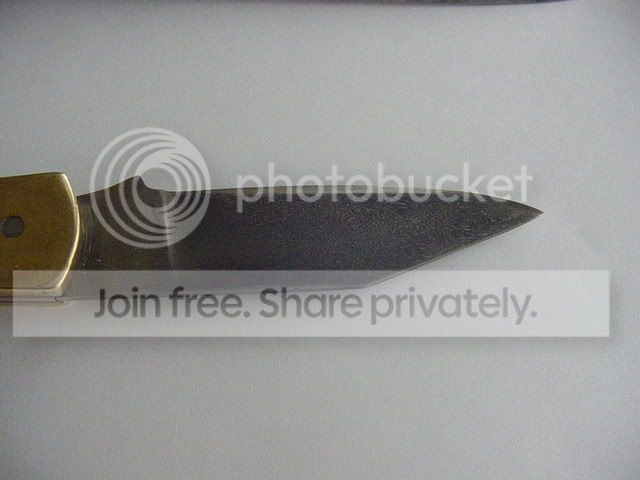

enclosed is a picture of my lawn mower blade pocket knife that i used for many years ( i suspect its 1045) ... not bad compared to some of the production knives i've own in the past..
and the folder is my first pocket knife... i got it for my 8th birthday and broke the tip on it the following year... left the stainless steel tip in a tree digging out a BB from my BB gun....it bothered me for a long time.. i liked that little knife that i held onto it for all these years... changed out the blade awhile back for a wootz blade... .. i get a chuckle out of thinking that someday, when i'm gone it'll show up on a forum like bernard levine's... haha ... i'd be good fun to see what kind of answers those guys come up with..;)
