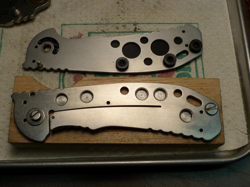

The local Post Office scale is not that accurate, but it was the only scale available to me at that time. I didn't think that much was removed to make it much lighter as I had posted before. The SS material of the liner is 1/16" (.062) in thickness. After weighing at the post office I did go to the SS locking side (.128 thick) and removed some of this material as well. Five blind holes 1/4" dia. x .090 depth. I feel that this frame being made of stainless has made this knife more handle heavy then I like. I guess titanium would make it better IMO. Thanks for your calculations.

Nice friggin job there, rpttrsn :) I ordered my 0566 this morning, so should have it shortly, and will more than likely: 1) de-assist; 2) polish, clean and white lithium grease; 3) do a flipper-ectomy, after I check for nice thumb-stud action; 4) grind a small thumb-relief into the G10, for better access to studs: and, 5) lighten a little just as you have (I think this knife would be amazing! at 4.00-4.25 ounces...). Well... double checking the math again, you probably only got it down maybe .200 to .225 ounces for the work you did, but there's still room for a lot more (if you ask me..). I bet 10 or 12 of those 1/4" holes would work just fine, and another 4 down in that lockbar portion too. Still PLENTY of room to hog some more out, which would never be noticed externally, or in needed handle strength. So, what's your set-up for those counter-bored holes? You have some kind of mill? What kind of plunge end mill did you use? (sorry, I'm NOT a machinist, but I would like to know!- save me some time maybe...) Thanks man :)

The following is how I did it. Others might have different methods.
I used a drill press which is not heavy duty. You need to be careful in a drill press using an end mill. It is easy to bend the arbor. Mount the liner/frame to a piece of wood so you can secure it in a vice. Use cutting oil if you can.
1. Mark location
2. Center punch the location of each hole
3. For each cutting tool set you drill press stop for your depth
4. Center drill each punch mark to the max. depth you want.
5. Drill a smaller hole then your finished size.
6. Drill your finish size to the depth of the center drill. You don't have a flat bottom hole at this time.
7. You can now use a two flute end mill ( same size as the drill you just used ) in the drill press to clean out the hole. I also make a flat bottom drill out of a drill bit to accomplish the same thing. Need to know how to sharpen a drill for a counter bore.
8. Use a drill approx. 1/8" or larger then the hole to break any burrs by just running this bit, and lightly touch the top of each hole.
9. Lightly stone surface if necessary. Any stone marks can be removed with scotch brite.

Thanks a bunch Ron. That does help, just to know to finish the bottoms out with the 2-flute. Now I wonder where to buy one or two? I could always order through someone like Grainger or McMaster-carr, but wondering about local, like maybe Ace h'dware, Sears, Lowes', etc.... I'll figure it out. Good to know you did it with a press too.... I have a a baby Delta, and a nice little Palmgren vise, and the good Cobalt bits to get things started. By the way.... I also have a solid modeling program (Alibre) on my home desktop, so will probably model up just what I want to do, before I start to cuttin'.... P.S.: GPK, that I ordered from, commented on what I wrote to THEM, that the blade specs should actually be 3.25", and NOT the 3.50" that they show. They said they measure on their own, and also double-checked, and what do you know.... they confirmed that the blade is actually 3.50", and NOT 3.25" as advertised by KAI/ZT, as well as anyone and everyone else who sells the 0566!!!! Wow... first I've heard! How hard is it to get the blade length right??? I'm fine either way, but really, KAI/ZT can't check their advertising and give accurate measurements? How goofy...
