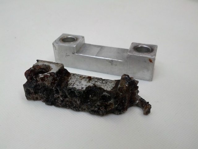

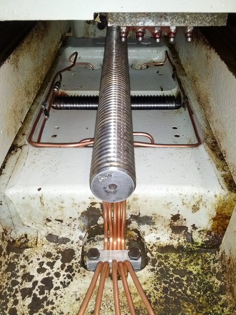

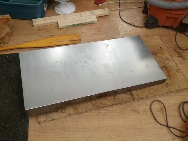

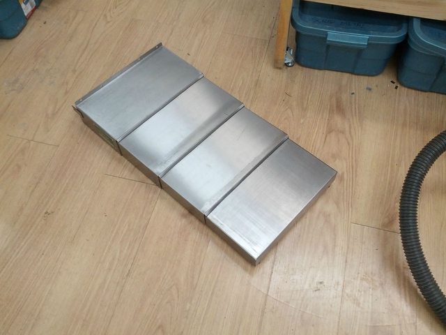

Over the weekend I received some new parts and some spare parts for the machine. The most important ones were the new grease manifold for the Y axis and also a new way cover for the Z axis:
The way cover that came with the machine was a ratty fabric bellows that looked terrible and didn't work properly so I'm glad I am able to replace it with a proper cover.
The grease manifold went on nicely (after a bit of persuasion) which was nice. I'm still waiting on one part for the grease system on the Y axis, but after I receive that the machine is ready to start going back together! Pretty excited to get started actually using it!

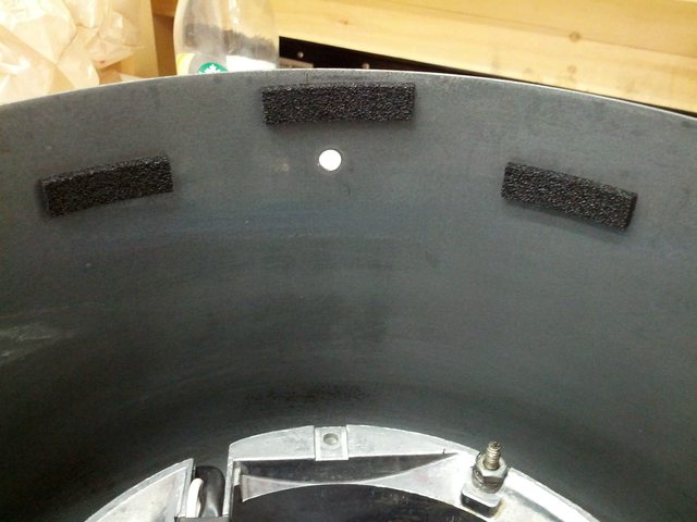

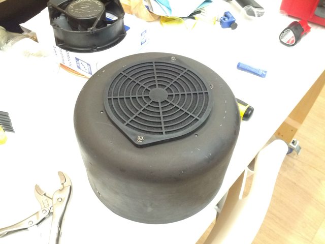

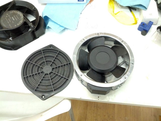

One other little thing I did was put some neoprene rubber strips under the spindle motor fan cowl. At high spindle RPMs the cover would rattle and make a hell of a racket. With the foam in place it's dead quiet and the machine is pleasant to stand next to even when running at full speed. The foam was basically just weather-stripping:
