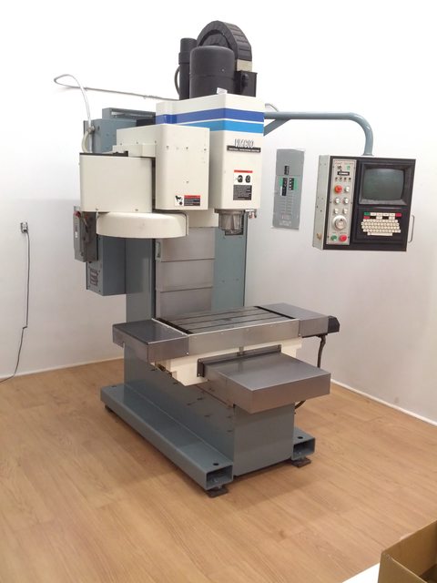

Ok guys! The machine is finally making real movements and is at least partially re-assembled!
[video=youtube;_A4IJtxi_mg]https://www.youtube.com/watch?v=_A4IJtxi_mg[/video]
Very cool to see it finally actually moving properly! I lashed up a sharpie mounted to the spindle, I've found with previous smaller CNC machines that this is a good way to get familiar with setting offsets and so on with very little risk or expense.
The grease system on Y axis is fully operational now and seems to be working well. The covers are back on the toolchanger and head, and the new Z axis way cover is in place and working nicely!
I'm going to leave the covers off the X and Y for a bit so I can make sure the grease is getting where it should. Once I'm looking at actually cutting some stuff the covers will go back on.

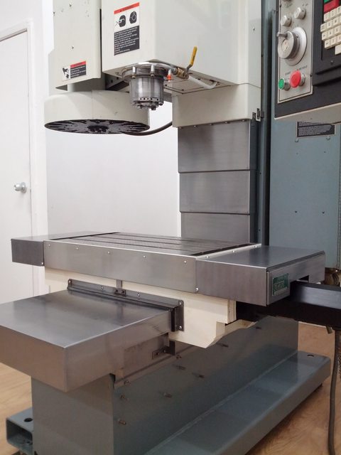

Was able to put all the way covers back on yesterday, really pleased with how everything has turned out!
For the most part I was able to sand a lot of the rust/pitting off the way covers with the help of an orbital sander and 80 grit ceramic disks. Where I wasn't able to remove all the pitting what I did was to degrease them thoroughly, then paint them with 'aluminum' tremclad. Once that had dried for a few days I sanded the way cover again. The paint was removed from all the good metal, but it stayed in any areas that were pitted. In some cases this merely made the covers look 'ok', but in others it made the pitting disappear entirely! Very glad that worked out ok!
Before:
After:
Before:
After:
I'm proud to have this machine in my shop now. It definitely feels like it's 'mine' and I'm looking forward to making chips soon!
