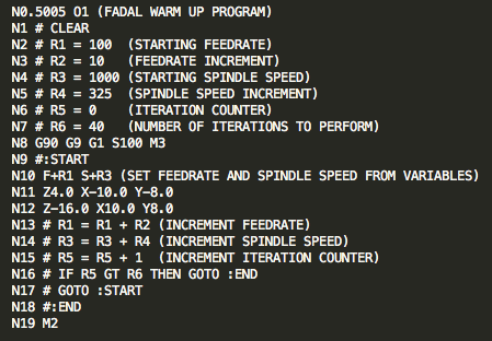

Make a screen shot or jpg file of the code, then post Jess
Good idea Jess!
Here you go:
The N-words leading each line are just line numbers. The R-words are variable names. Every line that needs to be executed programatically has to be preceded with a '#' symbol.
G90 tells the machine all coordinates are absolute rather than incremental.
G9 tells the machine to use feedrate ramping when accelerating to a new location.
G1 tells the machine that it should be making linear coordinated moves, as opposed to G0 (G0 denotes rapid non-cutting moves with no need for coordination between axes).
S100 sets the spindle speed to 100RPM.
M3 turns the spindle on in the clockwise direction.
F+R1 sets the feedrate to the number contained in variable R1.
S+R3 sets the spindle speed to the number contained in variable R3.
The statements starting with XYZ are telling the machine to move to those locations (in inches).
This is a fairly small sample of the kinds of sophisticated programming that can be done on a machine like this. More sophisticated programs might take results from sensors and use them in the program, for example when grinding with a stone mounted in the spindle. Lots of interesting things are possible that's for sure!
