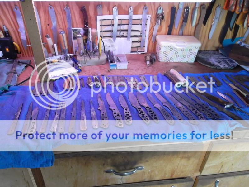

These i just finished the heat treat.
Well...I think that answers everyone's question. Looks like you are going for light knives....

I realize the importance of being exact with the holes that will be used for the pins to attach the scales.
Is there any pattern, or importance in placement and or size of the other holes in the tang of the knives? I know balance will be a factor as well.

A lot of guys talk about my tradional knives cutting. The process not a big secret, its simple. Heat treatment and the grind. Hollow ground blades on big wheels; 14 to 18 inch is what I use. These bigger wheels allow the blade at the spine to be thinner, much like a flat-ground blade. However, at the edge back, you can get a thinner blade. Then after sharpening several times, the blade will remain sharp. Flat ground blades get thicker the farther you get away from the edge. If you look at a splitting ax for wood and then a straight razor you can see the difference. Heat treatment is the other thing. Ats-34 and 154cm are two of the most popular stainless that are used to make tradional knifes. I do exactly what the manufacturer recommends and then I test my oven temperture every 3 months with rc testes "plural" ! The temperature I use are as followed. PER Manufacturer DIRECTIONS!!!!
30minute 1250 degree stress relieve
45 min 1950 degree austenite "hardning"
8 hours -300 in liquid nitrogen "tranfer all retained austenite"
temper blades 2 times @500 degree for 2 hours each
temper springs 2 times @ 1070 degree for 2 hour each
On a side note on many tradional pocketknifes you will see some rust or pitting on the inside or outside of the spring. This is because @ the higher spring temper temperature you burn a little chromiuium out of the steel which is what makes a stainless stainless. This can't be avoided.
There it is! Pretty simple really.

There are 1/8 pin holes where they need to be. All the other holes are just random. It makes the handle lighter in the hand and its less material to remove when tapering tangs. I like the knife to be blade heavy when i am useing a big knife! It helps the knife work 4 you while skinning.
