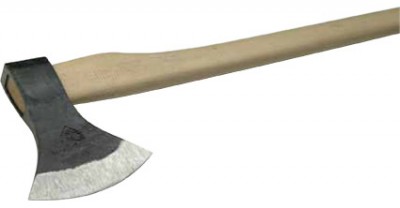

You are absolutely right about the weight of trento n5 : 1300 gr (not 1500).
Rinaldi has 2 type of Cadore axe : 310 (narrow) and 311 (broad)
Both are N6 (1500 gr the head) :
I think competition axe is simple a Cadore Axe 311 N7 (1800 gr) : but it may be that I'm wrong.... i olly own a cadore 310 n6 :)
Yeah, the competition axe is a separate model number (312) and it's definitely thicker in the cheeks than the Cadore is, and more flared. It's very similar in overall style, but the differences are significant enough to warrant it being its own model. Just looking at a stock photo you would have a hard time telling, though!

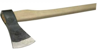

New Rinaldi hatchet in 2019 :
the news is that the handle : it is curved and shaped, and 3 different lenght.
Also the connection head -> handle is different.
I don't know if this is an improvement : next days i will buy one.
They are 303 special and 307 special (trento) n0 :

The shape of the handle of "new" model.
I like it! it is not a "thin" (300 gr hammer like) handle, but it is reasonably often, and it handles very good!!!! The sensation is : "the axe never slip off from your hand".
I also like the wood : mountain ash : it is not painted or treaty, and it feels good.
A tomahawk?
It seems that with this handle (50 cm), the head is too "light".
But it is the same sensation that i have with a real american "tomahawk".
Rinaldi 0 Special is a real "tomahawk" ? : i gues so : you can handle and throw easily with one hand.
Compared with the Rinaldi N2 (normal) : you feel that N2 is a "one and half hand" axe.
The sensation is : Rinaldi N2 weight twice as much as Rinaldi 0 special : but the difference is only 200 grams.....
