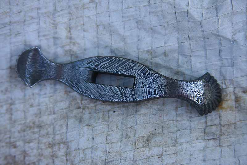

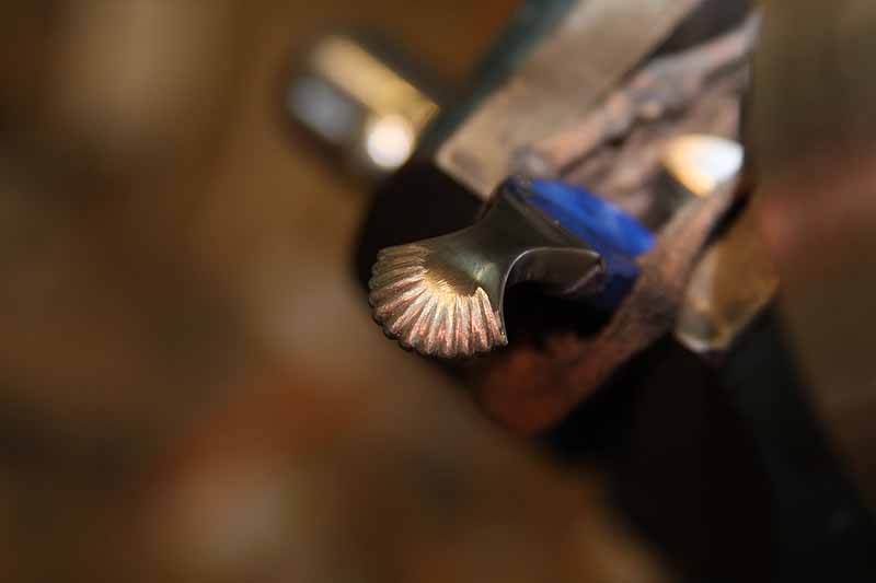

Here is the guard hand sanded to 600 grit.

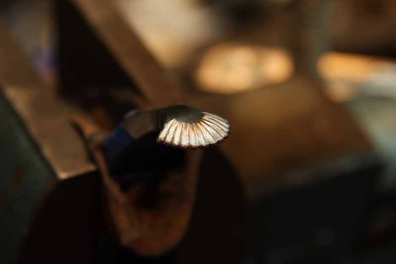

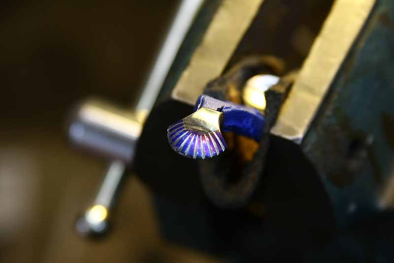

Now I've made the first cuts with a triangular file for the clam shell.
Here I have rounded the first cuts out.
This is another shot of the rounded cuts. It is now ready for sanding.

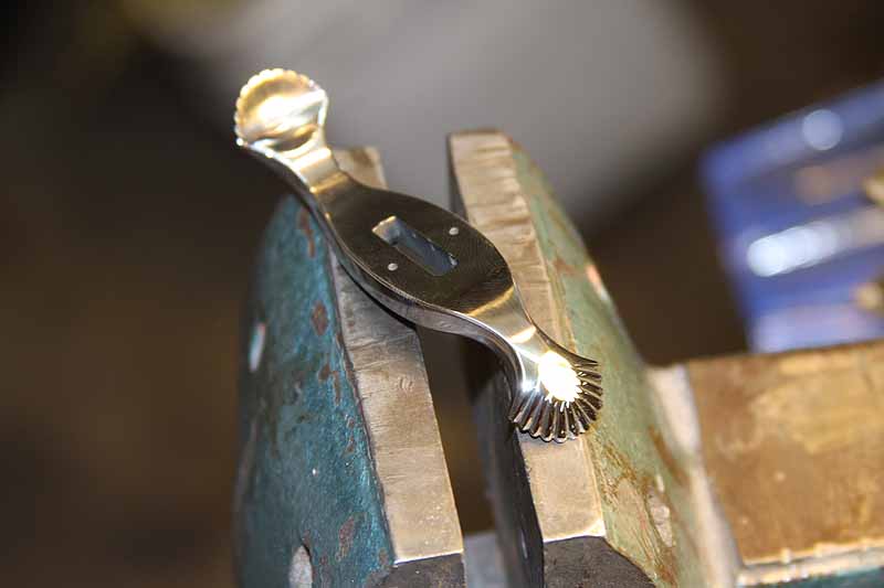

Now I've sanded everything on the guard to 1200 grit and am ready to etch. I also went over it with the buffer quickly to shine it up a bit.
I have etched the guard and gone over it with a little 2000 grit paper and the buffer.
Here's a shot of the other side. It came out great. IMHO

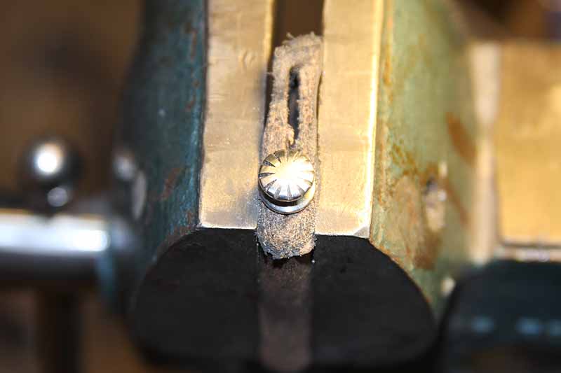

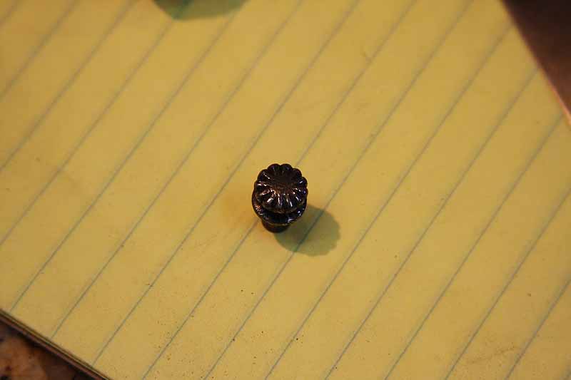

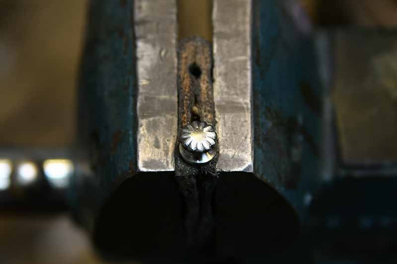

Now I'll put the clam shell theme on the pommel nut starting with the triangular cuts.
Here I've rounded the initial cuts and am ready for sanding.

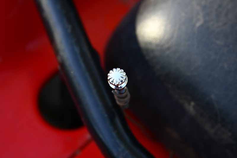

I have sanded the nut to 1200 grit and buffed lightly. It's ready for the etch.
Here's a side shot of the pommel nut after etching.
This is a top view of the nut. The pictures didn't come out very good on the nut so I'll try to get some better ones for the next instalment of pictures.

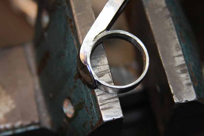

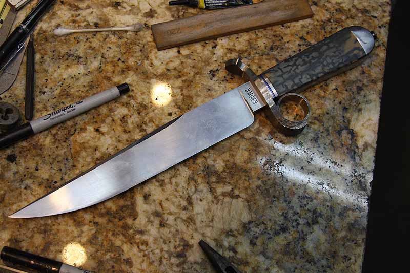

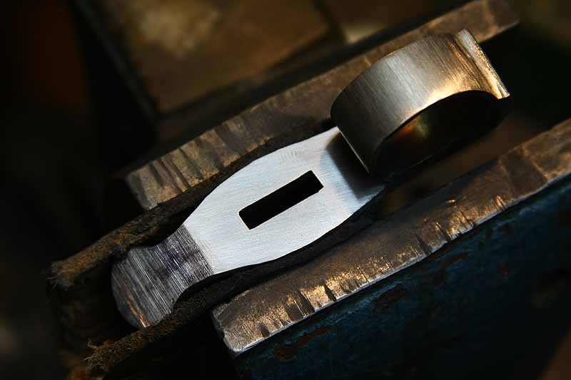

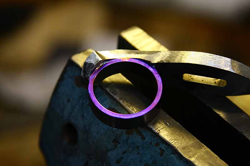

Well I can't put it off any longer so I guess I'll just jump right in on the ring guard. I have sanded the surface that the spacer will touch to 320 grit. I have also shaped the top of the guard a little.
Here is a picture of the guard on the knife. Looking a little more refined???

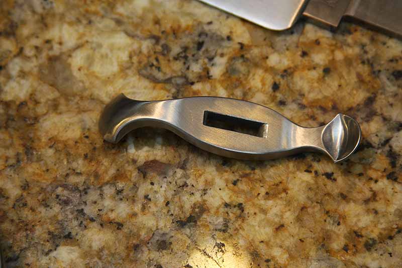

Here I've relieved the ring so it looks like the guard is hugging up against it. I used the Dremel tool for that.
Now I have refined the ring with a polishing stone on the Dremel and have rounded the part of the guard that will have the clam shell on it.

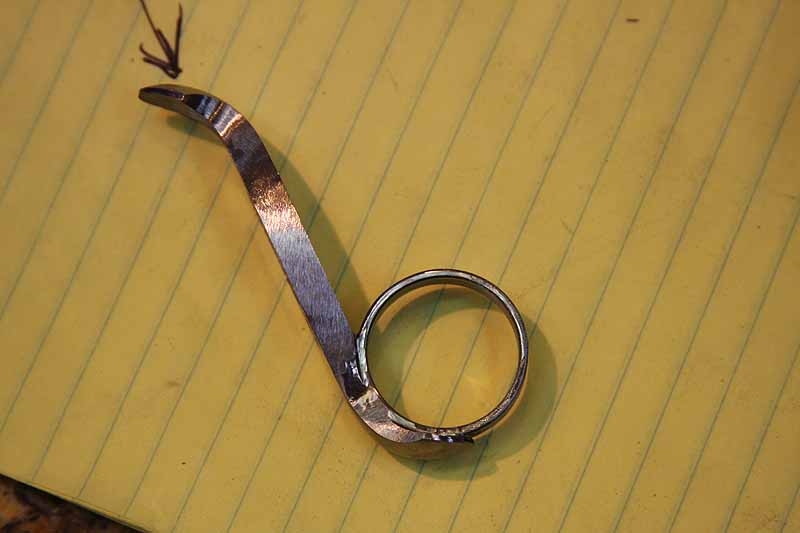

I have rounded the top part of the guard where the arrow is pointing in this picture.
Now I've sanded the guard to 220 grit with a slack belt and have rounded the edges off with the needle files in this picture.
And now I've made the initial triangular cuts on the clam shell.

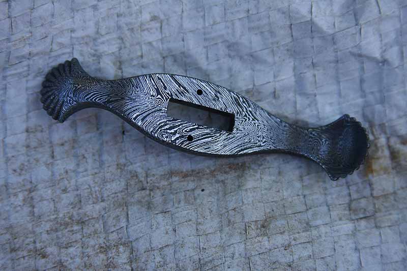

I'm just about ready to finish the hard part of this project and then all I'll have to do is a little hand sanding on the handle, the file work on the liners, hand sanding on the blade, etching all the damascus and salt blackening everything to make the damascus stand out better.
