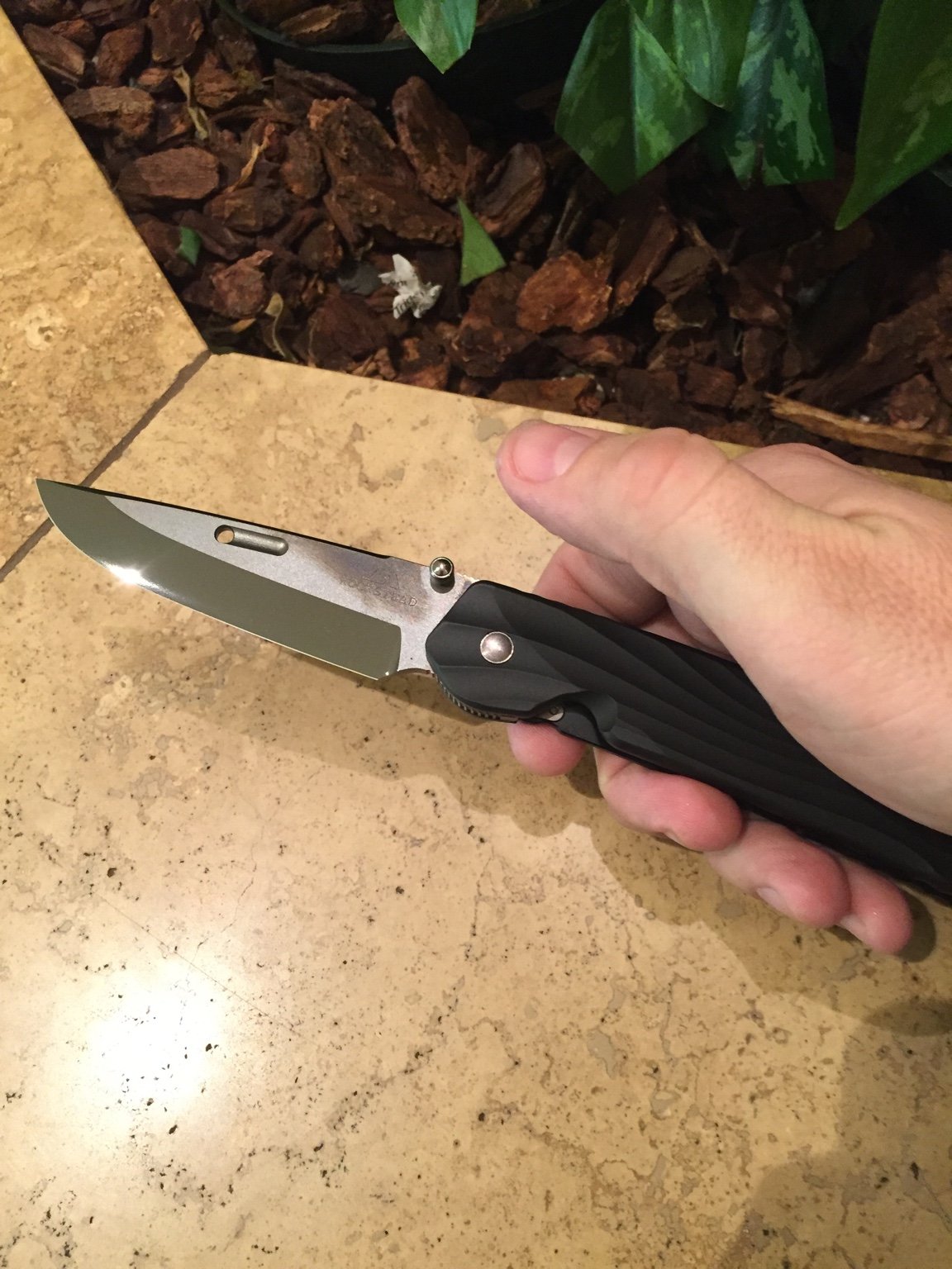

I was just going to use the kangaroo strop with .5 micron paste on the wicked edge. Figured that will keep the polish as well as the convex. If it has more scratches then I was thinking to use the 10k choseras(water stones) first.
Anyways, finally opened it. Here it is in all its polished glory...

Great choice, Congrats!!!
