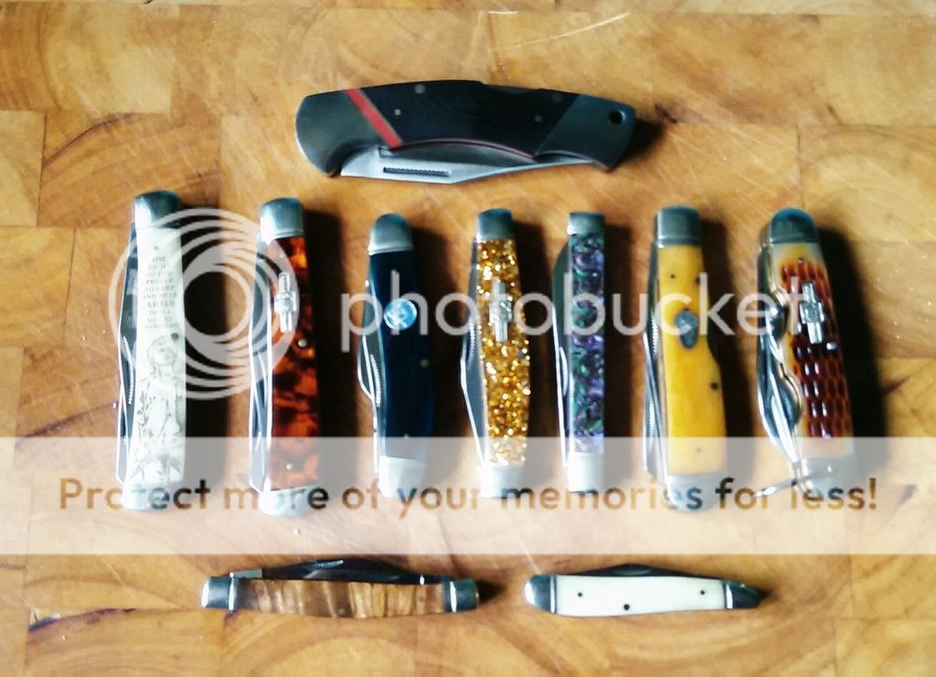

Excellent example, really thick deeply jigged bone slabs a rich dark colour not unlike a Tortoiseshell cat (think Americans say Calico cat?). I really like this knife, its size 3" is just right and the thick slabs ensure looks and comfort. Finish is super, centre blade, excellent radiusing of the bone&liners, spring cut off square, bolster finished properly(no sharp edges) Flush in Open/close, strong half stop and loud talk, murderously sharp. No play at all.
Criticisms: Don't like lanyard holes they spoil a knife for me and totally absurd in a small knifeIt also causes slight gaps at the rear where a pin would tighten it up. But it has it because it's a mini version of the full size CS. Otherwise, this knife is high quality finish.
Its uses: well, never cared for the full size versions, just too massive for my taste and how did they sample a cotton bale with it? Any films? It will work well for any gardener, cuttings, harvesting veggies, opening sacks, good wire stripper too and its compact size is a bonus for these tasks. Not bad as a putty knife when you need to tinker with windows and probe old stuff outMine are all metal these days so that's redundant (thank god)
I'd like to underline that although small it is in no way toy like, RR do this very well with their small knives, likewise so do CASE. GEC small knives are far less credible for me, too skimpy and toy like-the 25 excepted and that's bulbous bug like
I liked it so much I bid and won on a Smooth Bone version. I recommend sampling one of these, a quirky and worthwhile addition to the collection.

Inspired by this, and because I hadn’t bought a RR in a while, I ordered one in jigged and one smooth. The smooth one came today. My first thhought was “Awww, isn’t that cute”. Very nicely made, F&F, snap, no gaps, everything. Almost Peanut-small.
It came with a lot of the details that are showing up on new RR patterns: matchstrike nail nick, a single lined, slanted bolster. If only it had an acorn shield, it would be just about perfect.
Because it is quite sharp, it should do just about any EDC task that does not require a sharp point. Where it will really shine, however, is at putting a dab of olive tapenade onto a Pita-Bite.

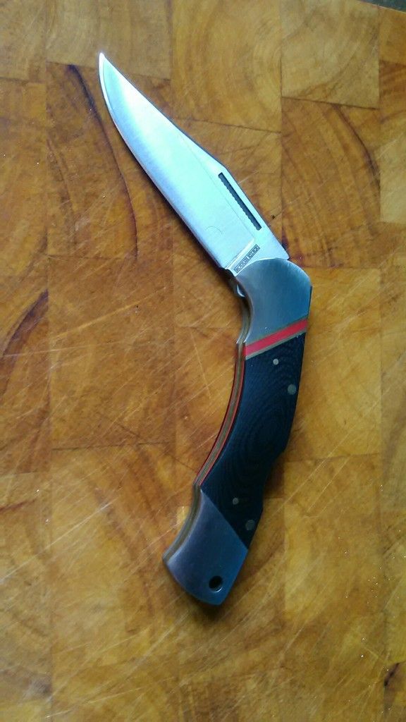

I've been on the hunt for a traditional looking lockback with a shield, something in the 3-1/4" to 3-3/4" range with a stainless blade. I thought I'd have a good selection to choose from but there isn't much out there that I can find. Rough Rider makes exactly what I was looking for, but I haven't had much luck with their lockback knives. I decided to order one anyways and see if I could get a little luckier this time. It is a beautiful little knife with no gaps and a nicely centered blade. I was getting excited because it was exactly the look I wanted for this knife. I opened the blade, it has a great looking blade on it by the way. The blade snapped into the lock with authority, now I was really getting excited. Have I finally got one of those quality Rough Rider lockback knives that everybody has been singing the praises of? Then I noticed its one downfall, the blade flops around side to side when locked open. The up and down play is super tight, so the lock is at least solid on this one, but obviously the bolsters are too loosely fit and causes some very annoying blade wobble. I'll probably keep it because I really like the look of it, at least until I try to tighten the pivot pin and possibly ruin it. Lol.
I think in the future I'll stick with Rough Rider slip joints and stay away from their lockbacks, I know I've said that before...

I'm thinking of doing this exact thing. It's worth the risk with a $10 knife.If you don't mind risking making it too tight, you can put the top bolsters between towels and tap it with a hammer to tighten the pivot. The pivot pin might stick out some once you're done though.

I did that with one of my GEC 72"s it's tight as a drum now.I generally don't prefer locking traditional knives. I prefer slipjoint or fixed traditionals. Even higher end lockback traditionally made knives seem to have more issues. I think it's just more difficult to make a lockback with traditional construction without blade play because of how they're put together.
