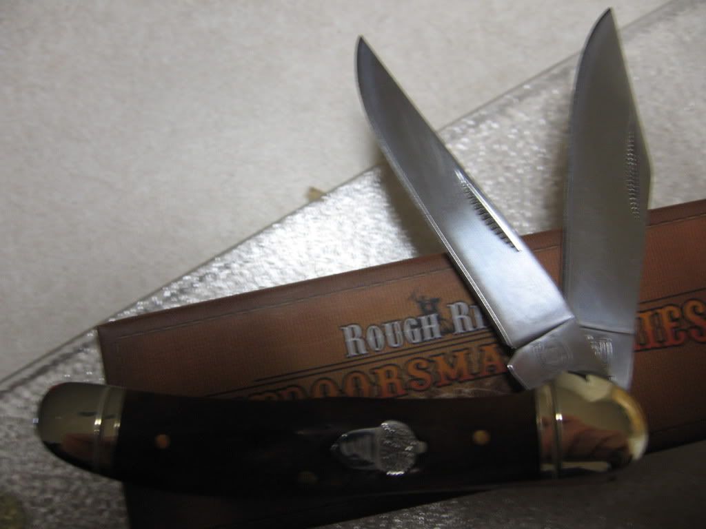

The show us your Copperhead thread "made me" buy this.
The darn thing was so nice,i "had to" buy these.

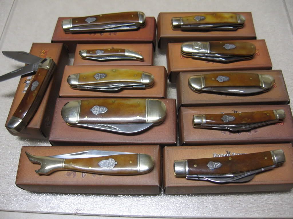

Hey Seals, i know exactly what you mean. That's why i have over 100 of these RRs(& still growing).
But it's Fun. Pretty well every knife is a good one, some are simply excellent, all are shaving sharp, and you didn't spend all that much money.
My RRs are just a small part of my knife collection, but i really like them, use some of them, and get a lot of pleasure from owning them.
roland
Yep,They are amazingly good knives for the money.In these 11,i have about $100.
I bought a package of RR "blems" one time, and except for a couple which had obvious flaws, they were all great knives, and around $4.00 each.
