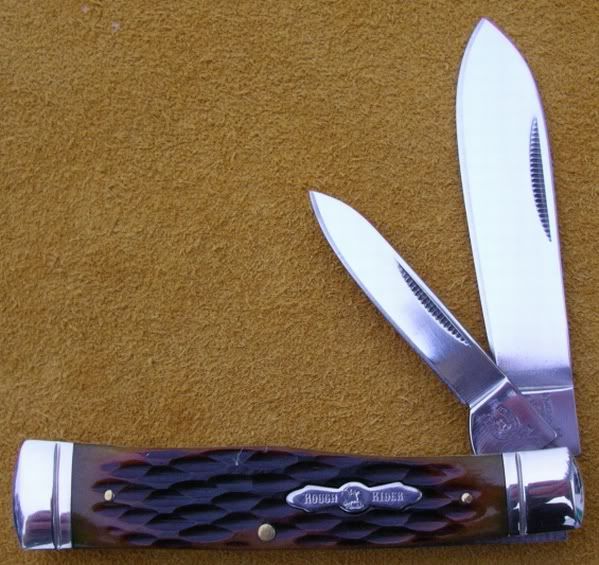

Here's 3 recent RR arrivals. The quality continues to climb.

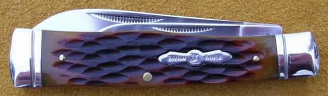

3 1/2" 2 blade Gunstock

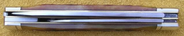

note the wrap around spring for the Pen blade:

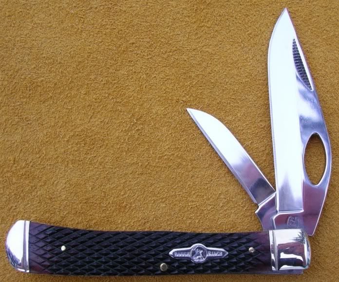

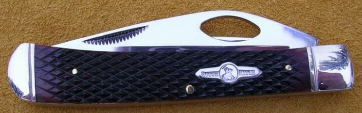

Here's a modern take with a 4 1/8" Trapper:
Saber ground Master blade locks in the open position, released by depressing the Wharncliffe blade:
Excellent fit of scales/liners/spring and blade spine in open position:

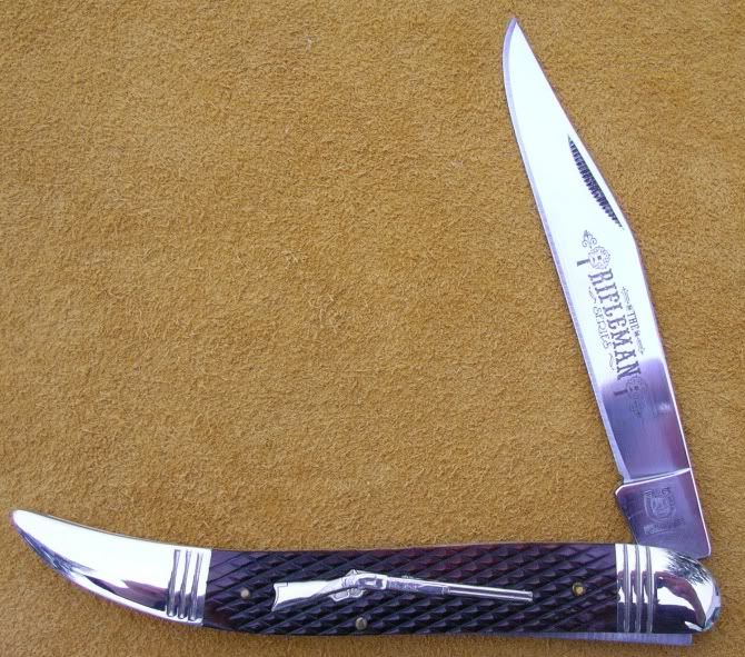

And finally, this is the first 5" RR Toothpick i have seen. Rifleman Series:
These 3 are all well designed and very well made knives. All blades have smooth yet crisp action, just the right degree of 'pull', zero blade play even with force applied, and the Gunstock has half stops.
