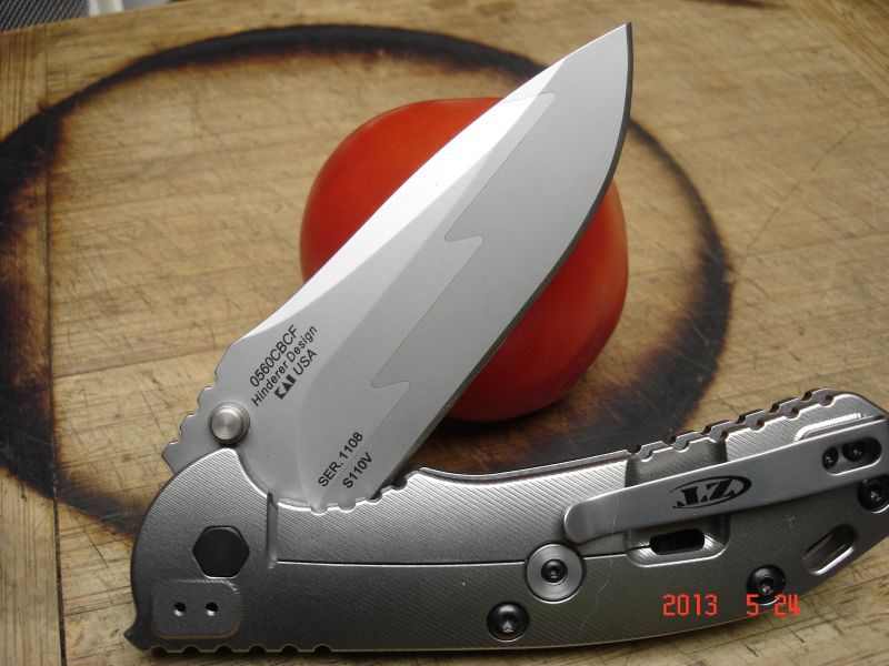

The ZT 0560CBCF is your basic awesome. It has amazing fit and finish. The edge is evenly ground at 19 dps, and the point is as sharp as any production knife I’ve seen. I don’t see a single flaw.
But I’m wondering what to expect from the S110V edge steel on the composite blade, which I read in one post is hardened to about 59 Rc. I can’t find where ZT releases and discusses the hardness specs for its knives, but my understanding is that the sweet spot for this steel is quite a bit higher, maybe 62-63 Rc.
The blade is fairly thick: a little more than 0.03 at the shoulders of the 38 degree edge. I’m wondering if the potential of this steel to hold an edge is wasted when run this soft, or whether it matches well to a heavy blade designed to handle light abuse. Usually, I put a 30 degree edge on all my blades, but would a 40 degree edge work better with this steel at this hardness for run-of-the-mill EDC uses.

Here's the knife:
Personally I would be disappointed. Hitting that low on the hrc is a waste of good steel. Not to mention the shoulder thickness which you think they would correct by now... and let's not try and make the excuse and say its done for strength, cause that's BS.
