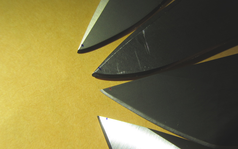

I don't have a tanto Griptilian, but I measured the thickness of the tip of the drop point Griptilian (551) and 0620. Just for grins, I also checked my 0630 and Barrage (581). On the 0620 and 0630, it was measured along the spine of the blade (thickest point) 3mm back from the tip. On the Grip and Barrage, it was along the grind line for the primary bevel (thickest part at the point of measurement), also 3mm back from the tip. The 0620 and 0630 both came in at 0.98-0.99mm. The Barrage was 1.04-1.05mm, and 551 came in at 1.11-1.12mm. I did erase, re-mark, and re-measure each 3 times, hence the variances.
Here's where I measured each blade (blue dot):

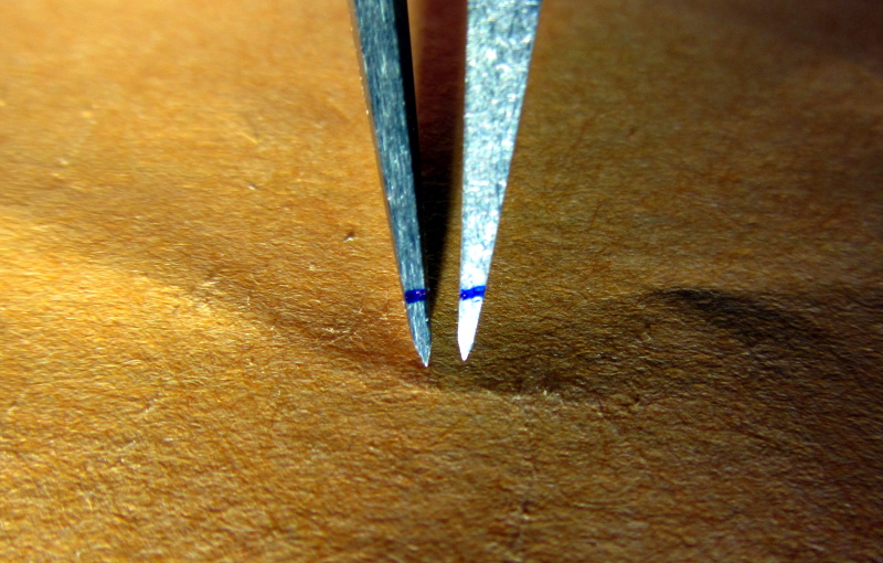

Here's a shot from the spine of the 551 (left) and 0630 (right). The 551 looks thinner, but that probably due to the swedge.
I don't know how the tanto Grip differs. From the pics, it looks like the taper to the tip does start later than on the 551, so the tanto Grip may a bit thicker.
Regardless, when hammering the blade through a hard material, that's quite a lot of force being placed on a pretty thin piece of metal. I'd submit that it was more a matter of luck as to which tip broke (ie. going through a knot, twisting on a particular hit, etc.). If you really are in a SHTF situation and absolutely must baton through something with a 3.5" folding knife, then a busted tip probably isn't your biggest concern (and the rest of the blade is actually still usable as a knife).
