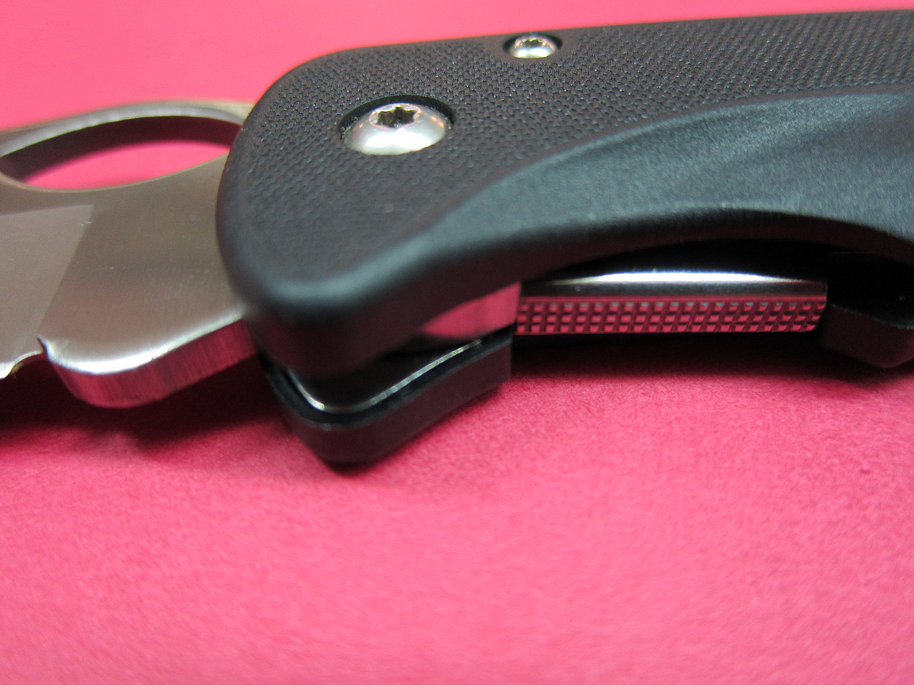

As far a spine wacking being a useless demonstration, I only remembered later an incident where my Cold Steel Pro-Lite really saved a trip: My bike chain had jumped off the gear wheel and wedged itself between the frame and gear assembly: It had been wedged there by the force of my full force pedalling being abruptly stopped, so you can imagine the energy...
Because of the narrow space, the only tool I had that could reach in there, and tap the chain free, was my Pro-Lite's spine...: A somewhat beefy liner lock folder, with a curious "double hump" bowie blade and a very functional oval opening hole (which I liked better than a round hole), probably one of the best liner lock folders of the time (around 2000): I proceeded to spine wack it about a hundred times to free the chain, spinning it full force by the tip of the handle: Finally, after all that tapping, the chain came free and the trip, hundreds of miles from home, was saved... (Otherwise the bike's rear wheel would not even turn, so I could not even push it besides me as I walked: It would have had to be carried: That meant abandoning it...)
Not my actual knife:
A pretty beefy lock at the interface, but elsewhere the liners are thin throughout, so again not the rigid bar/faraway flex point of a framelock:
I would say generally, because of this built-in flexibility issue, that thin-bar liner locks are probably better in reliability than framelocks, which is the opposite of the impression they make... I still do not like that, on linerlocks, the all-or-nothing ball detent "step" is the only real safety feature keeping the knife closed: After decades of carry, an oddball incident will eventually jar it open... Lockbacks keep a continuing closing pressure, which is the big reason to choose them.
I have to say that, as I wacked the Pro-Lite's spine a hundred times as hard as I could, it never occurred to me that a linerlock, or a lockback for that matter, could slip... This being around 2000, I had fifteen years to wait to first hear of the spine wack test, and of failures doing this... I do however remember in the 90s hearing about liner locks opening in the pocket, and of this being considered a common issue...
