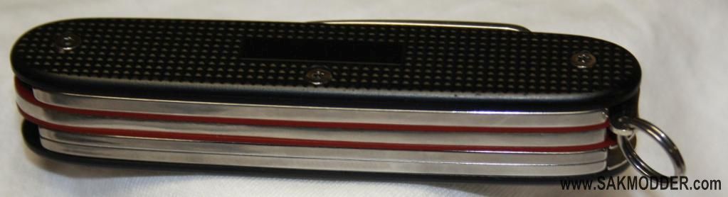

And that leaves me with this fantastic piece made by Robert Lessard:

I don’t need a locking blade on a SAK. To fit the inline Phillips from a 91 mm Officer’s knife, Robert used two 93 mm opener layer backsprings, and a couple of spacers to center the Phillips driver between them. You can see that here:
