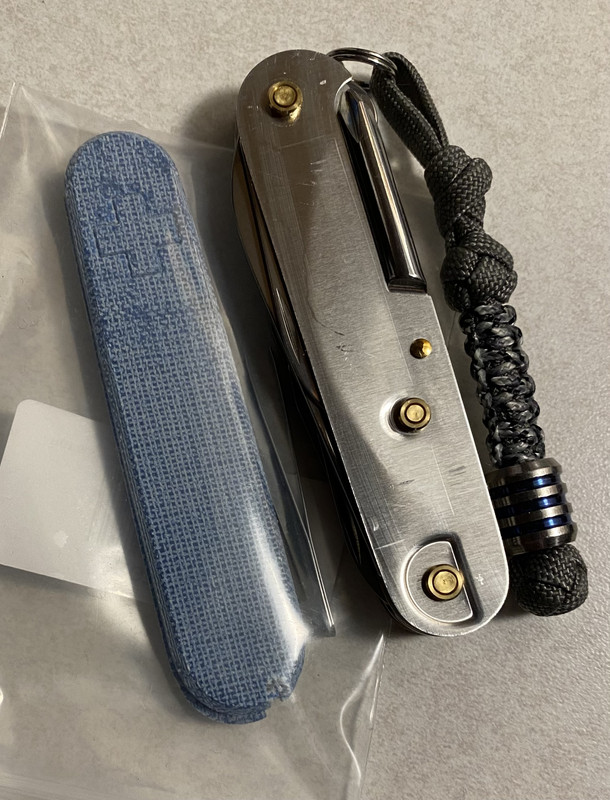

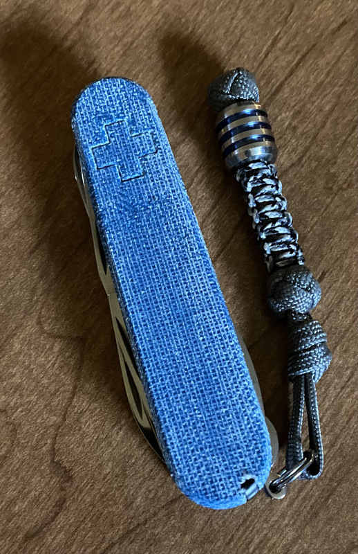

What are your initial thoughts on them?
I can’t comment on how grippy they’re going to be when wet, but they have a canvas micarta texture…the scales on my Junglas is the best comparison. I did try a little axe wax on them and they didn’t darken at all. The first pic is them in the plastic bag they arrived in so the dull look is misleading.What are your initial thoughts on them?
Thanks, something I'll have to keep in mind for future projects.I can’t comment on how grippy they’re going to be when wet, but they have a canvas micarta texture…the scales on my Junglas is the best comparison. I did try a little axe wax on them and they didn’t darken at all. The first pic is them in the plastic bag they arrived in so the dull look is misleading.
No problem. At $40 they cost more than the ST I put them on, but meh.Thanks, something I'll have to keep in mind for future projects.

I think the modified liner is a good idea. Victorinox does similarly with models like the Huntsman lite and I think the modern Campers. As for the alignment issue, I would tryy to test operation while squeezing the liners near the pins where possible to figure out the awl thickness issue. it might be contributing to the saw alignment issue. Modifying the front liner might be another way to accommodate the extra thickness. Use the awl like an automotive dolly and go to town like a dented fender with your ball peen hammer.What do you think? Comments/advice/suggestions? Do you think the awl will stop working so well when it is peened? (too tight from the extra 0.25mm thickness)
Oh yeah! Now that I think about it, a Camper would have almost the same exact liner that I'm making right now. The only difference would be the lack of a cutout on the back side for the awl, because the Camper's awl sits farther back behind the backspring for the saw layer. My awl is directly behind the liner, so my liner will have the cutout for the awl's nail nick. So basically I could've just taken apart a Camper and used that liner instead. All I would've needed to do is make the back side nail nick cutout for it. Cool.I think the modified liner is a good idea. Victorinox does similarly with models like the Huntsman lite and I think the modern Campers.
I've been doing that already. The tools keep wanting to pop out... especially the combo tool, so I'm squeezing the pivots every time I open or close something. If I'm honest I can't really tell anything from this. I think this is normal for an unpeened SAK.As for the alignment issue, I would tryy to test operation while squeezing the liners near the pins where possible to figure out the awl thickness issue
Yes, modern/recent ones have that liner. It is possible that a modern Mountaineer could be perfect with a cutout for the chisel too. I think I have one somewhere…I’ll try to find it and check. I don’t think you’d need the cutout, but I see how it helps access a bit.So basically I could've just taken apart a Camper and used that liner instead. All I would've needed to do is make the back side nail nick cutout for it. Cool.
I helps a lot, actually... at least if you have super short fingernails. The way the awl sits on this SAK makes the nail nick just barely peek out above the edge of the liner. It doesn't look right without a cutout and I don't know whether or not it is positioned that way because of the different spring it's sitting on.I don’t think you’d need the cutout, but I see how it helps access a bit.
It's done. I finished peening it this afternoon, but the scales have not been added yet.. All tools function with good snap and no side play.So yeah, it's pretty much ready for final assembly at this point.
