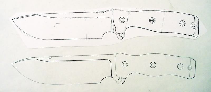

Yowza!!!. . . Either you guys are drunk or the pic that I posted is really screwed up. . . . I'll have to go with the pic.
The SARsquatch is so incredibly close to the initial drawing that I am dumbfounded by these responses :confused:. . . .
Only very minor modifications were incorporated after prototypes were made and problems with thumb ramp and palm swell locations were identified.
Here's the original drawing above a tracing from an actual SAR blank.
You can easily see that the palm swell was too far towards the butt end of the knife. Look at it in respect to the center handle tube. :eek:
We dropped the point of the blade just a fuzz as well in order to get it more centered with the handle.
IT IS A SABRE GRIND!!! The top of the grind stops approx 1/2" from the spine. It is a convex sabre grind. . . this gives enormous strength to a relatively thin 3/16" thick blade of such size.
The thumb ramp was also moved back a bit in order to facilitate folks who have thumbs that are less than 6 inches long! :eek: (Look at it in respect to the front guard hole)
SARsquatch Specs:
Blade = 7"
Blade width = 1 7/8"
Overall Length: 12 5/8"
Thickness = 3/16"
Coolness factor = Off the charts!!!

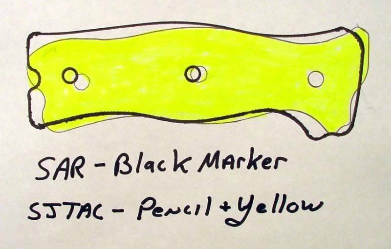

The SARsquatch DOES NOT have TAC handles. . . . They are a completely new design! They are, in my opinion, some of the most comfortable handles we have ever produced. Below is a drawing of both handles.
The SARsquatch is also nothing like a SJTAC. . . See pic below. .

Thanks for the perspective Jerry, I think it helps a good deal. I am glad to see a scale comparison with the SJTAC as well. It firms my resolve to snag one of these. I like your pencil drawings by the way. :D

Maybe because I've been a R&D 'guy' for over 35 years?? Maybe I'm more used to seeing the flow between concept, pencil drawing ... down to production piece?? :confused:
At any rate, the photos look like reasonable, small improvements over the drawing to me. I'll even admit that my thums are a bit shorter than 6". Of course, I'm going to get the chance to handle one at Blade, and that does make it easier.

You can see from the pic that this has been pasted together about 400 times and there are numerous erasures but in the end I think we have a really cool blade!. . . . The stock is 3/16" for lightweight carry and features a near full-height convex grind. The spine is flat and is perfectly perpendicular to the edge. There is a very small drop in the point that runs approx. 1 3/4" from the tip which you will note is only above the sweep in the cutting edge and therefore will not cost you any necessary spine slamming area. This small drop brings the point of the knife closer to the center of the blade while greatly increasing the penetrating power of the blade. The first ever thumb notches are planned for this blade and only ride above the ample choil (for gloved hands) and will add a bit of extra control when choking up on the blade. Their location will, again, not cost you any loss in spine whacking area over the straight part of the cutting edge!
The guard is extra long and will ensure that your hand never slips past it and onto the cutting edge. . . The handle is extra long features a flat faced hammer butt that is at an exact 90 degree angle from the centerline and cutting edge of the blade. This allows the maximum amount of energy to transfer to the tip when pounding on the butt of the knife. The lanyard hole has been recessed into the handle for protection while pounding and during other forms of heavy use/abuse.
(I bolded the only thing they didn't add in the final design.) Everything else is as Jerry promised sometime near Sadie Hawkins Day. In fact, I'm betting the tip is even more centered on the axis for better stabbing power.
