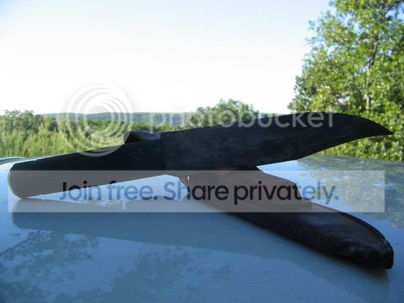

Now on topic, I made this knife in '86 when I was working in machine shops. I was really unimpressed with the knives on the market and did not have the bucks for a high end, so made my own.
We hade some O1, I think, and I milled flat a 1.250" rnd bar to .250 then gave it a clip point. I attached it to the hollow handle with 2 set screws tapped a little off so they wedged the blade in tight. The cap has an o-ring and is water tight.
This was my go-to for 10-15 yrs. it has chopped saplings, hacked through the rib cage and gutted,skinned and butchered more then a few deer. It has filleted fish. This thing never failed. it has a chip in the edge from some of the rib chopping though.
So I have put this thing through a lot of use and abuse and know first hand I can depend on this hollow handle SK.
I am not sure what is in the handle, (it is packed in the BOB now) but I do know there are paper MRE matches cut in half with the striker, some small hooks line wieghts, and thread. It has a whet stone pouch on the sheath.
I don't carry it hunting in the woods anymore, a Bucklite folder guts fine and wieghs less.
hope this pic posts, have had difficulty b4
