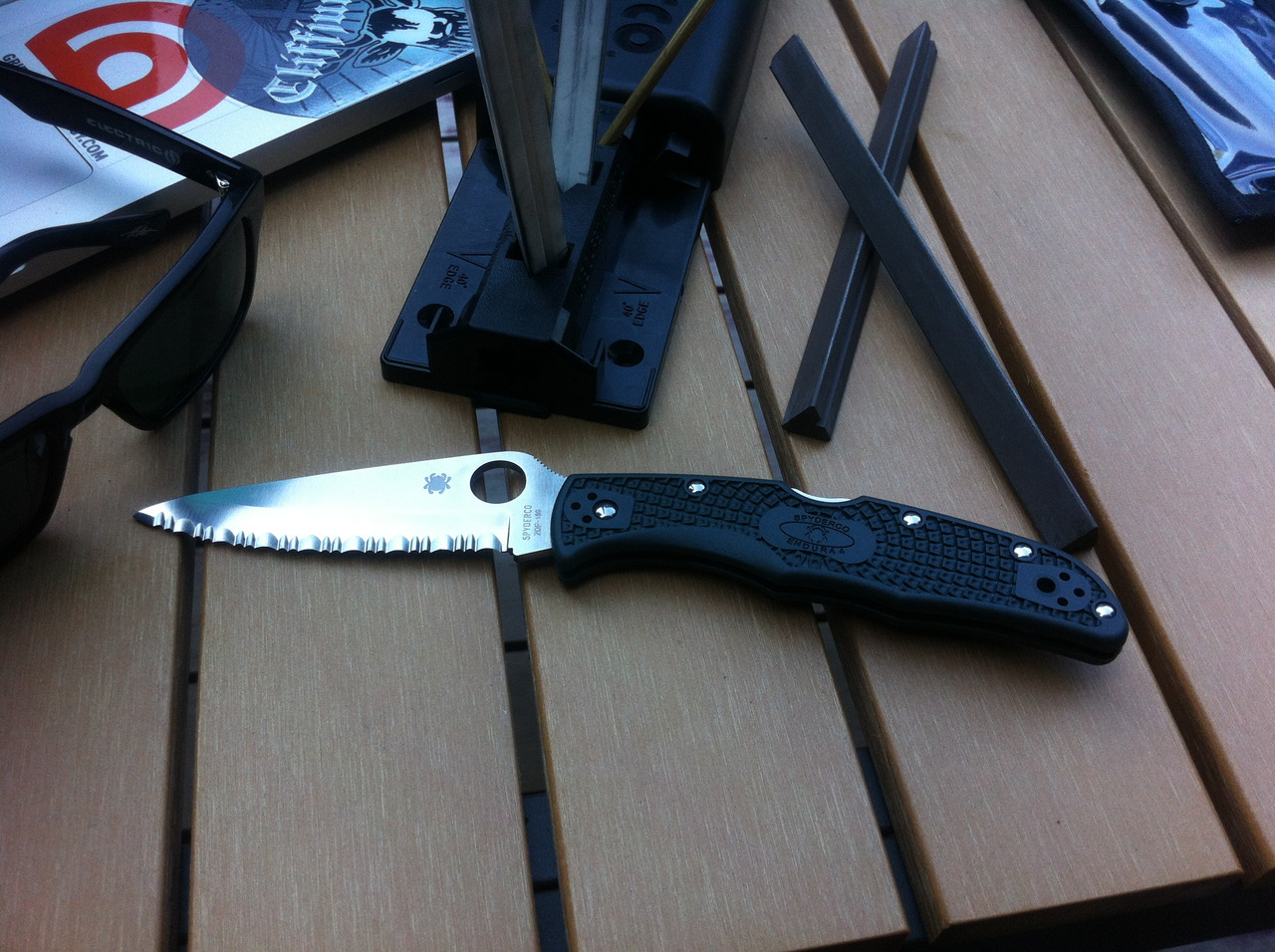

Well I warned everybody that I might do it, so here it is. The Endura that this thread made me buy.
Yes it is. I haven't had much time to test it obviously, but I've opened a couple packages today and it zipped through some shrink-wrap easily.
I have a feeling that this will be my new EDC for a while.
It's great steel. You'll love it! One of the few "exotic" steels I really enjoy.
Did you get that from W&W?
They're such a great supplier. I haven't actually been to the store(only purchased online) because I'm scared I might drop too much $$$ with all those toys on hand.
I'm a serrations fan. Nice knifeˆ. Used to have a serrated Delica in ZDP, but lost it in the library :(. Have a Salt 1 spyderedge on the way to replace it :D.
