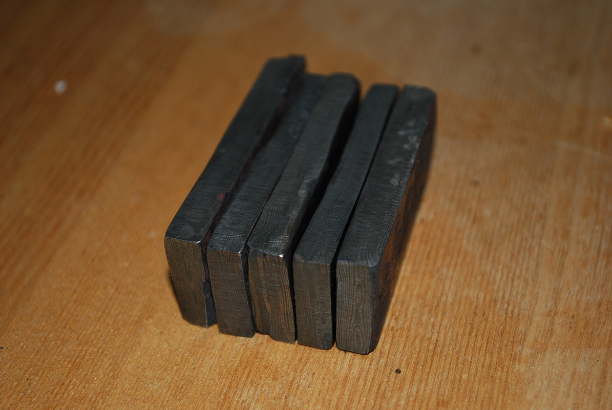

Id clean up the surfaces to be welded with an angle grinder or your belt grinder first.
The cleaner your weld surfaces, the more likely you are to not have inclusions and gaps.
Good luck!
Thank you for the input - that is the plan, already cleaned one side on all of them.
Thank you Sir
I am going to clean the 3 center ones on both sides really well, the top and bottom I will only clean on the welding surface.
Those look awesome!
Thank you very much Jesse, hoping they will look as well once they been smacked into a singe piece.

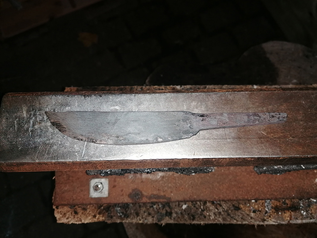

All right, it could prolly have gone better today.
On the other hand, how much do crack sell for these days?
I had a few delaminations happen, not sure if that goes under the term crack or not.
But it don't look like it's a total failure, atleast not to my beginner eyes.
There should be enough steel, to try to make a small blade.
Gonna forge the tang in, maybe move a little more steel towards the tip.

Got a bit of delaminations going on, worked some out I think and hoping the rest is more surface stuff.
Atleast it looks like it's heating and cooling evenly, with out dark areas or lines showing.
Got my blade hardend, without it pealing apart in 5 different directions.
Even the delam I tried to close in the tip, haven't cracked open.

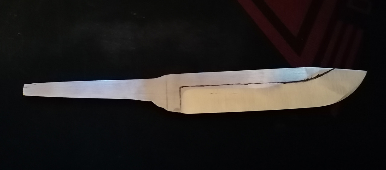

This is where im at now
Before you do too much more bevel grinding I would clean up the profile shape a bit on the grinder. Don't try and compromise with a slightly odd shaped belly. Get the profile looking right even if the blade ends up thinner or shorter. A smaller but well shaped knife always beats a larger but odd shaped bade.
Thank you very much, thats great advice sir!

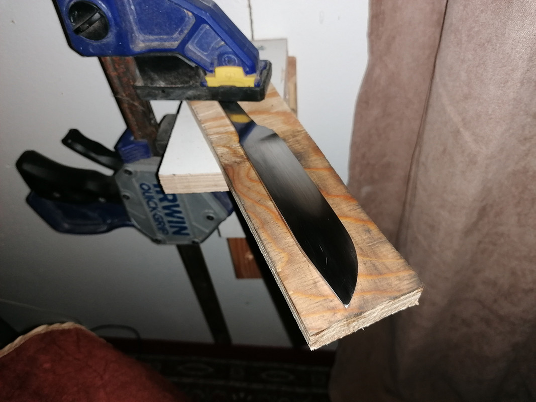

Grinding the hardend blade takes a fair bit of time, while keeping it cool at the same time.

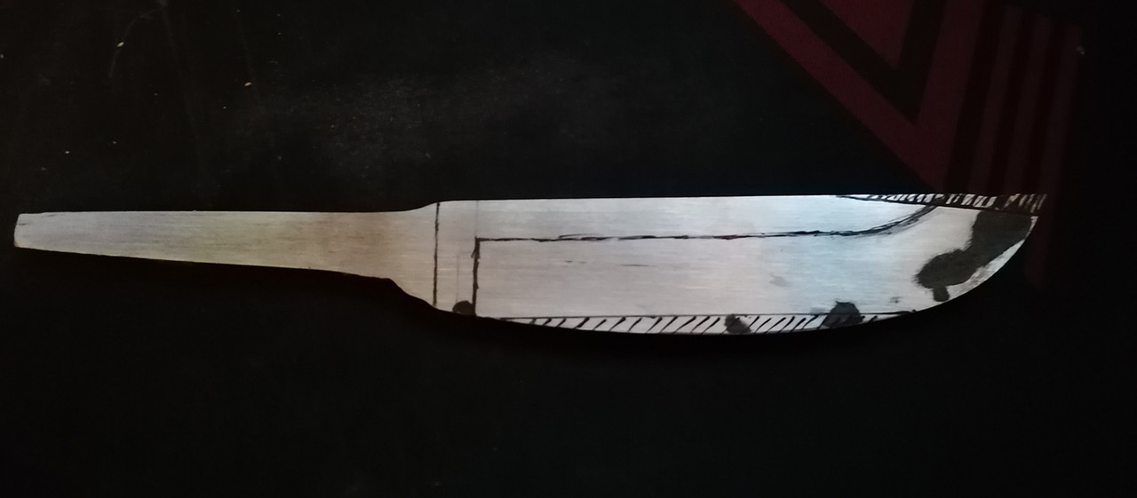

I still havent moved to adding bevels, so i've tried to scrible a little on the blade and would love some feedback on the profile.
If I need to change something, it would be great to know now.
That looks really good. It is exactly what I had in mind. Don't cut in the choil until after the bevels are ground. Sometimes things end up slightly different than sketched. In usually don't add it until the final finishing stages ... and you may end up not wanting it at all.
