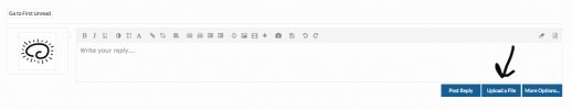

(1) Use the "Upload a File" button under the posting dialog box.
(2) Upload a pic to an image hosting service like Imgur and paste the link here.
(3) If the picture has a unique URL, put that in between "["IMG"]"URL"[/IMG"]" (remove the quotations).
Upload a file only works for people with paid accounts, I believe. Tinypic.com is pretty straightforward.
Use the Choose File button to select a photo on your computer, add tags or use resize options if you want, then click the green Upload Now button. In the next window copy the url and tags under IMG Code for Forums & Message Boards and paste that into your reply here.
