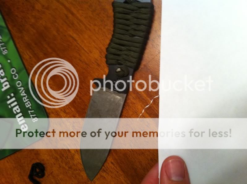

I'm no Murray Carter, But I'm pretty happy with the results I got this weekend on my BK11 using his technique
In all actuality this is a convex edge, I set the knife almost flat to knock down the shoulders of the factory edge, and then worked on the primary bevel. I took it all the way to the 8000 grit water stone and then hit it with a leather strop loaded with green compound, then bare, smooth finished leather. Even though I'm pretty happy with the level of skill I've achieved with free hand sharpening, I really want to get a belt sander so I can work on convexing large blades, and maybe make my own micarta handles for my BK9
