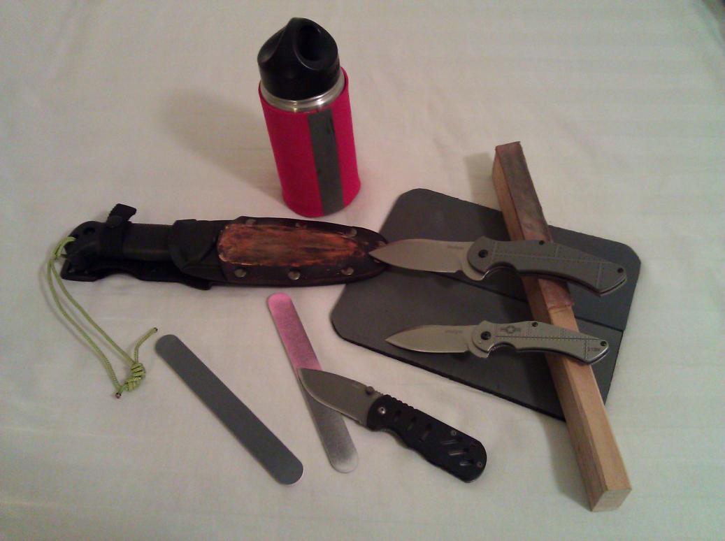

I wrapped some craft foam on my stainless water bottle to insulate it and glued a strip of 1000grit we/dry across the seam. BAM - instant strop, and on a cylindrical surface it works great on recurved blades too.

well... it's red, BUT it's the same craft foam I used to make holster patterns for leather, so... yes!
I should know better, pix to come.

Touching up in the field couldn't be easier.

looks like a leather boot over the stock sheath with maybe some compound on it..
exactamundo. Actually it's just screwed to one side, it doesn't enclose the entire thing.
I just use what I've got around.
Leather, No. 7 rubbing compound.
multi-grit Nail buffs (I got those from a "friend" - yeah, that's the ticket).
Old foam mousepad, wet/dry fine-grit sandpaper.
water bottle, craft foam, wet/dry again.
leather, leftover wood bits, more No. 7.
