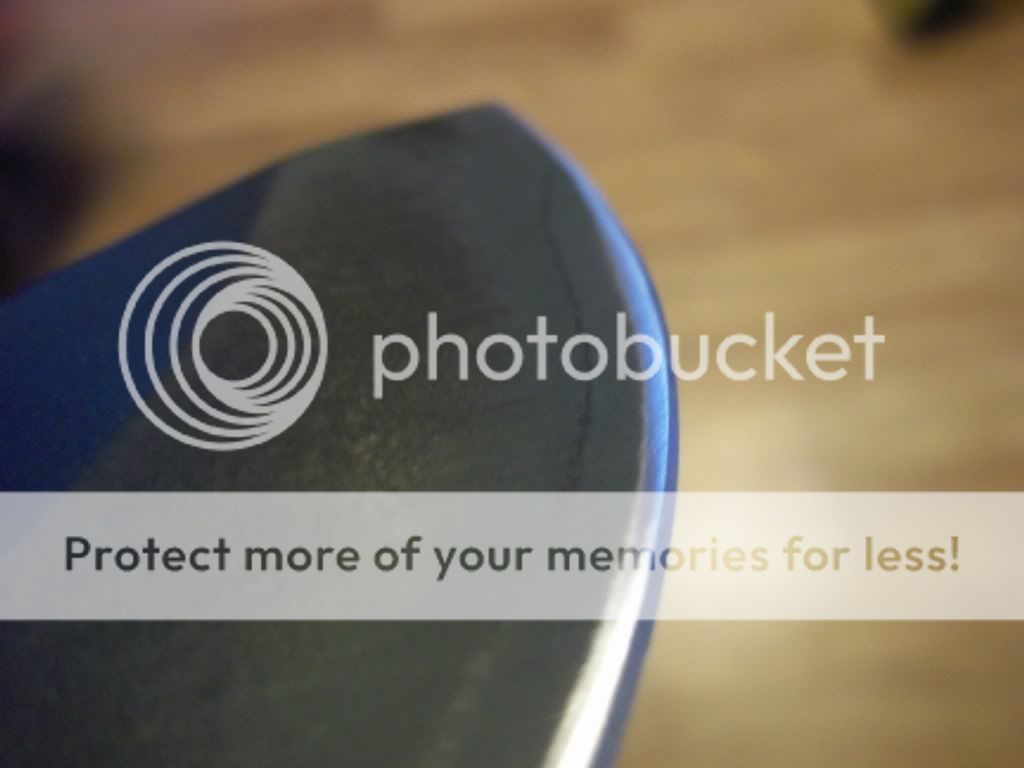

have you stripped your blade yet?
if not could you take a pic of the blade so I could see how much of the black coating has been removed so I might know what to look for while convexing?

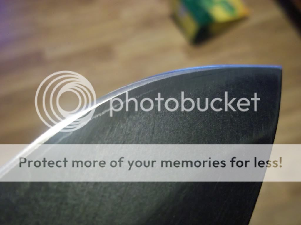

No, I haven't stripped the blade yet. I will get a pic up here in a second. I have some people in and out of my office that wouldn't like the idea of me having Winona out, so I need to wait until they disappear for a bit. Gimme a little while.
Okay, it is really hard to tell in this picture (cameraphone, sorry) but it goes to right under 2.5~3mm from the edge.
I think I am going to try to get it back to 4mm, then see how sharp she will get there. If not shaving, then I will take it back to 5mm, etc... until it is shaving sharp.
It will take a bit of work, but getting that smoothed down to a nice smooth contour should help at the end of it all. I think after I get a drill press I am going to look at a belt sander. Seems to be all the rage in convexing.
And it probably goes without saying, but as I move the edge further and further back, the angle I hold it at while "stropping" is going to lessen and lessen. I think that since it is not that far back, that is why I am not getting it good and shaving sharp yet.

Get your finest polishing surface with some give to it, and go as shallow as you can - you want to just polish the bevel towards the edge. BTW, it didn't even occur to me - I'm always dragging the knife spine first across the "strop" so the cutting edge is the trailing surface. It shouldn't take much. You should be able to use a convex technique on a V-grind too, without a complete reprofiling (but come on, you know you want the whole business!).

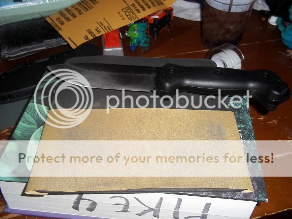

so far this is what my blade looks lilke
about an hour using 180 grit wet/dry
thoughts?
very Neanderthal strop, should be receiving some homemade strops from a guy next week to finish up the knife
