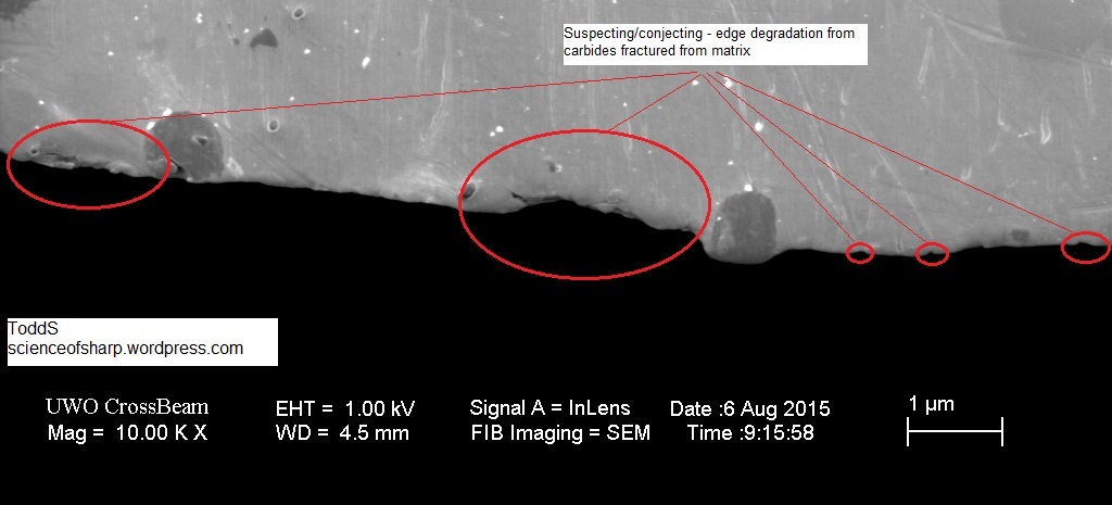

You didn't mentioned how exactly sharpen this S30V nor this blade hrc. Apex shows fractures. if much more stropping done, that extra proud on apex and smaller one next on the left are will be detach. Also look like many scratches lines created by detached carbides plowed the matrix. Strop added more variables and erase quite a bit of evident due to smoothing/erasing.
It would be great/cool if you SEM imaging this S30V (like pic below) after sharpened with 1K & 2K for SiC & diamond plate - 4 pics.
Spyderco S110V @62rc would be a good candidate for seeing affects of high carbide volume against sharpening abrasive.

Can anybody point me to a type of steel (or ideally a very small folder made of that steel) and a sharpening technique that SHOULD cause "carbide tear-out" ?
I've shown these images before: S30V sharpened with an aluminum oxide ceramic (sintered) stone and then stropped on hanging denim loaded with Mother's Mag polish (aluminum oxide). You can see the vanadium carbides sitting a bit proud, simply because they abrade more slowly than the matrix.
