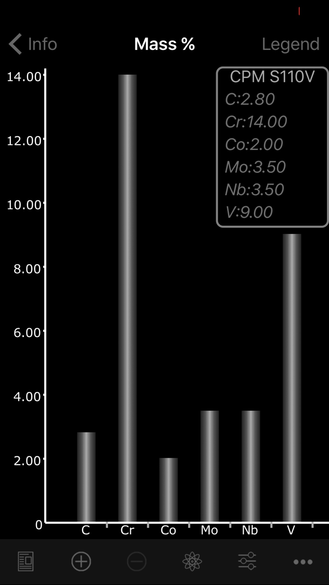

Have looked into the tech on VC, as a surface coating it can be in the neighborhood of AlumOx or just under SiC at the extreme low end. Normally it is much harder. The VC in PM steel tend to be 1-3 micron.
In my own experience I was gifted a knife of s110v at approx 64 RC, was one of Bluntcut's trial runs, so F&F was very rough. I took it to 120 SIC wet dry and it ground the surface/primary grind easily. I'm thinking "I'll have this thing beautiful in no time". 320 grit and still cutting fine, maybe a bit slower. At 600 surface finishing "ground" to a near standstill. Possible to sharpen at 600 and raise a burr but surface finishing not happening much. Switched to 16 micron diamond film and it began polishing up the surface again no issues.
Abrasives tend to stand about 10% proud, so 600-800 grit is about 20 micron, 2 micron gouge area. The carbides now able to fight one to one with the abrasives and in my experience it really shows. Have had this hold true on hard stones as well.
At rougher grit levels - 320-600 etc, I speculate the carbides fracture out, or at least to some extent are shaped by the abrasive, as 3 micron would be still too broad for good cutting performance at the peaks. Or maybe the carbides that are aligned with the grind path are the ones that remain and present a sharper side in the direction of the edge. In any event it is 100% possible to craft strong performing edges on these steels at low finish levels with just about any manufactured abrasive.
Whatever the reason, rougher SiC and AlumOx work fine on these steels, finer grades do not. Also, these steels tend to be run high RC, low 60s minimum, which will also make the rougher abrasive create a finer cutting edge/brighter finish compared to steels in the 50s.
If the VC carbides were like D2 and in the 20-30 micron range I'm not thinking they could be sharpened at all with anything but diamond or CbN.
Personally I find SiC to work better than AlumOx on HSS even at higher finishes. With Vanadium only super abrasives will do a quality job. I have gotten these steels to perform well enough or even very well off of SiC but is not as nice an outcome off of diamonds.
Even a relatively small percentage makes a big difference, that's why the latest version of my Washboard compound has 8 carats of diamond added. A small amount by weight but gets the job done in conjunction with the SiC - keeping in mind the entire thing isn't solid VC and the SIC will still work fine on the non-carbide areas.

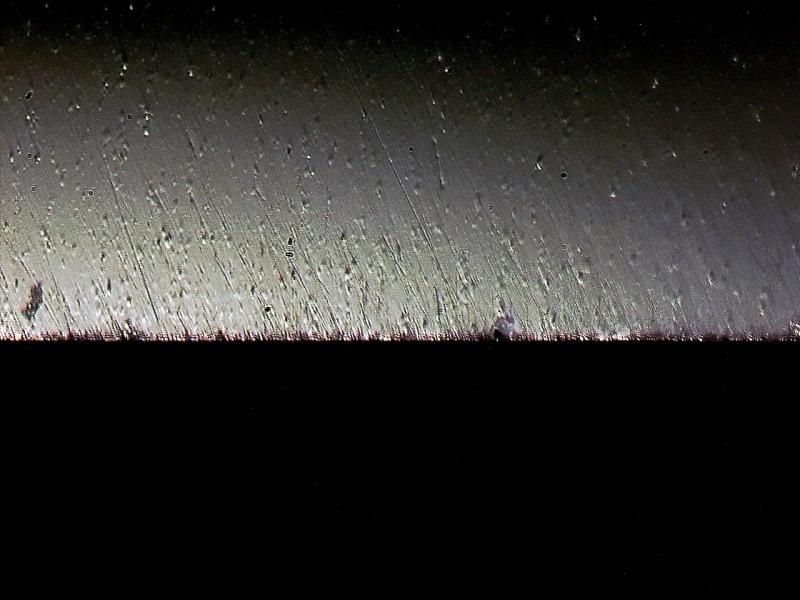

That's a good picture but you forgot the following picture. Pretty much proves the point.
Jason, before I attempt to argue or show that a phenomena is or is not happening and does or does not have a noticeable effect on edge performance, I first would like to clarify what the phenomena you are describing is. I posted that picture to try and clarify my understanding of what you are arguing is happening and whether the phenomena is the same one I saw described in that other thread. I was not, at that point, making an argument as to whether it happens or not.
That is why I did not bother posting the other picture: I did not think it was necessary for the purpose of clarifying whether the picture I did post depicted the same phenomena you were talking about.

steel_drake - you've good sharpening skills, thereby yielded higher apex quality than norm when using abrasive near its effective limit. Appropriate test might be whittle bamboo or raw bone with 12um, 6um, 3um abrasive finished edges. This might be impractical in real-life use but we/sharpeningnut like to dork until carbide (and along with chunk of matrix) fall/tear from edges just for fun.
btw - close up pic of spsii edge shows scratch pattern of std 30um abrasive or so, that was why I suspect new/sharp EF plate. I can't get anywhere close to that level of deep/clear scratch with green SiC 1200 grit on wood board (Do this for 10 stroke or so, since grit fracture extremely fast).
Thank you for the compliment. I am planning to use ~3um abrasive for the sake of keeping the testing from getting too extensive. Would you not expect slicing corrugated cardboard to reveal the effect? Should I whittle some bamboo or pine instead?
[/quote]btw - close up pic of spsii edge shows scratch pattern of std 30um abrasive or so, that was why I suspect new/sharp EF plate. I can't get anywhere close to that level of deep/clear scratch with green SiC 1200 grit on wood board (Do this for 10 stroke or so, since grit fracture extremely fast).[/QUOTE]
I will take some more pictures of the same knife with an edge off my SPS-II 3000 and 10000 for you as well tomorrow.

There is ~1% more vanadium in M4 and ~8% cobalt in HAP40 that is not present in M4,. . . Jason's assertion amounts to asserting that he can subjectively distinguish a ~1% difference in vanadium content between two steels by feel. I'll leave you to figure out for yourself how likely that actually is.
Yes but look at the dif in the cutting ability on Ankerson's tests. All I heard here for a while was HAP40 and when the testing was done . . .
yawn
and am I not correct in thinking that one of the advantages of HAP40 is it is friendly to sharpen similar to S35VN and that one of the things people note when talking about M4 . . . as a caveat . . . they say "but it isn't fun to sharpen".
Heck I don't know . . . I'm still trying to get a durable edge on S110V and that sounds . . . in retrospect . . . like saying "I'm still trying to get wet by jumping into a swimming pool" . . . should be the easiest thing in the world once it is sharp . . . but there it is.
I'm listening now that you posted the alloy comparison though.

Earlier I posted this image of a coarse SiC edge topology (and 1200 grit finished - weakened a lot of surface carbides)
This edge in use will loose weakened surface carbides fairly quickly however each tooth still is plenty large (10+um) and plenty of carbides are still embedded and readily sprout up when tooth's matrix leg receding from wear. When cutting has lot of draw and pull motions, these teeth will perform fine for cardboard & rope & etc..
Now, if performance measure by amount of steel loss and max loss thickness is limited to 2-3um, then this edge would fail rather fast.
400 grit SiC edge finished will be mostly coarse teeth (similar as pic), except number of weakened carbides will be mainly from plowed collision with carbides. Thus it would be stronger than edge above. Compare to 400 grit diamond, weakened carbides will be even less because some plow collision result in abrade/fracture certain percent of carbides. Easy to extrapolate to 120 or 8000 grit, corresponding to less and more delta (quality) respectively. Um... Jim abandoned polished edge(SiC in EP) in favor coarse edge because(of course, I am guessing) of this reason (a big factor) + normalize steel attributes + ..

I've shown these images before: S30V sharpened with an aluminum oxide ceramic (sintered) stone and then stropped on hanging denim loaded with Mother's Mag polish (aluminum oxide). You can see the vanadium carbides sitting a bit proud, simply because they abrade more slowly than the matrix.
