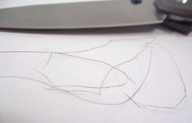

Damn you guys are good. While not perfect curls I was able to do this with my Insingo.
and this with my Manix 2.

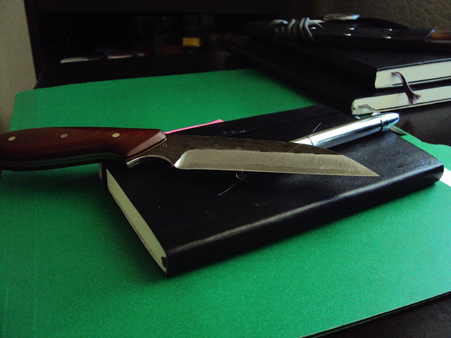

victorinox something.
after stropping on 6,3,1 micron pastes and then on bare leather it was even better!
attachment.php
attachment.php
attachment.php

butterknife. no joke

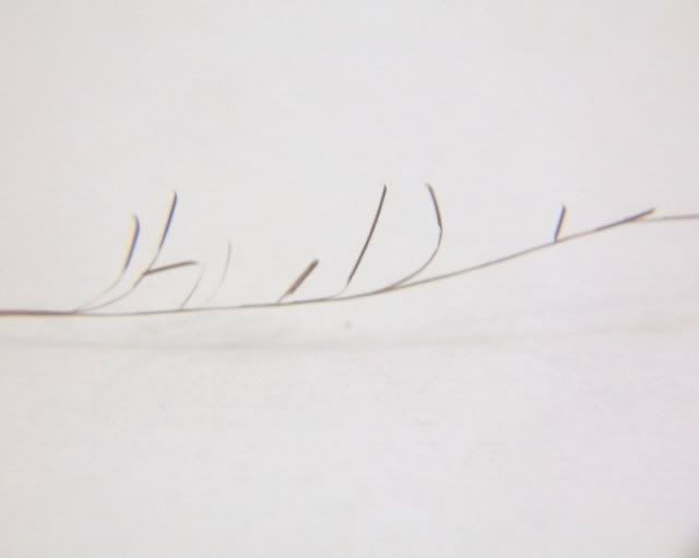

I learn how to whittle hair to have similar results as knifenut. This is not better sharpness but accurate careful whittling:
in less then hour I was able to do this more or less stable. I guess in day or two I will learn this trick better.
