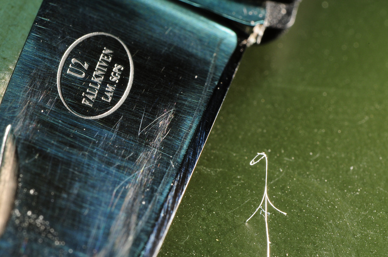

I find whittling is a nice check on sharpening and it has been interesting to see how different my various knives take the edge. They will all get sharp enough but my cheap Mora does it very easily while my U2 takes a very gentle touch. My best edges come from .25 micron diamond spray on a tensioned leather strop. I have played around with lots of stropping variations (wood, leather on wood, several compounds) but the best has been from pulling the leather very tightly using my bench vise.
In this photo I was trying to whittle a praying mantis figure :)

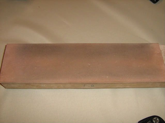

Have you tried MDF as a strop base? it works very well with diamond spray.
Welcome to BF!
I tried some MDF early on and it seemed like it picked up grit that would embed in the surface and create scratches on the edge. It worked great the first couple uses but once it got anything on it I felt I couldn't trust it any more.
I have a full woodworking shop so I have made several nice leather-on-wood strops to give me the flat surface for chisels and plane irons. I run the bare leather through the drum sander (sanding the rough side) to get the thickness exact. After gluing it to the board with waterproof glue, I soak the leather and clamp it as tight as possible to compress the leather as it dries. A light sanding with 400 grit paper, followed by leather conditioner gives me a surface that is very smooth but loads up nicely with compound. The result is a silky surface that gives great feedback and gives me very consistent results. While these are great for straight edges, I prefer the tensioned leather with the same surface prep for the curved edge on most knives. It flexes to conform to the curve and give a nice even pressure along the full edge.
On the other hand, MDF did everything I really needed, I just didn't like the harsh feel of it and started experimenting. I can't honestly say that my life has been measurably improved by my obsession!

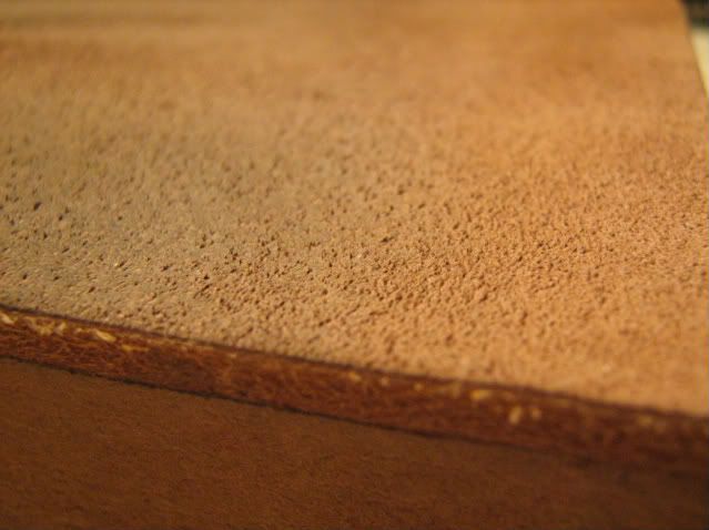

Using less pressure is key until the surface breaks-in, if you use too much pressure you will round the edge. Too much spray can also cause problems, 3 sprays is all that's needed to start and if you need more go one at a time. Once the surface has broke-in it will look more compressed and you can start using more pressure if you like but that only increases the convex effect and does not make the spray work any faster. I only have one peice of the bull leather now and it is coated with the 1 micron spray, it seems to make the diamond spray work faster plus the leather is very hard giving good feed back. I have been stopping with the bull leather and 1 micron spray because it is giving such good rusults I don't feel the need to go any lower.... unless I feel like having fun :D
If you are trying to polish a microbevel do not use the same angle as the microbevel go more acute. I would also give up on those lapping films and try some MDF.
I use all but the last half inch of the leather in this pic you can see the unused leather (right) and the used leather (left)

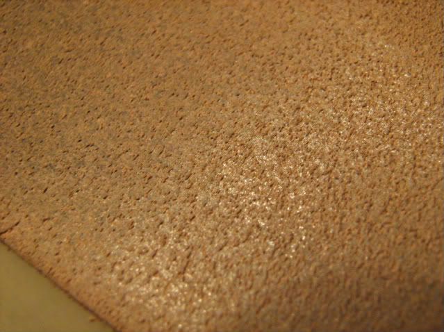

Here is a close up of the coated and compressed surface
The 1 micron and bull leather is all I seem to need, I don't have a use for a knife any sharper again unless for fun.
One more very important thing is you will also need to let the diamond spray go through its break in process. It does not take long maybe 20 or so strokes, its when the surface starts to shine is when they really start working.
