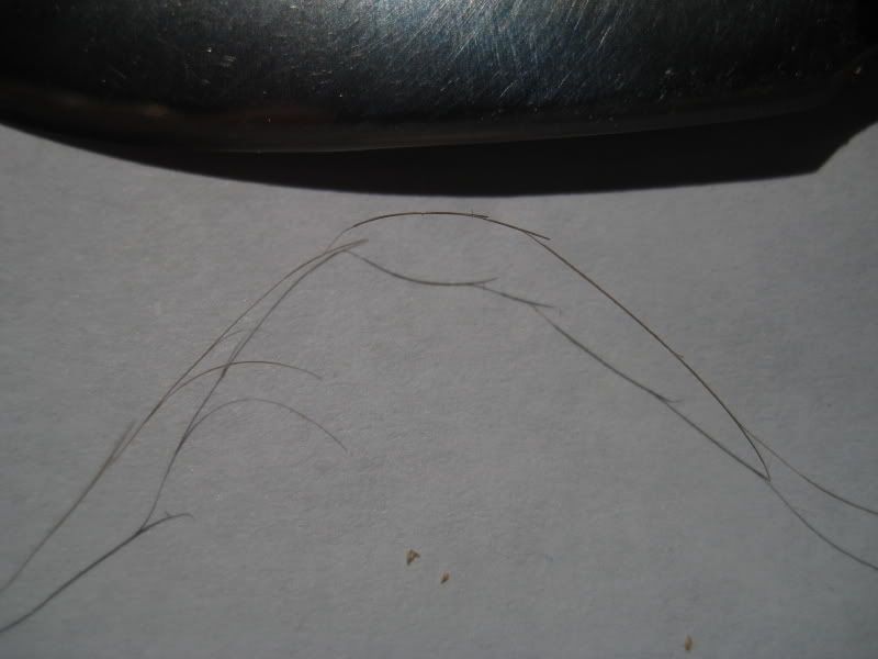

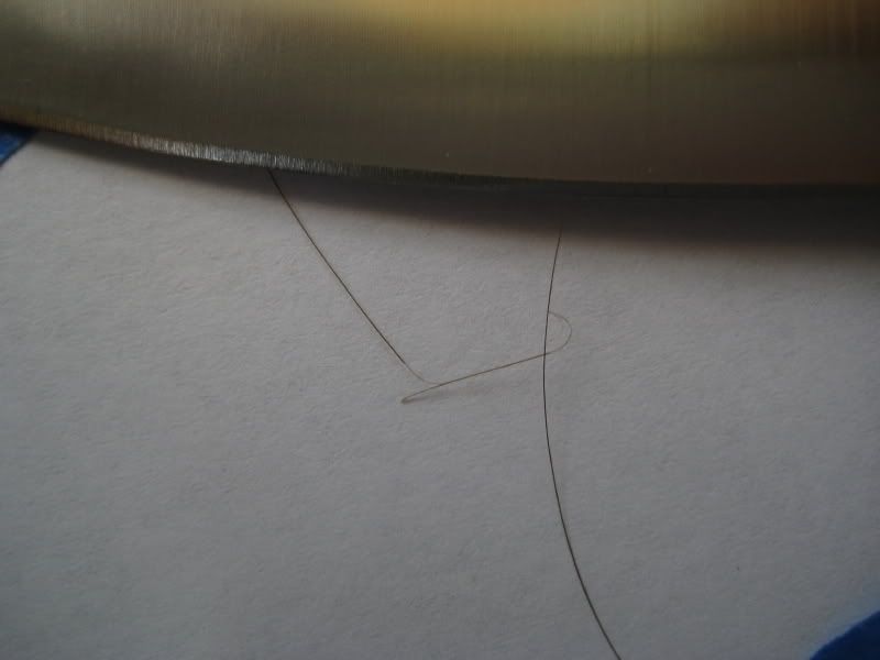

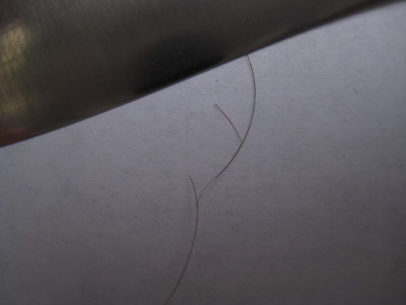

Here are a few more from today. Again, the hair was free hanging -- hanging straight down and held between thumb and forefinger.
Sharpening is simple -- Sharpmaker with ultra-fine rods followed this time with a few passes on a chromium-oxide charged leather strop. No expensive 8000 grit Japanese waterstones here.
Here's one cut by an A.G. Russell Woodswalker:
Here's one cut by a Spyderco ZDP-189 Calypso, Jr.:
One more for today, Spyderco UKPK:

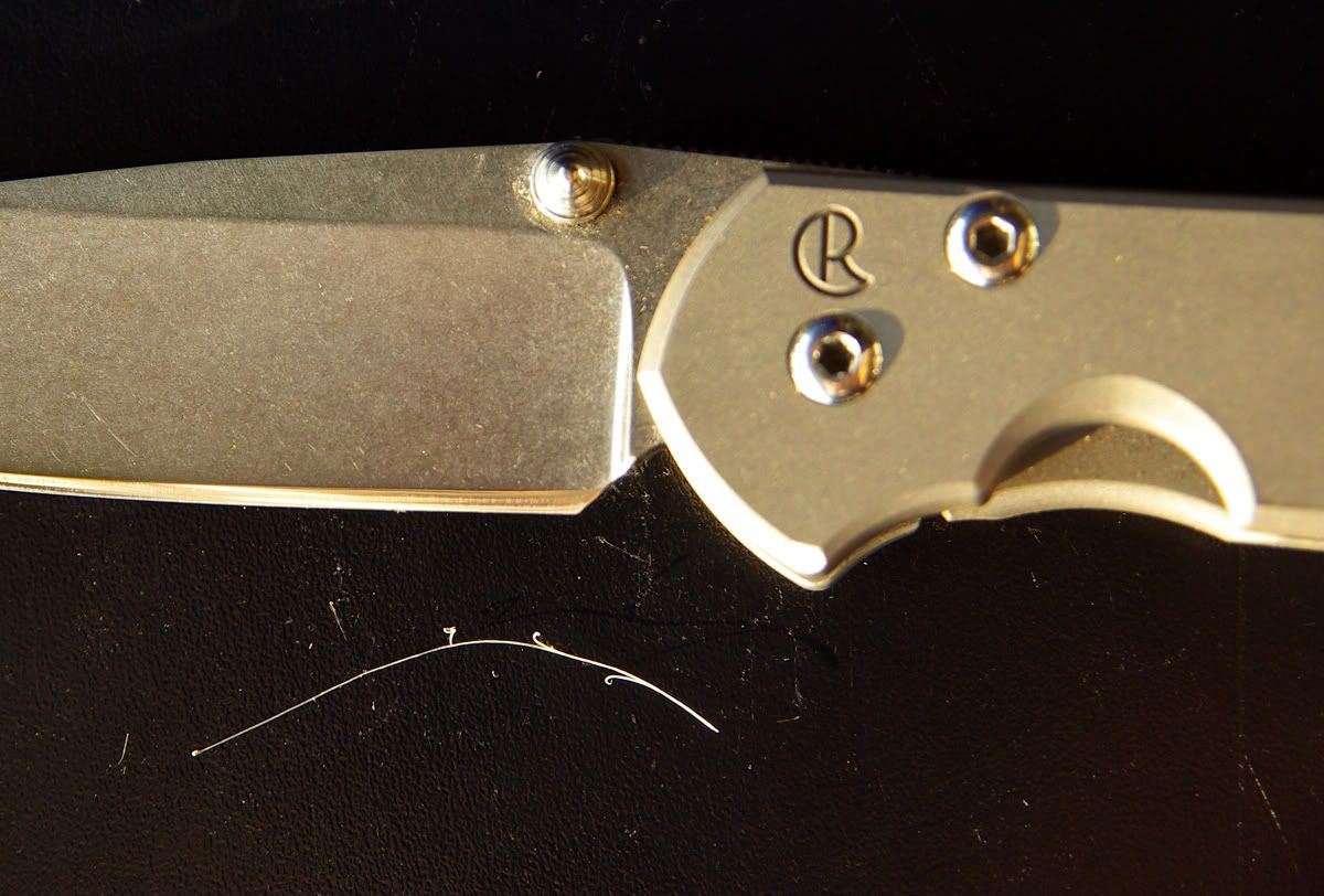

Small Classic Seb.
Thinned out and convexed with Lansky. Stropped on leather loaded with Flitz..
I prefer the Lansky for precision on small folders. You have much more control and feeling then with an Edge Pro. Edge Pro is for Big blades.

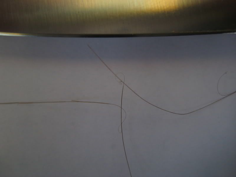

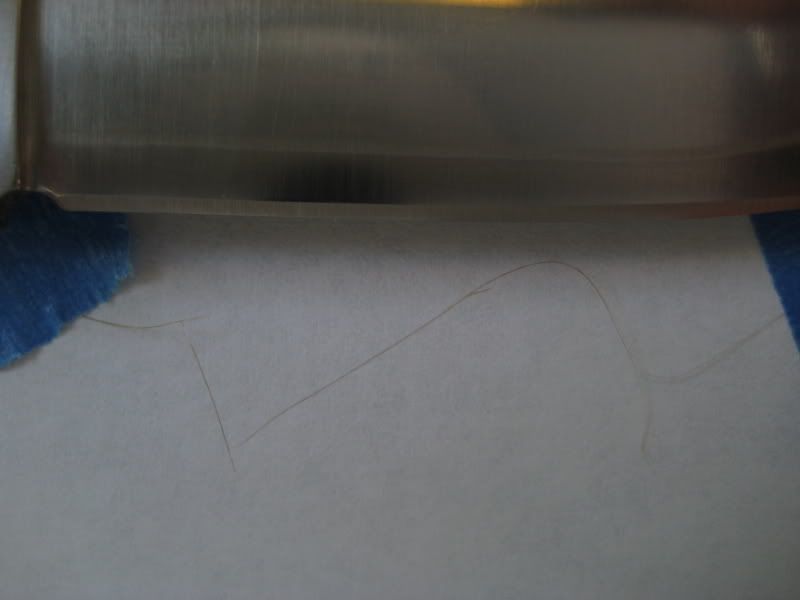

Here's a couple more I did today. Same sharpening method and conditions.
Bark River Mini-Canadian (A2):
1970s vintage Buck 110 2-dot (440c):
