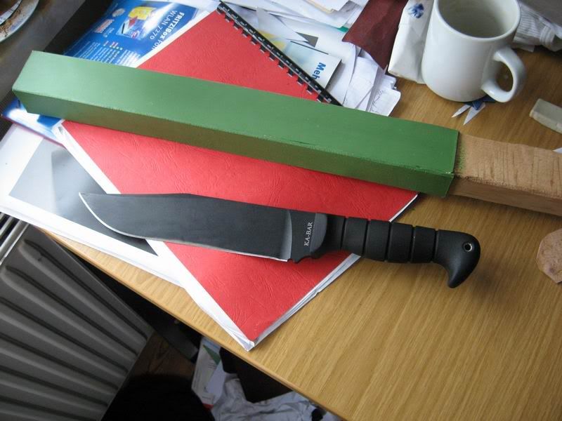

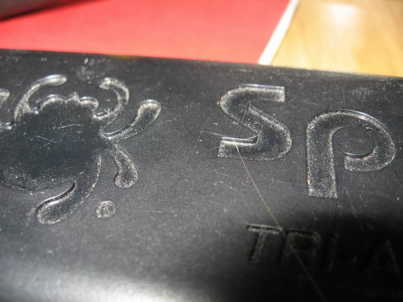

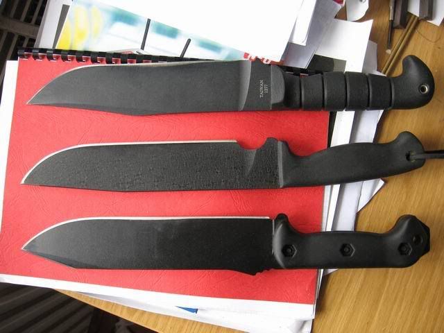

Just finished building my own strope (and it works :D ), I thought I add a little bit to this thread. And as there seem to be only few bigger blades, I tried hairwhittling with my BK-9 and my Heavy Bowie. I'm still working on the Battle Rat in this pic though.
And here are the results
The direction in which I tried to whittle hair was quite important. One way it worked perfectly, other way round? Nothing... Maybe I can get it to work both ways. Here's my strope as a final pic (it's green, so guess what I use ;) )

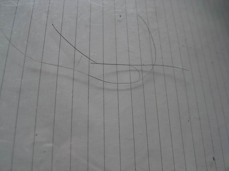

I did it . Hair whittling sharp. Used a magazine to strop it. I learned that trick here. The knife. Chicago Cutlery carbon steel boning knife. My camera isnt very good at macro . I hope it shows up.
