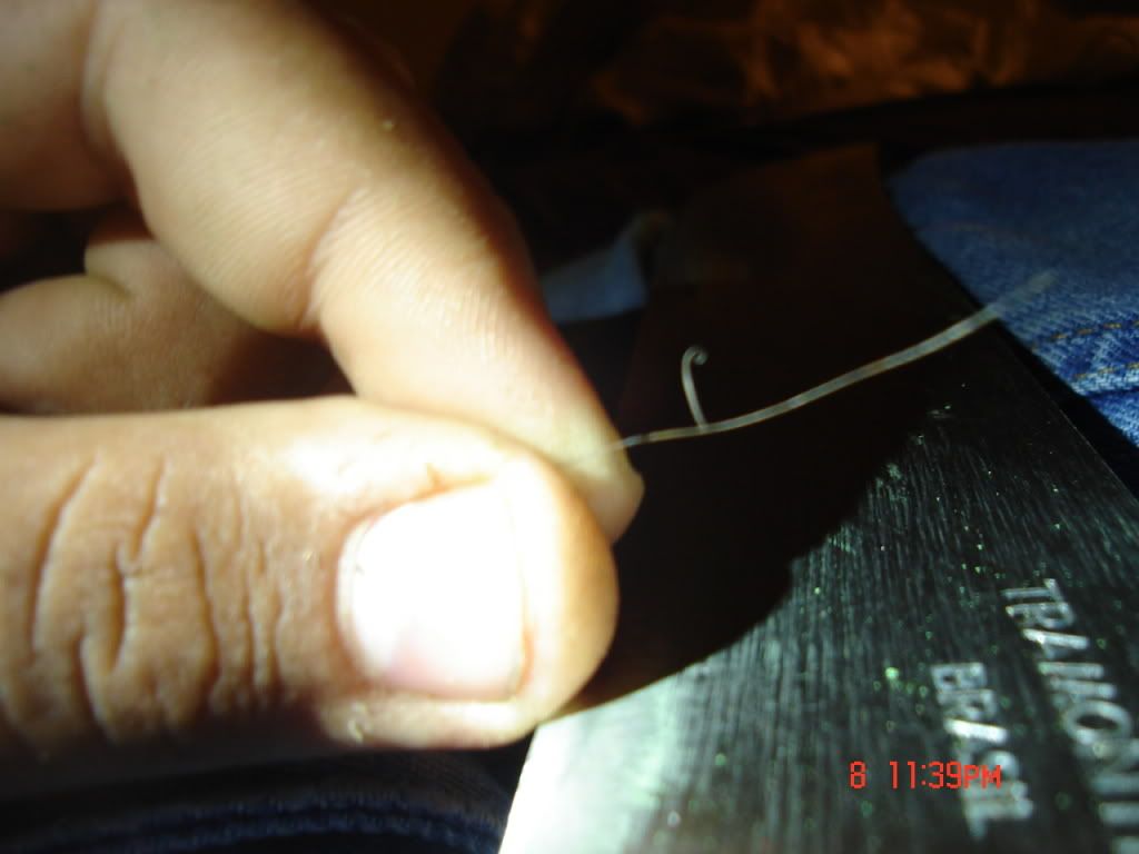

i got my tramontina 18in machete to hair whittle guit easy useing my new
1x30 in belt sander repofileing with 40 grit belt 80 g 120g the the convexed it useing 320g 400g and 2000g the strop loaded with brkt compound and i got these results

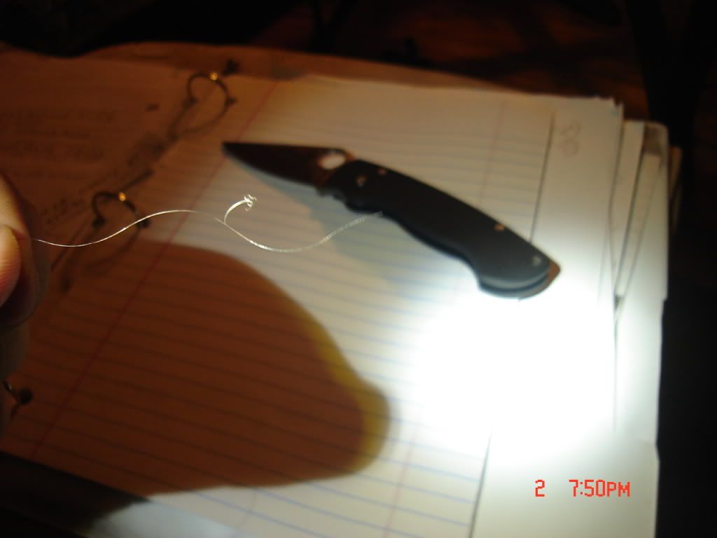

i got another one to hair whittle the one used today was my case full sized sod buster i reprofiled with a 1x30in belt sander with 120 grit belt then went to 220 grit sand paper then went to norton 1000/8000 grit stone the stroped useing brkt compound and these were my results

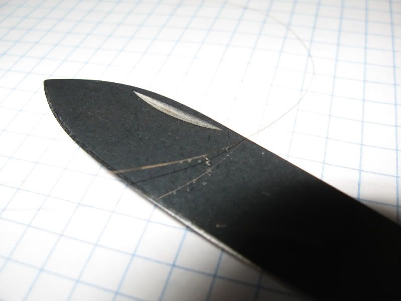

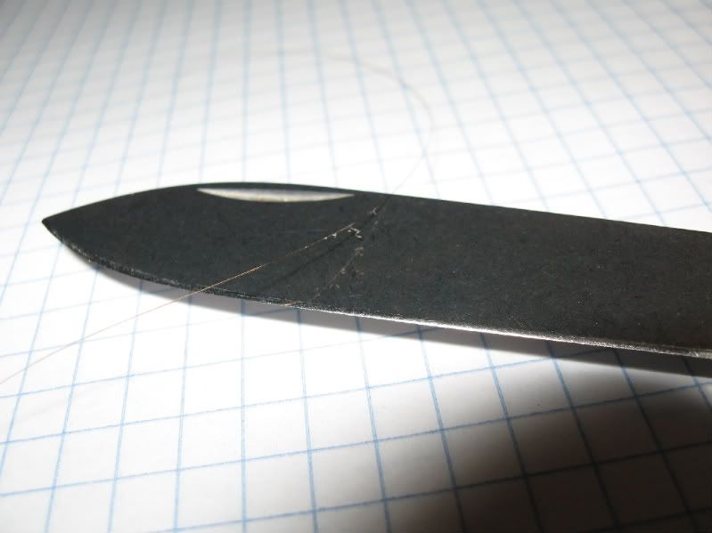

Factory edge on ZDP189 Endura.
Quite sharp, but the grind didn't cut how I like my knives to cut. So, off with the edge bevel!
:D
Thanks, it's been holding up real well. Once I have some more spare time I'm going to do a VG10 Endura that way and do some head to head comparisons of the two steels.
