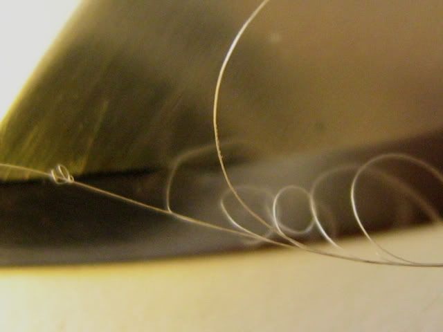

I sharpen one of my Bulat knives (from Ivan Kirpichev (Tver)) to whittling hair sharp.
It has huge carbide structures - it is actually property of Bulat to have inside steel some kind of network of iron carbides, something which modern metallurgy getting rid of to make steel as homogeniuse as possible with small grain structures. Bulat is different.
On this picture surface of the blade is in focus so you may see this Bulat pattern.
Point is that Iron carbides here is huge! Much bigger then D2 has and so it is steel possible to sharpen it to hair whittling sharpnes, which mean that carbides is also affected by sharpening and get sharp as well as steel.
Thanks, Vassili.

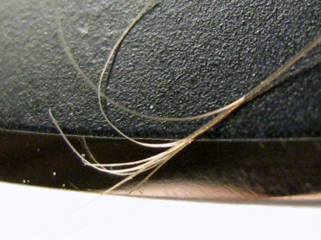

Finally found the macro setting on my camara and it works better than I thought.
Spyderco Mule team 52100
Spyderco Military S90V
TOPS CQT- Thunder Hawke N690Co, I call this one the house of hair:D
Those three were all sharpened with the DMT magna guide down to the ceramic (7 microns) then stroped with 1 and .5 micron diamond paste. The millie and the TOPS have both been touched-up on a spyderco UF ceramic bench stone the stroped same as before, I need to do a better touch-up on the millie...it's been sharper. I am sharpening a friends knife now completely by hand and if the results are good I'll post it.

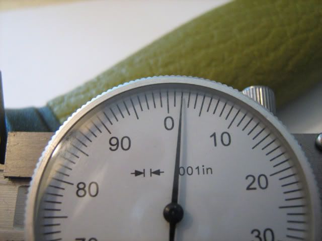

nozh, is there a record for number of splits? Knife used mora2000
measurement taken just above root
Look close that's 8 :eek:
Yes! You defenetely split it more then anybody else to my knowledge. I may whittle twice at same plece, but this is way more!
