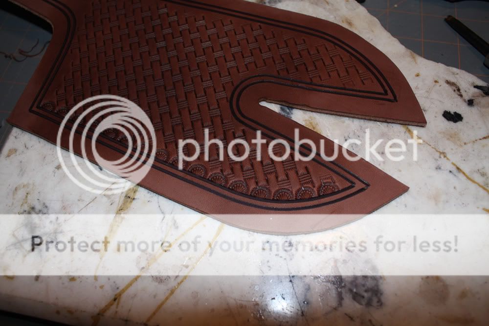

Now I am beginning my tooling stamp. I run it pretty close to the edge and try not to let the edge of the stamp run across the black lines. I bought the stamp a few years back, and for the life of me could not figure out how to make it look like a basket weave. I ended up asking George Trout at the Ohio Knife show and he happily showed me how to do it. It is easy now, but I really could not figure it out at first.
Here the basket weave is done and I am going to start the edging
This is the beginning of the edging, just following the black lines again.
The first round is done here I am going to add a little accent mark between the border tool marks.

Can you see the little triangles between the border stamps? It makes it look more 3 dimensional...at least to me.

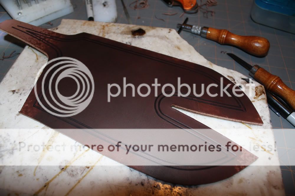

Ok, Here I am putting some Feibings leather dye. I use oil dye (also suggested by George Trout) I have used both the eco-flow, which ended up eco-flowing down the drain. It looked awful. Then I tried the alcohol based dyes and they were ok, but tended to leave streaks a bit. After I tried the oil dyes, I bought them in the large containers. I fortunately had a couple freshly emptied eco-flow containers left so I used them and just keep adding to them as they get low. It is easier to get the dauber into the dye with the smaller containers, but it is cheaper (in the long run) to buy them in the larger containers. On a side note, if you get some of the oil dye on your skin, it will be with you for a while. I got a little mark on my wrist tonight, that I can look forward to explaining to my students at school for the remainder of the week. I use the wool daubers, and carefully run it around the edge trying very hard not to get it past the black line.
I am getting ready now for the highlighter. It fills in the tooling and really makes it stand out. I recently decided to try some pre-dyed leather from Wickett and Craig. It is drum dyed a nice deep brown. The highlighter still works, but the contrast between the highlighter and the dyed leather is not as extreme as the contrast between the highlighter and undyed leather. It is, however, enough that I still use it and think it does make the tooling stand out a bit better. I keep a paper towel on hand because, as you will see, I put the highlighter on pretty thick and will need to wipe it all off.
Here it is all covered in the highlighter. It is really on very thick. I cover the whole sheath with a lot of the highlighter and once it is on, I wipe over the whole thing with a paper towel to take off the excess. This allows the highlighter to stay in the recesses of the tooling, and leaves the high parts highlighter free.
Last part for tonight. I bought a decent food dehydrator a while ago. I set it on low (which basically just moves some warm air) and put the sheaths in for about 1/2 hour or so to dry everything out.
