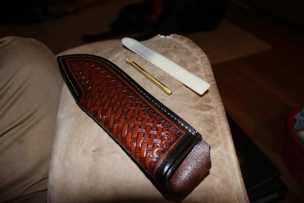

It holds up well. The leather remains fairly stiff, but I have not had any problems with it cracking.
Here it is getting ready to slick the edge. It is a plastic slicker and a piece of brass rod. It works well, I make sure I round the edges as much as I can.
Now I am done... Here it is.
What do you think?

Your stitch spacing is a bit off. Your work is so excellent otherwise, I think it might pay to take more care with the stitch, and look into using a sharp awl. I use a drill myself, but I don't work at your level of beautification. Other than the stitching being noticably mis-spaced. Very, very nice work. Check Chuck Burrows tutes on the stitching.

If you insist on drilling the holes as I do, go to a 5/64" bit. Much easier, and the leather closes in very well.
Yeah, that one stitch right in the middle a bit off. It does not look so prominent in real life. I jerked a bit and just drilled right through it, missing the layout mark by nearly half a space. I will have to try the needle in the drill chuck. I think I use a 5/64ths bit. I have been using the same one for a while, but I think that is the one.

Using drill press for punching the stitch holes, I suggest trying an ice pick like polished metal "awl" or a needle a little larger than you sew with, chucked up in the drill press. I always preferred to punch the holes with power off and no rotation, but be sure to lube the awl with common paraffin wax or bee's wax every few insertions. It will make it so much easier. Actually the way I did it mimicked the action of a heavy duty stitcher without thread. As you noted be sure to run a stitch wheel in the groove to space the holes prior to punching.
Artificial sinew can be tricky as it relates to perceived odd spacing of the holes. The tension on each stitch is really important, because if it varies much at all the stitch will give the appearance of being placed in unevenly spaced holes.
Another little time saver for you. I NEVER EVER put any tooling on the back side of a sheath. !. It will hardly ever be seen. 2.In the case of the basket weave you are setting yourself up for misaligned stamping on the two legs of the butterfly style sheath because of the center gap. ( in other words if you can avoid a problem before it has a chance to happen, that's the very best time:D) 3. It is the mark of a professional to know when to stop and based on what I see you are fast on the track of "professional".
A little dye on the inside of the welt edge BEFORE you glue it in saves a lot of time and frustration compared to dying it after it's inside the sheath.:cool:

Looks good bro - and the suggestions are money. I used to use a drill bit too - and now I use a larger needle for all of my holes except the first and last hole in my stitch sequence.
Also - why not stitch the back for the belt loop - instead of rivet it. It is easier of the knife - and matches the stitching on the sheath. Also - why not dye the inside of the sheath rather than leave it neutral.

I think the tooling on the front and back is classy and sets your sheaths apart from the common one sided pieces. I see the sheath as a complete package and whether it is off the belt or not, I want every aspect of it to be finished. For that same reason, I opted not to get the Tippmann. I don't like the look of the unfinished holes it puts on the backside. I used to just drive the needle through in the drill press, too but found that I got better results with it spinning at high rpm's.
I also have to mention that I think rivets are the way to go with the belt loop. I have seen too many stitch-only connections ripped apart to convince me otherwise. The same goes with a couple strategically place rivets on the welt. Again, this is purely from my own experience and testing but that is all I can truly trust, right?

No Rick, it's all good. I'm always ready and looking for new ideas and methods of doing things. That how I managed to grow a little since 1951 when I started this leather thing. I must admit I'm not a fan of rivets or anything else that puts metal inside the sheath. That's why I fully line every sheath I make, but back to the point.....Nearly everything I know I learned from someone before me in line and I'm always ready to learn some more.

For instance - I now have a chunk of beeswax next to my drill press to wax my needle as I make my holes for my stitches - it has saved me a ton of time and makes a better end product - it was just something Paul mentioned off hand in a recent post.
