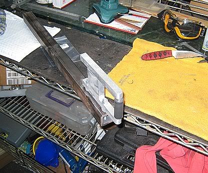

Can you share a picture of your small wheel holder, AVigil?
Here you go. I chose the Bader wheel because you only have to drill a small hole for the shaft unlike the others that use the bearings for attachment.

Thanks for sharing, Avigil! Where did you get that wheel?

I got it from Trugrit they carry a bunch of sizes. They even sell the fork holder for wheel if you need to buy one. But making one is very easy.
When you order be sure to clarify which wheel style you want. They sell both Bader and the other kind with the bearings on the outside.
