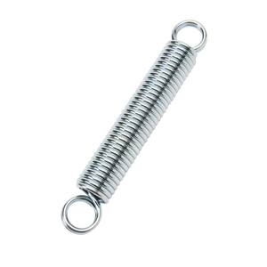

Ed Caffrey did some mods that make sense to me.
He used the rear hole in the tensioning arm and then used a compression spring.
This provides more leverage to the tensioning and may help tracking.
Home Depot and Lowes sells springs. Forget the screen door spring. That is nothing but a problem that wastes time being solved. I put on a 69lb spring from Home Depot and it keeps the belt nice and tight and tracks straight as an arrow with zero lateral drift. I see a lot of guys using springs that are not strong enough and struggle with tracking.

I saw some posts that I can't find right now.
I tried a compression spring on mine for a bit, but I couldn't find one that gave me enough travel to facilitate quick and easy belt changes. I am still playing with springs on mine, trying to find that perfect mix for me. My bad arms don't help much though:o I have been thinking about extending the tension arm a bit to make it easier on me, and still get good tension

I noticed the assembly instructions said that placement of the eyelet that attaches the spring to the main upright would vary based on the specifications of the spring. I've ordered the 69 pound spring mentioned by AVigil and will pick it up later today. Should I assume that the spring is installed slack at the highest position of the idler arm? That's what I'm assuming for now, anyway.
