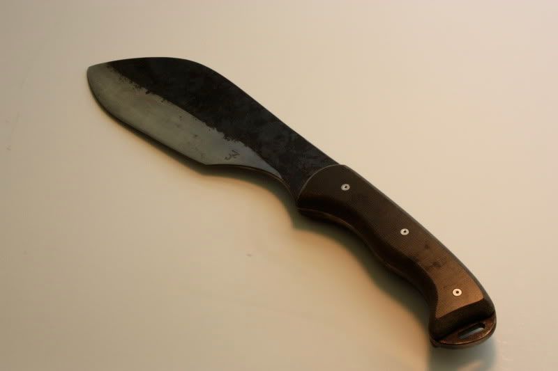

damn that's a slick knife Joe.
Thanks Buddy I should have it this week

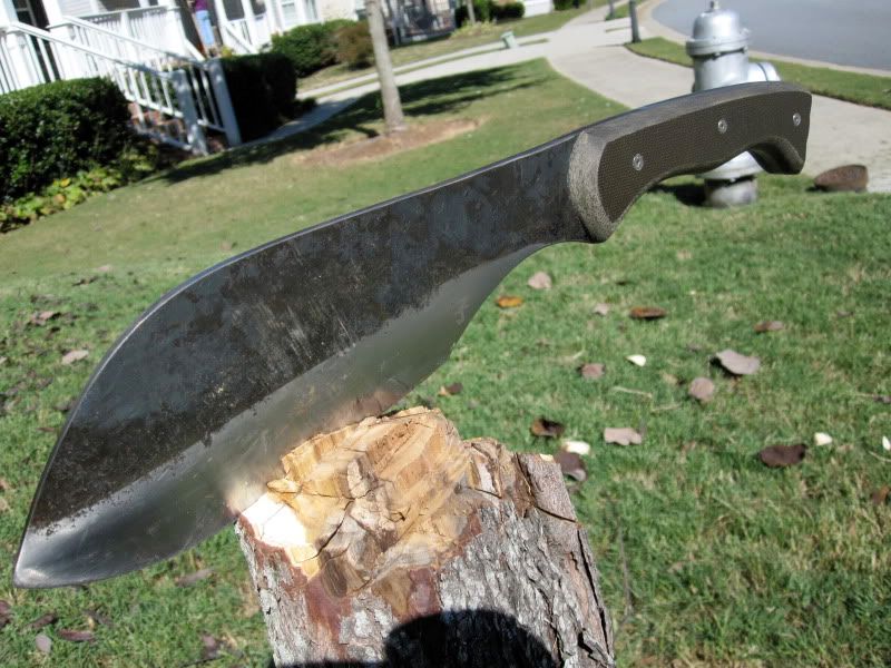

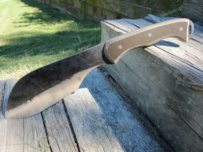

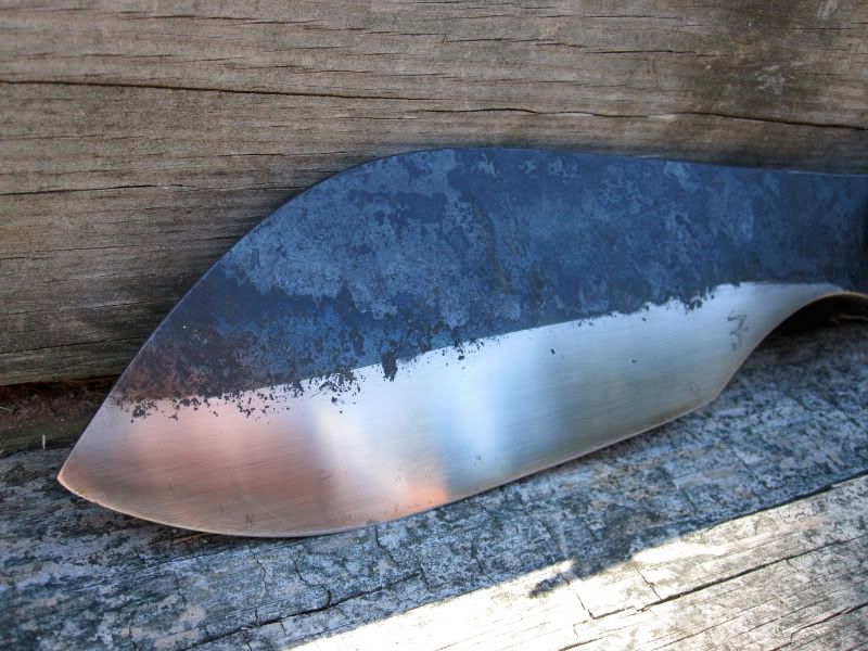

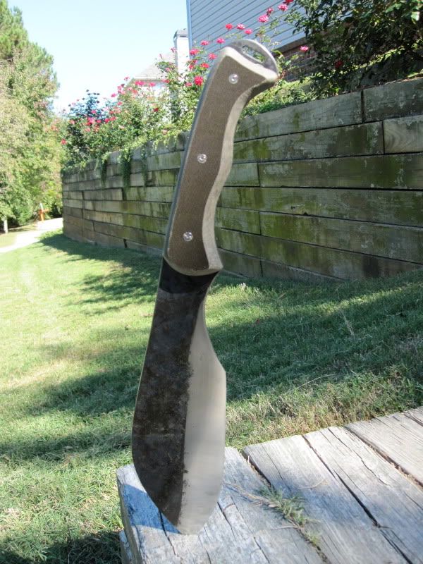

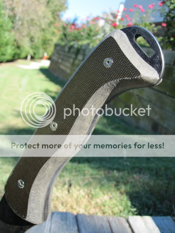

Here are a couple of my firebreaks with the new field finish I have started doing. I began bead blasting the blades at a customers request. It turned out so good I decided to offer this instead of the "normal" polishing that takes hours and adds hundreds of dollars to the cost. The bead blast actually accentuated the Hamon and only slightly affects the hardened portion of the blade. This finish is much easier to do so I can keep my prices down to were I feel a user should be. I can also refinish this blade much easier than a "normal" polish.
Please excuse the hot spots but it was the only way I could get the hamon to pop.
Thanks for looking
That Burt Foster is a screamer.Very cool. Just don't take it to a cutting comp as some will make fun of it. Ask me how I know.
