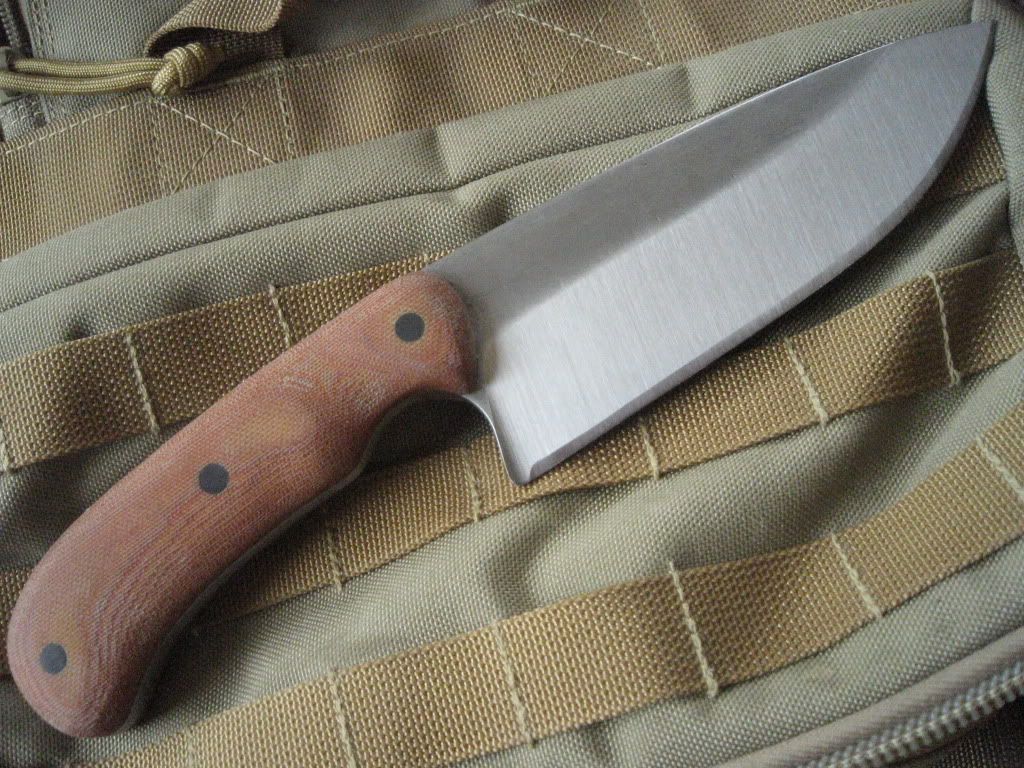

Here's my entry:
.25" thick 5160, through hardenend
6" blade, 10.75" OAL
.375" thick natural micarta scales with carbon fiber pins
Finished this one a few weeks ago, and have since used it to do a fair amount of wood cutting and chopping. It does a hell of a job on a 2X4.

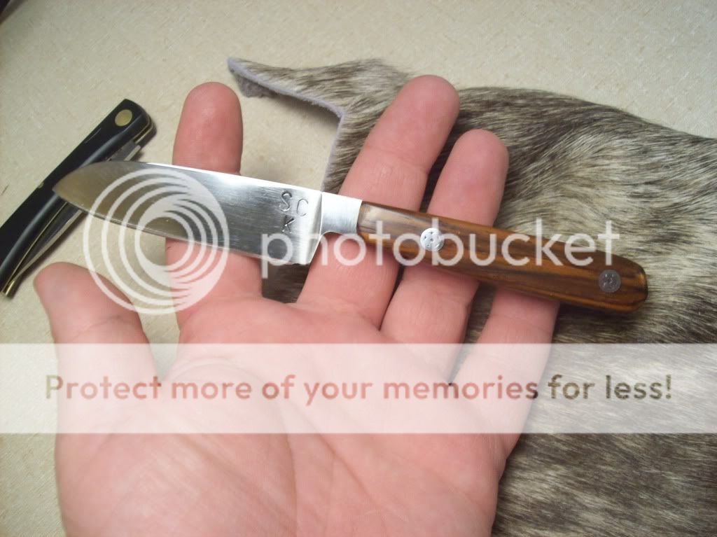

Still looking for the perfect Camp Knife.
toothpick chopper- now there's a whole new category!:D

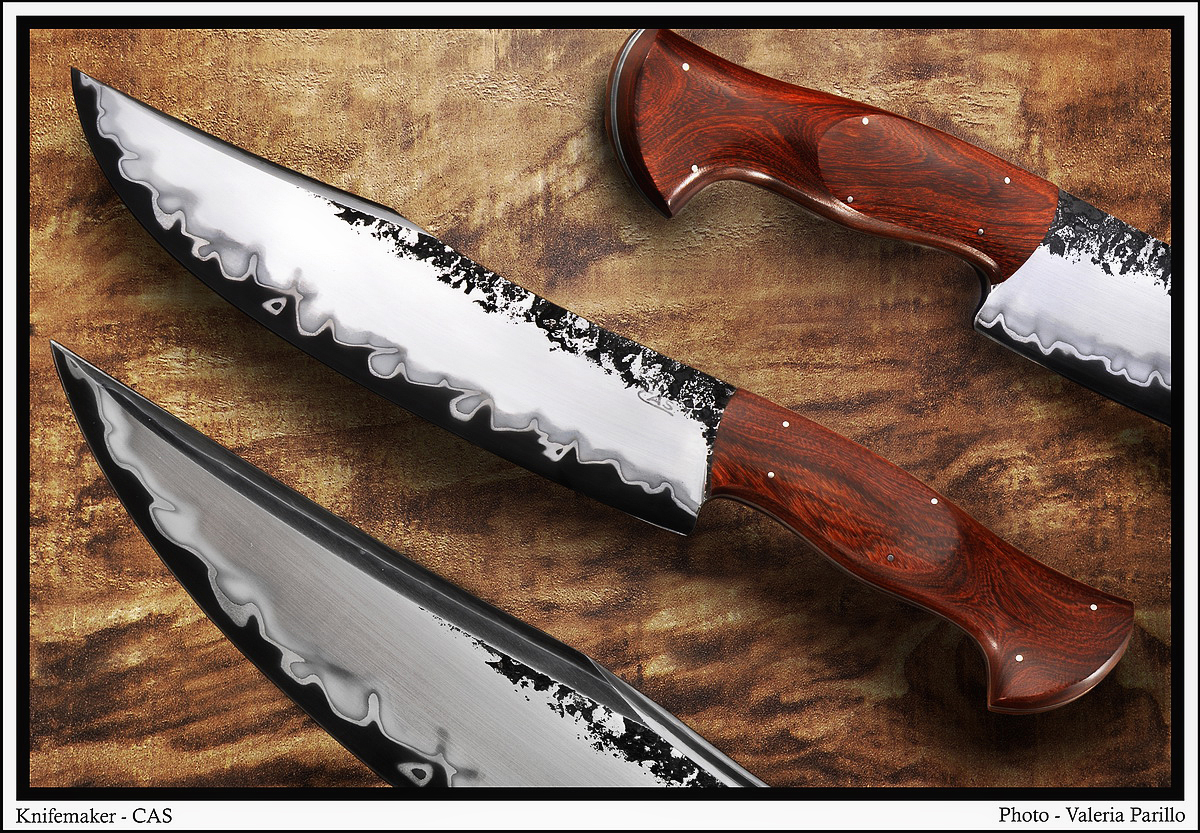

I just finished this one up, Ready for testing this spring.
Specs:
Steel: 3/16" O1
OAL: 15.5"
Blade: 9"
Handle: Tan/OD/Black G10
Pins: 1/4" Mosaic, Tube, Micarta & 1/8" Tube
Sheath: Leather
Misc: Tapered Tang, Differential Temper, ReCurve
and with his little sister

gorgeous, Claudio.
That looks like a great knife, Claudio. I'm sorry if it's just me, but I think somebody did a dis-service to your knife with a radical amount of Photoshop adjustment.
