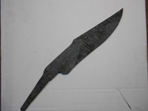

It is part of a trade we are doing. Sam asked me to make him a knife in my style following his design. We agreed he would make me a knife in return.

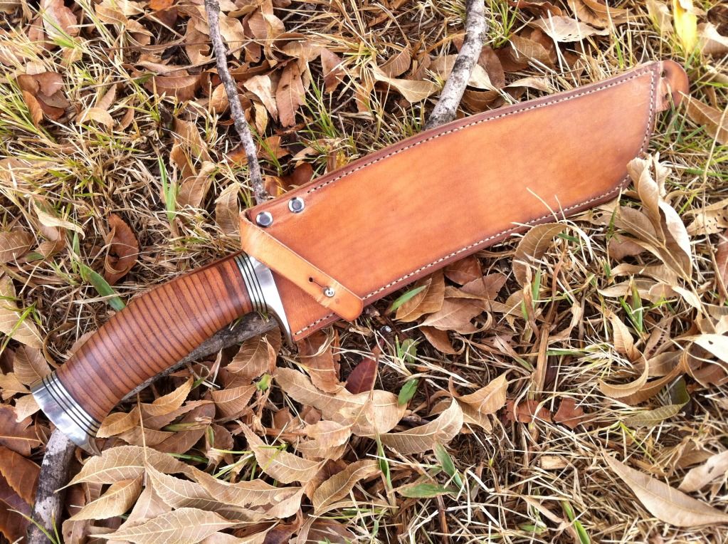

Here's one I made for a milita member. It may only have a 6" blade but it can chop. Made from 3/16" ATS34 chisel ground. Sheath leather over kydex and is MOLLE compatible. Sorry about the long exposure.

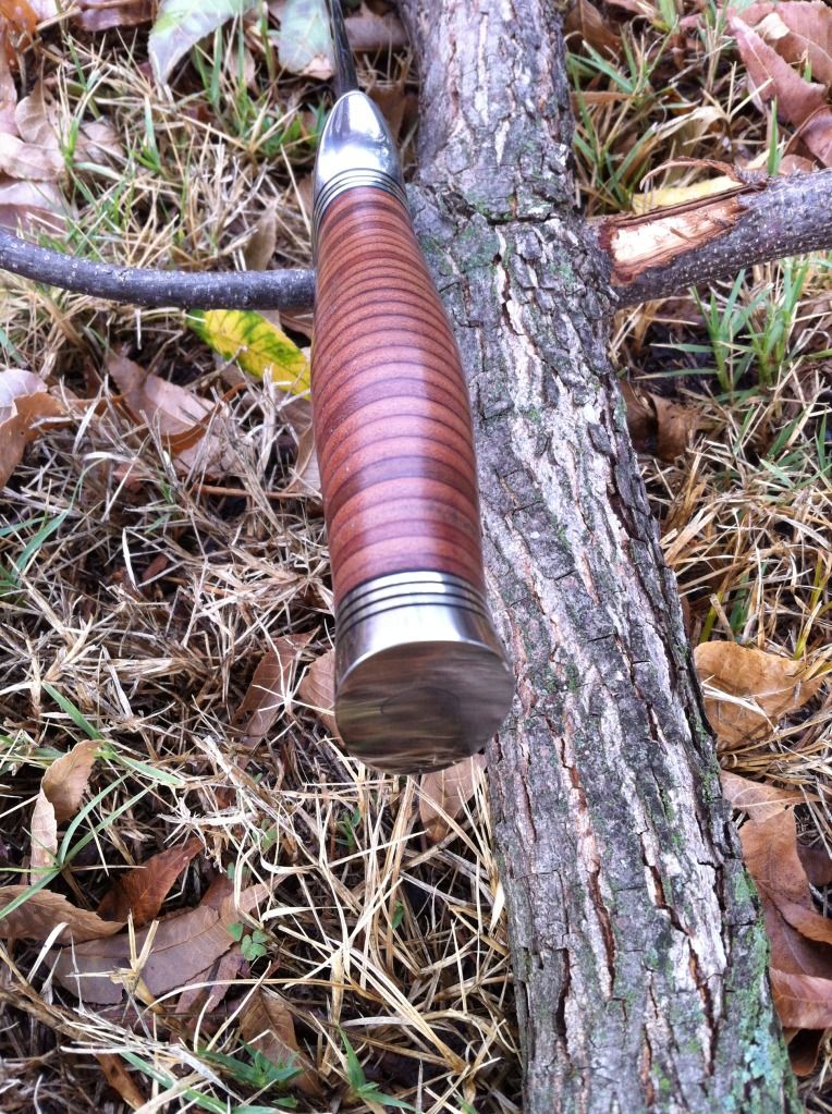

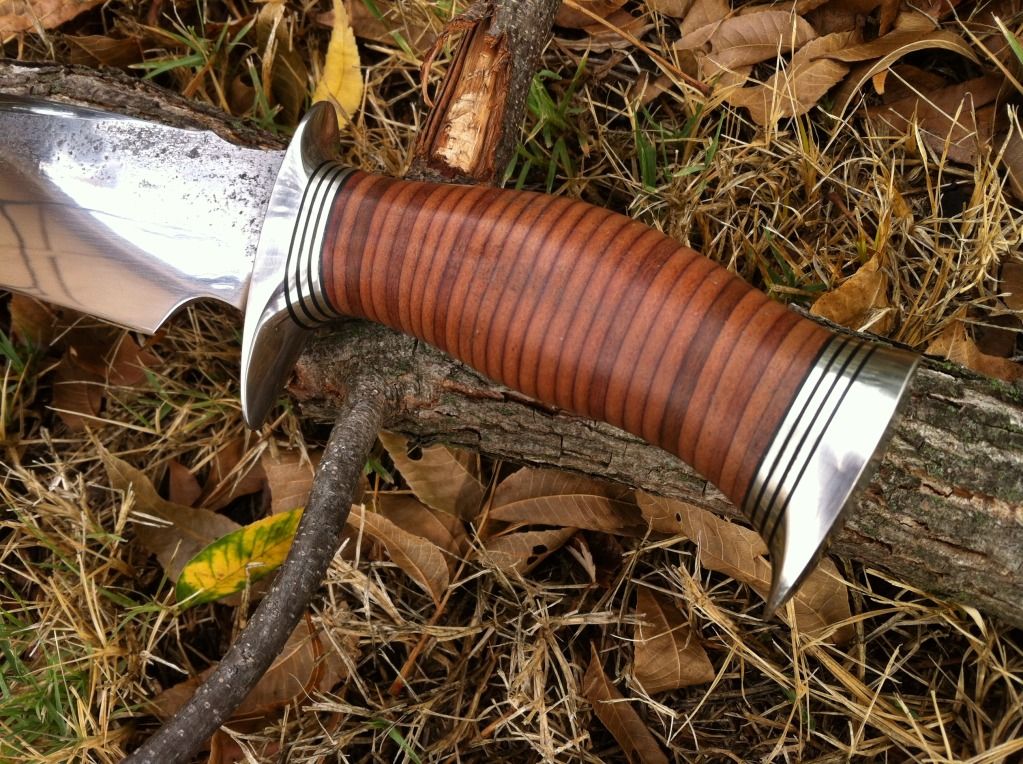

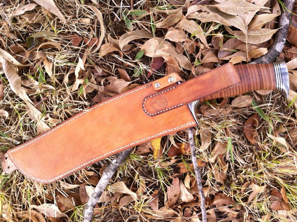

Received this one a couple weeks back f/Giedymin, a maker here on the forums. It's a big-un... ~ 11" blade and 5" handle. Feels great in the hand w/the stacked leather and curved pommel to keep your hand in place w/swinging it. Not an overly thick blade (~ 5-6mm) but it balances nicely and cuts well. Chopped up a few downed fresh pecan branches this weekend and the edge and blade performed quite nicely! A nice leather sheath as well... :)
^ Rick... That is Bad-@ss!! Really love the way it looks & I'm sure how it function.
Details/Specs on it?
Thanks, man.
Da specs....
L-6 (RDS) from Aldo
.280" thick
15.75" OA length
9.5" Cutting edge
6" Handle
Shallow convex, almost flat ground.
Cold chisel tip
Sharpened "choil" notch for striking ferro rods, scraping arrow shafts, etc
Hardened pommel plate(5160) for bashing stuff or batoning the knife "chisel-style" using the tip geometry
Handle is leather backed, hemp wrapped and epoxy soaked.
Rick,
that is pretty cool. . .looks VERY practical!!!
I know the blade gets all the glory, but I really like your handle wrap.
