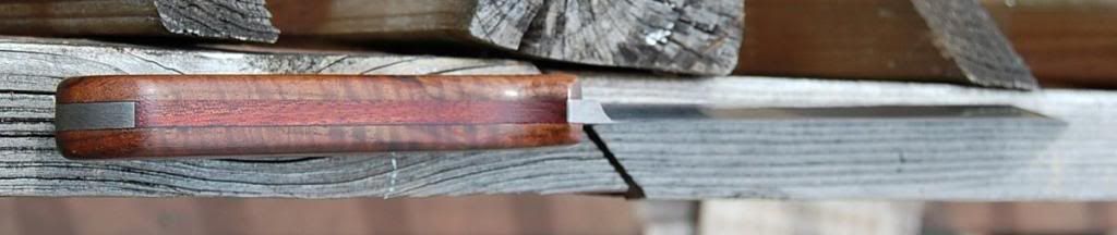

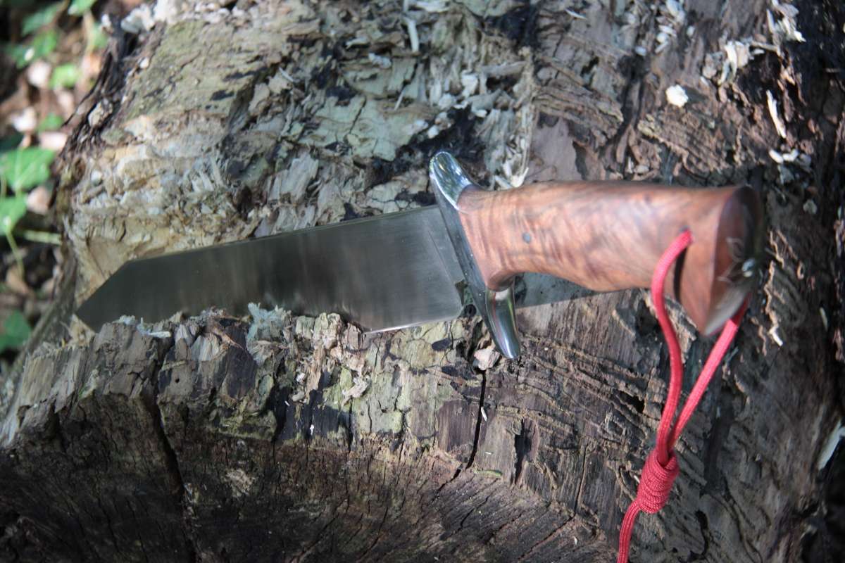

Here is one I made a little while back, its Aldo's 1075 1/4" clay quenched but didnt bother bringing out the hamon. Partial tang, my first try at this. Handle is natural claro and champher rosewood. Wedge grind. Alot of little mistakes and what not but it was a learning experience. Still got a good blade out of it. The thing slices thru smaller branches with ease.

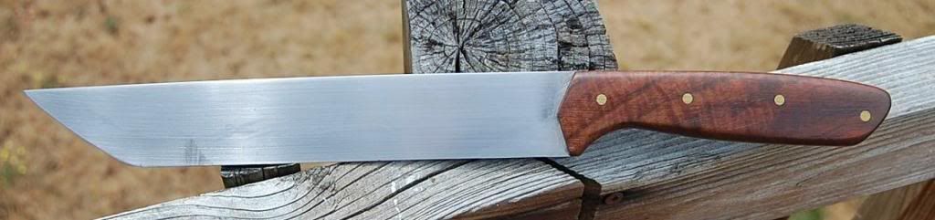

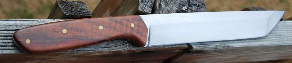

Here is one of my latest. I think it qualifies as a chopper Just not a big one
14 inch overall length
8 1/2 inch hollow ground blade with a hand-rubbed finish
False edge top grind
2 Inches tall at its largest point
ATS-34, Triple tempered to a rockwell of 59

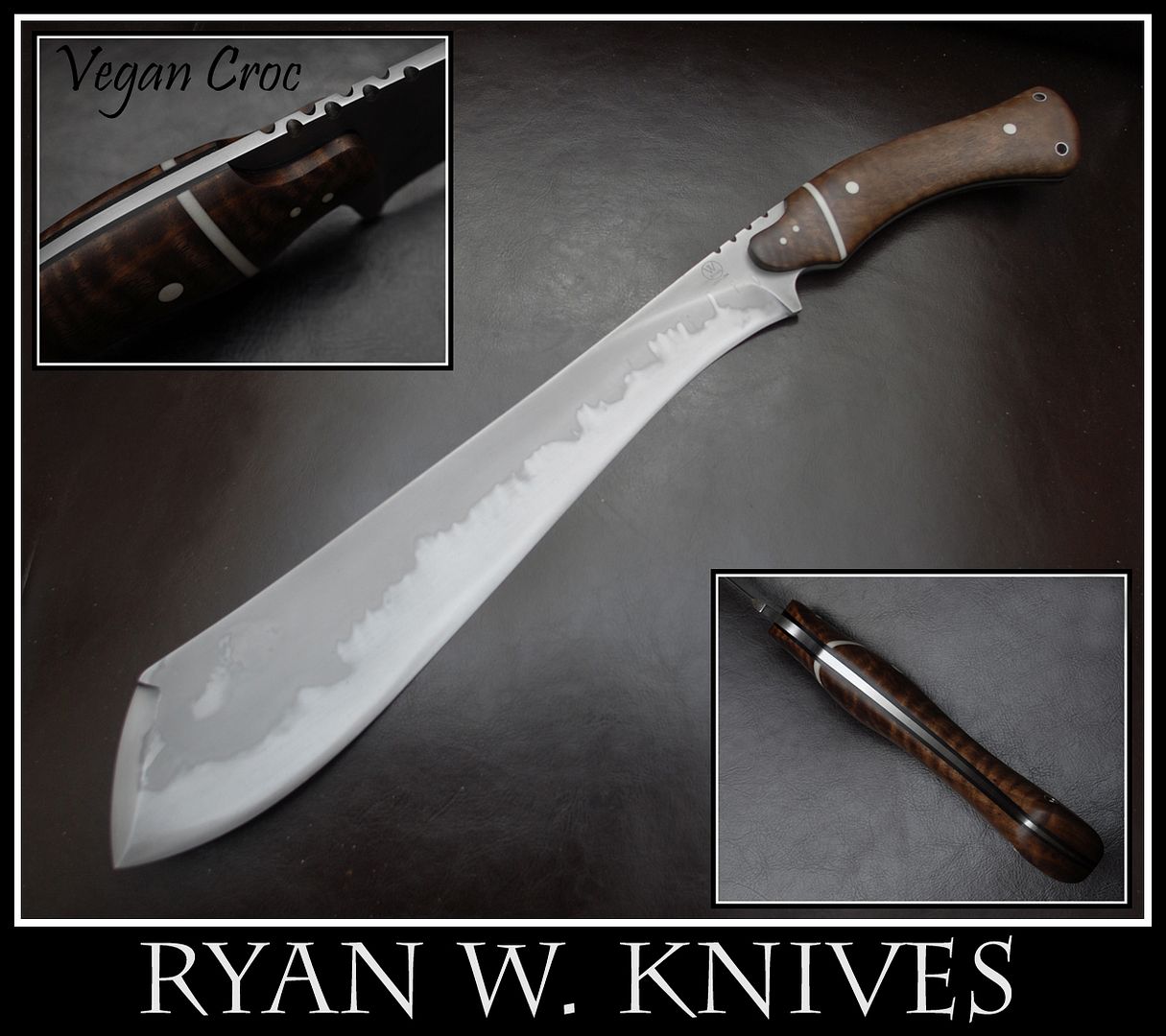

And while I am posting here are a few more of my Vegan Crocs that recently went out to customers

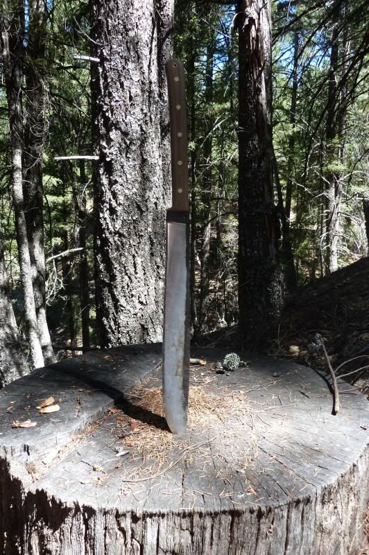

A story of sorts...

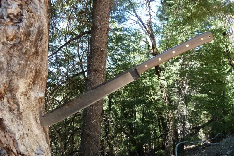

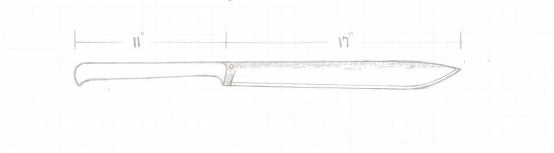

I drew this up and sent it to Joe Calton...
Which in turn became this AWESOME bit of reality (A leaf spring shaped, sharpened and handled by Joe's skilled hands)...
Then traveled here with me today...

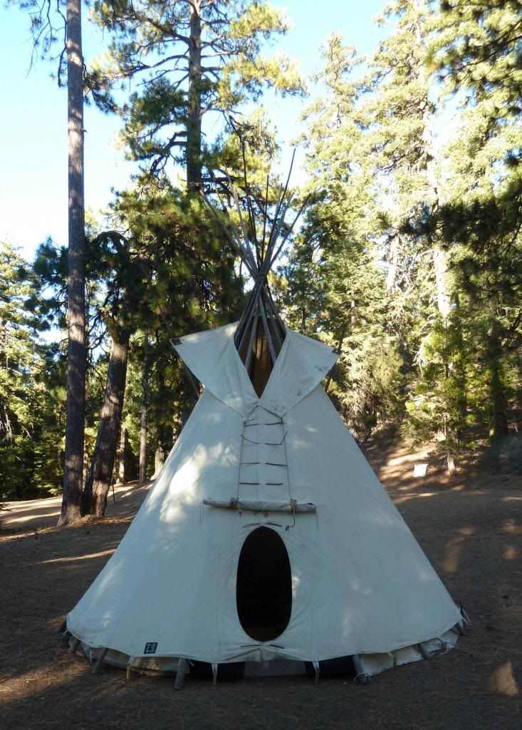

to help me collect some new structural support for this(sorry...too busy chopping, limbing and loading to take in use pics)...
A couple more pics of this ultimate shelter tool...

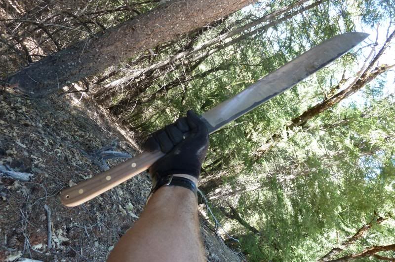

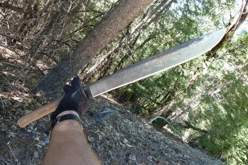

Yep, that's right, one sweep of the blade and it felled the tree where only the stump now remains!!! Okay, maybe that's a stretch, but it did perform Fantastic!!! It out-chopped my Council Tool axe, the precision of hits was Incredible and the balance is Excellent!!!! With the long handle, I can use it one handed or get some REAL momentum going with both hands. The balance is right at the maker's mark allowing the knife to feel light in hand when choked up for fine work and then just letting the blade do the work with one hand at the rear swell to easily lop off the small limbs. The final specs for this one came in as...
OAL - 28-1/2"
Blade Length - 17-1/2"
Handle Length - 11"
Thickness - .225"
Handle Material - Coyote/Earth G10
OA Weight - 2lbs.10oz.
It's an Agile and highly Nimble BEAST!!!
THANKS JOE!!! You knocked it out of the park!!!:thumbup:
