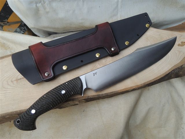

Chris- great to see you posting again man!

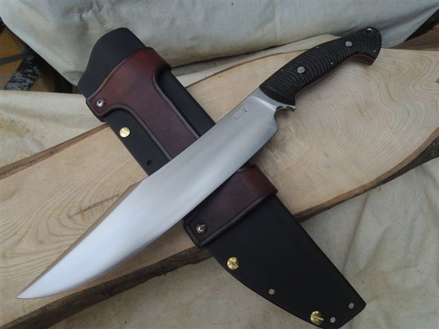

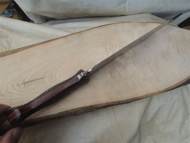

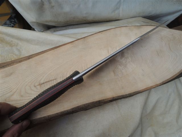

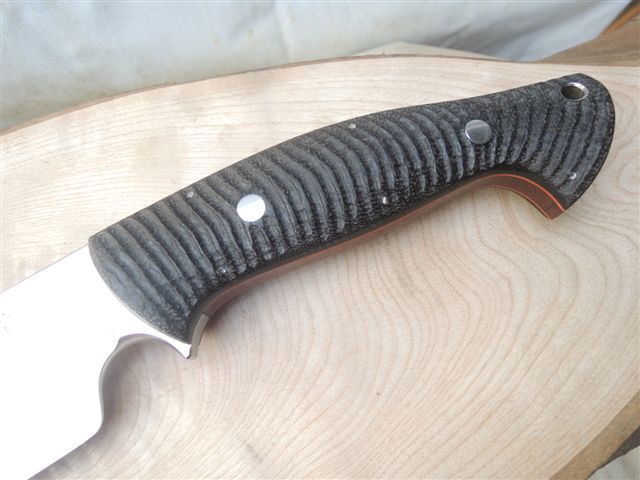

I LOVE this knife. I think the texturing looks good, but that it's in the wrong place, particularly at the butt. Instead, I'd put it on the sides of the handle where the fingertips grip the handle.
Anyway, great lines and all in the right place. I kinda want it...
Hey! Glad you caught this! I also appreciate the thoughts on the texturing. The nice thing is I can add as much as I want at any point. I even considered doing the whole handle. If you are interested, just email or pm me. I still have your cruforge steel. I am sure we could work something out.

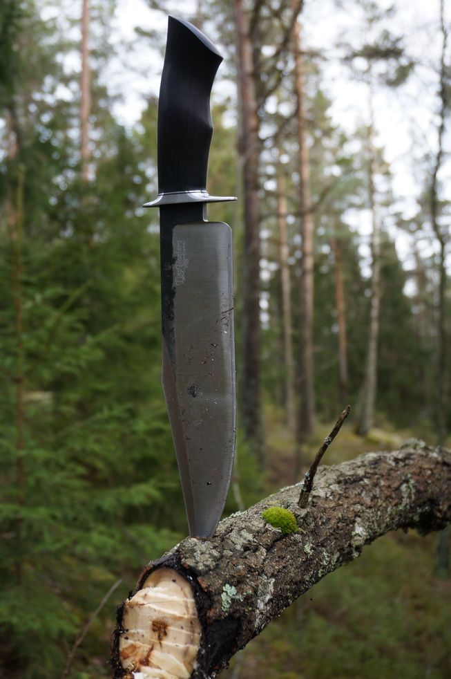

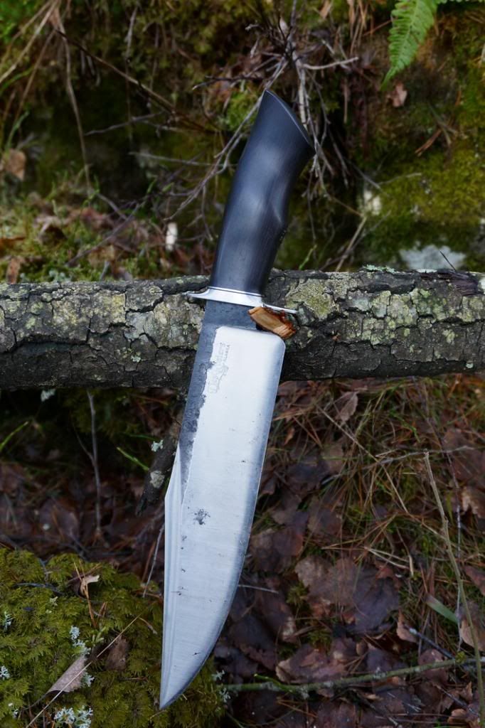

I got this from Adam today and I couldn't be more happy!!! It's a big chopper/bowie (10" blade lenght, L6 steel) but it got some serious tapering from guard to tip to balance it out.
The handle fits my hand perfectly and it feels very comfortable to hold. It's my perfect camp knife :)
The more I look at this knife, the more I love it!
This knife is closest to my dream bowie, where can I see more pictures of it?

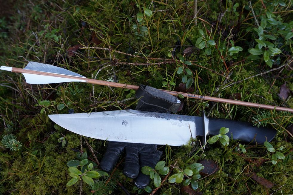

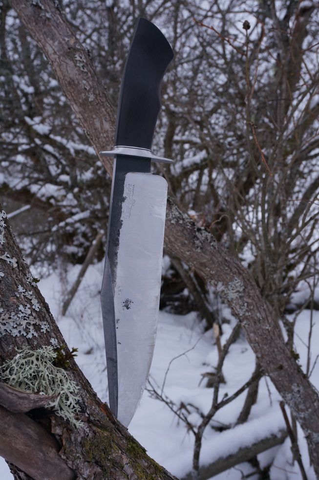

CPM-3V BOWIE made by the custom knife maker "momo" who is also the forum member.
Weight: 510g (Not including the sheath)
Hardness: HRC 59
OAL: 40.5cm
Cutting edge length: 25cm
Thickness: 7.8mm (Distal tapping to the tip)

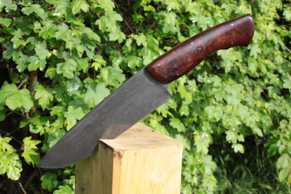

Here's one I just finished - I named it Moby Dick.
.250" W-2 stock
HT to Rc 60-61
1 lb 7.4 oz weight
16 3/4" OAL
11 1/4" Blade - 2" Wide - Vivid hamon
Flat/Hollow ground blade on 36" diameter platen
Moran edge
Premium stabilized English Walnut scales
Tapered tang with red liners
416 Stainless furniture
Squared/rounded spine
Pinned/Soldered double guard
8-10 oz leather sheath (R or L)
