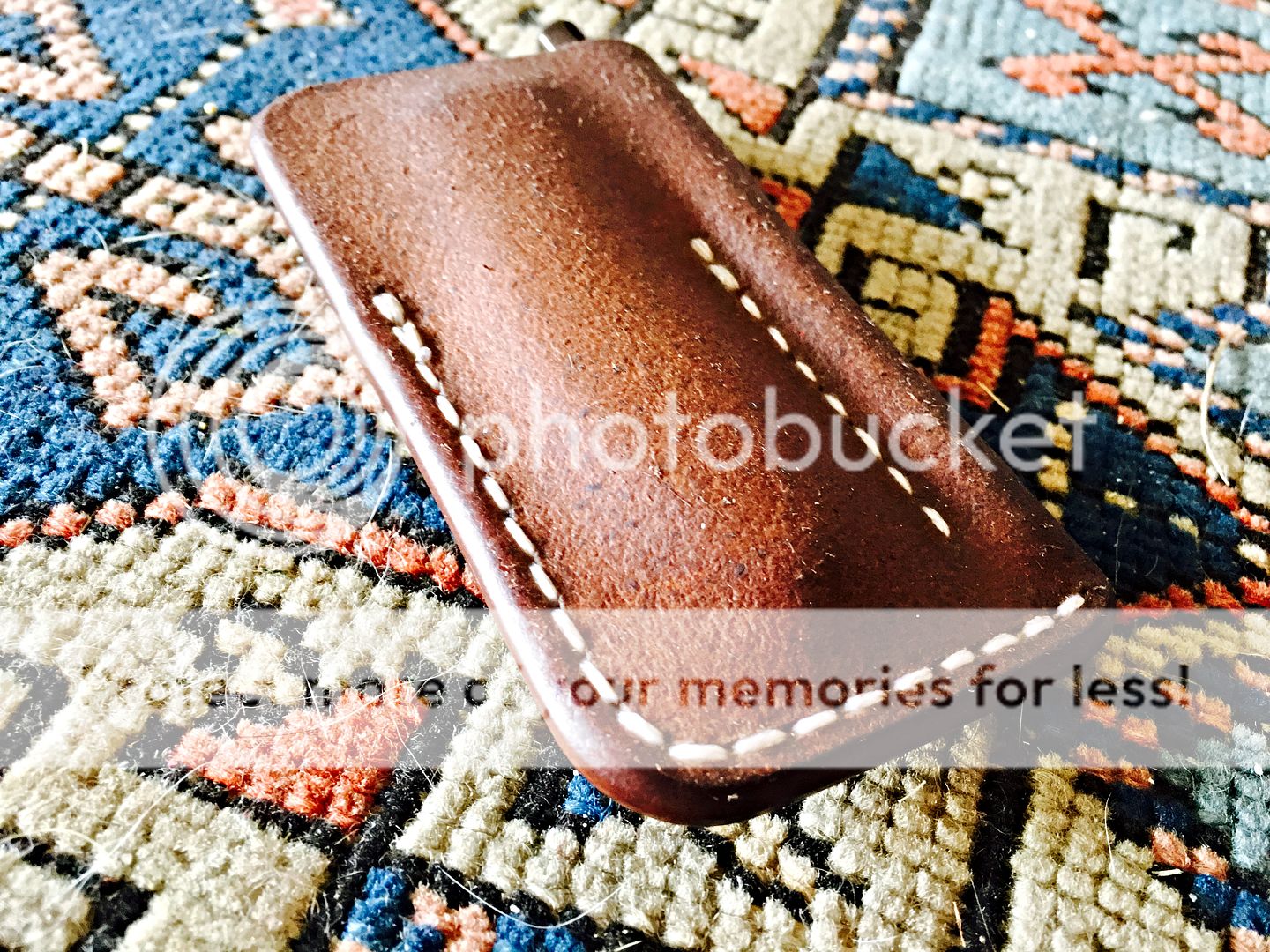

I must admit the Pauls pictures of his knife /pen combo slip got me interested and I put together a combo slip quickly to try one out .
My idea was to carry a Pencil ( remember when everyone used Pencils ) rather than a Pen .
I thought that combination would be more appropriate and symbiotic because a knife is needed to keep the pencil sharp .
I havent really got to many pics that i can show because its not a Traditional knife that lives inside it , but Im amazed at how much I have used the Pencil and this little combo has become a constant accessory in my daily world
Ken

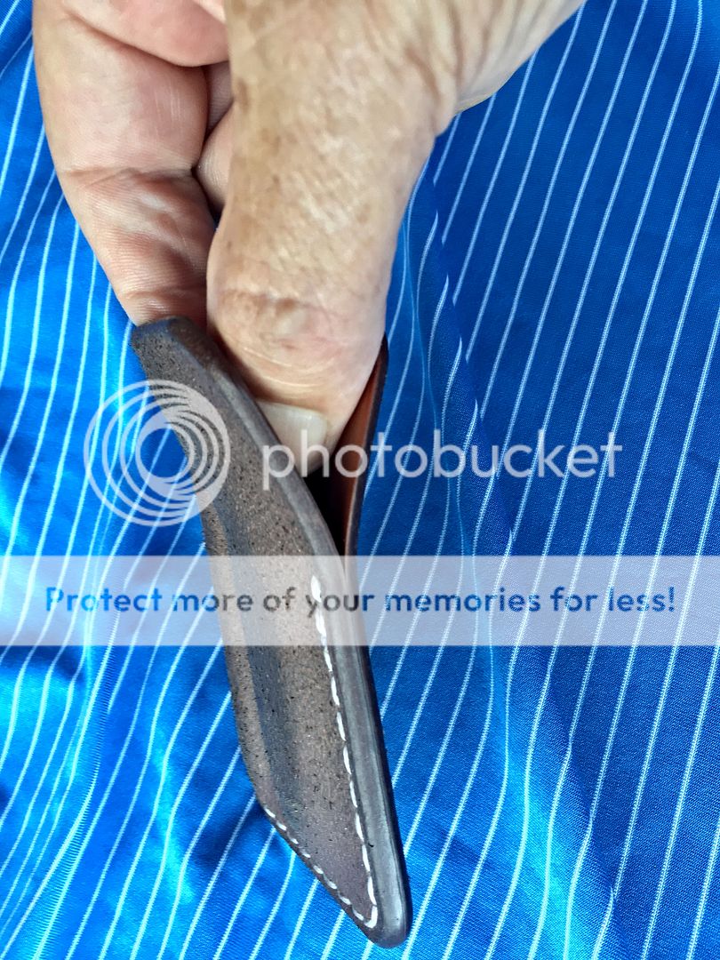

That is a nice looking slip ken . Looks well made to me . Do you have to kind of Pinch it together to get the knife to slip out ?? if so ,then does the pencil pocket then collapse when the pencil is not in it ??? Do you have a sewing machine or sew it by hand ?? I have never been able to sew that straight. I agree with your design philosophy too . Less is sometimes more.

The leather I made this from is quite thick and I purposely did that so the slip will retain shape and form even when the Knife and Pencil are not in it .
The leather has and will continue to mold itself to the shape of the knife and that adds to the retention .
To extract the knife I manually pull it out rather than shake it .
The stitch lines purposely only go just over half way up the slip so that the top / flaps can be spread apart .
Once you have access to the knife you just pinch the end of it and extract it
This slip was made Roughout ( the Rough side of the leather faces outwards ) for a reason .
When you make something Roughout you get an instant lined slip or sheath ( see the first pic above - the smooth less abrasive side of the leather is now in contact with the knife ) , many top custom sheathmakers line their sheaths or pouches for that reason .
Also the Rough outer is very wear resistant and has the added benefit of being more " Grippy "in the pocket , it wont slip out as easily . As you can see from the recent pics the slip is already taking on a much used look , but I have given it a very hard time in its short life .
Hand sewing is like everything , the more you do the better you get :)
Thanks for the kind words about my hobby
Ken
