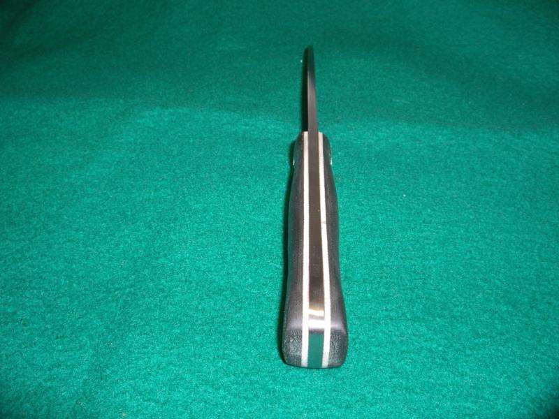

I realize I'm a bit late here, but just got around to it. Certainly worth of posting it regardless of timing.
This was made By Fod, 3/16 01, about 5 inches, Canvas micarta, and burlap micarta hidden tang. great woods bumming knife. The sheath is basalt fiber, with a Kevlar sleeve.
